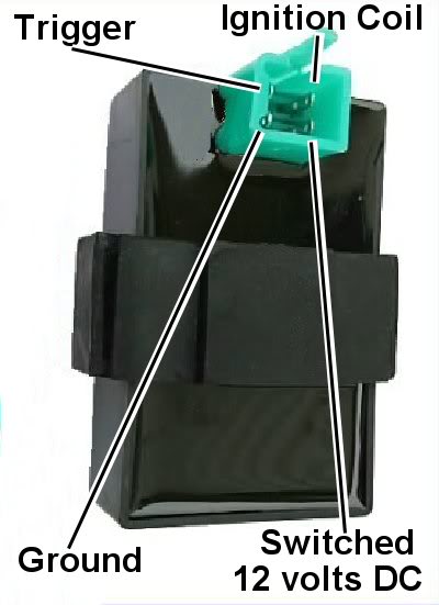

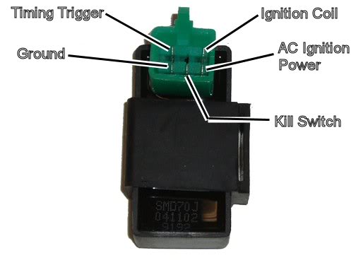

Originally Posted by LynnEdwards
Three common CDI's in no particular order:
Attachment 19143
Attachment 19144
Attachment 19145
Can you find any of these on you quad?
The main fuse is *always* real close to the battery plus terminal, or off the big fat red wire at the starter solenoid (follow the fat red wire from the battery plus terminal). But if your starter turns with the start button then your fuse is fine.
