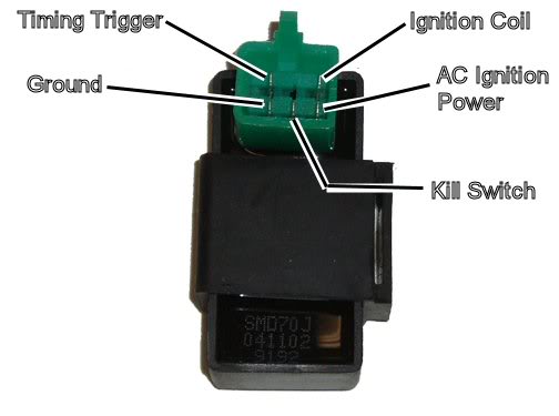

Does you CDI look like this?
If so, the way the quad is shut off is to ground the kill switch pin. There are up to four kill switches on the quad:
1) The left handle bar kill switch
2) One pole of the two pole ignition switch
3) The remote control module
4) A tether pull cord kill switch
All the kill switches are wired in parallel - that means that any one of them could short the kill switch wire to ground and kill the engine.
So you could have a missing ground (as 95wolv already said), but this missing ground would have to be missing to just *some* of the circuitry since the quad starts and runs. For example the CDI must be getting a ground or it wouldn't run at all. So along this train of thought do you notice anything else that doesn't work? Headlights, battery charging circuitry, etc? If yes then missing grounds is a likely possibility.
Another likely possibility is the kill switch wire to the CDI itself. All of the other kill switches wire to that very point. If you have a bad connection or a broken wire here you will get exactly the syptoms you described - i.e. none of the kill switches work. Look very carefully at the kill switch pin at the CDI. Wiggle the wire. Does the connector pin seem like it isn't grabbing the mating pin on the CDI?
Try grounding this wire with an alligator jumper wire from engine ground to/through a small screwdriver shank probing into the CDI connector kill switch pin. Does shorting that pin to ground kill the engine?
Be Careful...
The kill switch pin could have high voltage on it whenever the engine is turning. Whenever you probe this wire make sure your fingers are not part of the circuit. It can knock you on your butt, so make sure you are only holding the insulated screwdriver handle when doing this...
