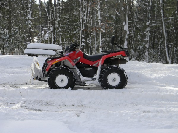

I've been plowing snow (and loam / dirt) with my atv's for 5-6 years now- from 6" to 2'+ deep. I have a 75' x 30' drive way.
I had a 60" plow for my xp850- it would do pretty well until it was plowing too much- then the tires would slip (with very aggressive snow / mud tires & chains- and you're talking 1000 lbs combined weight with rider / plow & atv!
Chinese atv's can hardly handle the moderate stress of being ridden twice a month on a trail, never mind the force of hitting the snow with a 75lb (small) blade!
also, it's not just about pushing the fresh snow a distance, you also have to have enough grunt to push it up over the top or the berm or through the snow pile, or all you're going to accomplish is creating a big wide pile of snow.
You may be able to get away with plowing a little snow with a 250- but it's going to beat the snot out of your atv and you.
