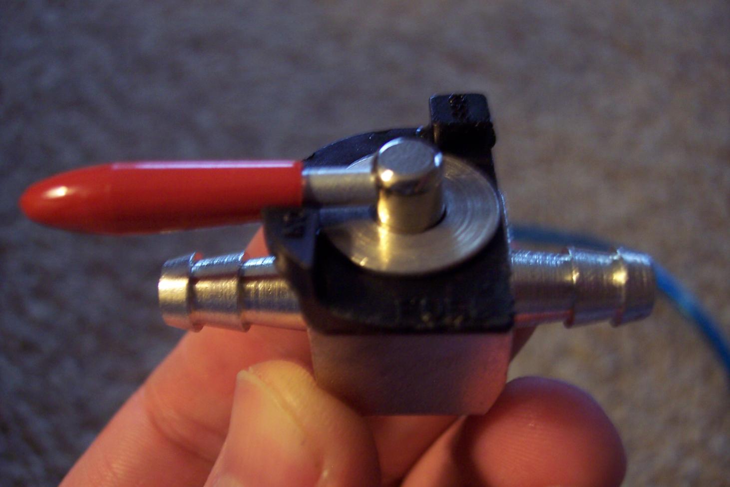

if your quad did not have a factory petcock installed, go buy an aftermarket one at O'Reilly's, AZ, or any parts store you use and spud that sucker in between your feed hoses. it ain't hard. remember, if it is chugging gasoline into the crankcase while trailering it and no petcock valve to isolate the tank from the carb and it's a 4 stroke, change the oil before you wash out your bearings or get an explosive mixture that'll launch you off the quad and burn down. 2 strokes are built for that, not 4 strokes.

Something like this will work. I got this one at Dennis Kirk, but most cycle shops should have something similar.
Attached Thumbnails Kazuma won't start after being trailered-inline-valve.jpg
