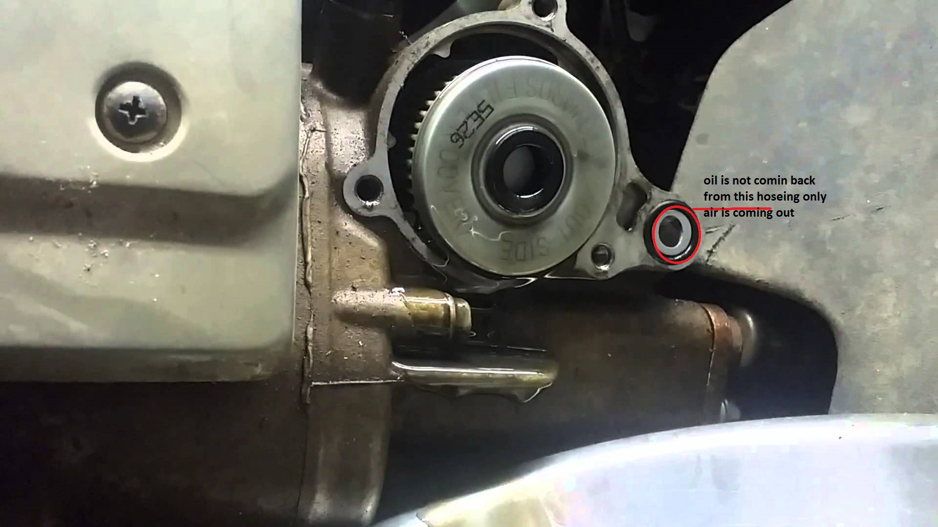

ok oil pumping out to radiator and coming with good pressure out of radiator and go to engine . but unfortunatelydoesn't come bake to filter so I did crank engine again today and just air ispumping out to filter hosing I put some oil by the hand in the that filter hoseand crankbut was pump out so slow so isonly air is coming out no oil at all . any id what is wrong ? if you can help is muchappreciated

oil not coming out of this hosing to filter only air is pumping out

According to your previous drawing, oil comes in through the outside of filter, then out of filter centre into the cover plate, and back through that hole you have marked in red to go to the crankshaft etc, so oil should be coming up into filter housing from sump, not through that hole.

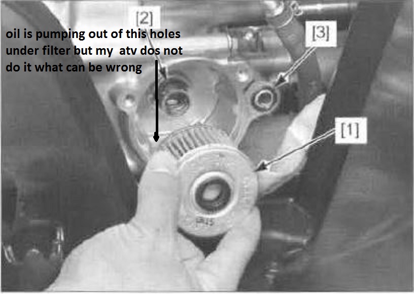

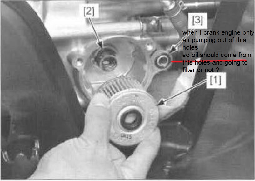

yes in the picture I try to explainhow the oil pumping { going out } from engine out to radiator also coming outof radiator with good pressure and going back to engine . but from return theoil to filter I don’t see any oil coming to filter or filter hosing only air pumping out fromthat hols I mark red . so if oil should come out from different hose oranything ells I don’t know if you can show me I send you oil filter hosing tosee it

ok I find out which holes oil is coming out . reason I find becauseI have other atv exactly same model so Idid open filter and crank motor and see the oil is coming from inside holes under filter .but now oil is pumping good in and out of radiator but from inside of enginenot going to filter . so what can be wrong

Either the oil pump isn't pumping enough oil, or the pressure relief valve is stuck open. Or one of those oil pipes in the clutch housing is loose or leaking. I don't know where the pressure relief valve is, but the clutch cover will need to come off to check all of the above faults, the book should tell you.
