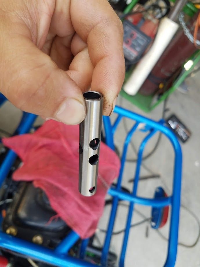

I was trying to find an oil filter screen on a chinese 110cc that I believe to be an e22 clone. I pulled the angled bolt and the cam tensioner rod and spring fell out but it didn't have a black plastic cap at one end.
Two questions - The steel rod has a ball check valve in one end. I know it goes bolt -> washer -> spring -> push rod. Does the tapered end of the spring go into the ball end or opposite the ball end of the push rod?
When the push rod fell out there was no black plastic cap like I'm seeing online. Do I have to go fishing in the engine to find it or are there some models without the plastic cap?

What is the other end of the pushrod like. The ball will be a one way valve, theory being oil gets past it, then when engine is running the pushrod cant be pushed back by the chain as the valve closes and the oil below it hydraulically locks. I am fairly sure the spring will go into the hollow end, otherwise no point in being tapered.

The rod is hollow except for the ball valve. The valve allows flow from the long end with the through-holes. It does not allow flow from the end previously pictured, the end closest to the valve. I do agree that the spring goes into the end without the valve. The tapered spring will fit into the ball end fine but it appears that it would contact the valve slightly and I don't see any wear marks.
I'd love to put the engine back together but I'm unsure if I'm missing that black cap. I'd hate to have to open up the engine for something so trivial. Thoughts?
This is all that fell out other than the spring -
missing black cap

One end of the pushrod should be blocked by a cap as it pushes against the chain tensioner, that is why I asked for a pic of the other end, and I'm fairly sure, will go the other way up as oil should get past into the area with spring, then not be able to get out, so the pushrod can't be pushed back down again. I suppose it is possible the Chinese maker deleted the plug and just had the end of the tube pushing the tensioner, but I'm sure there would then be wear marks on the tube end.
