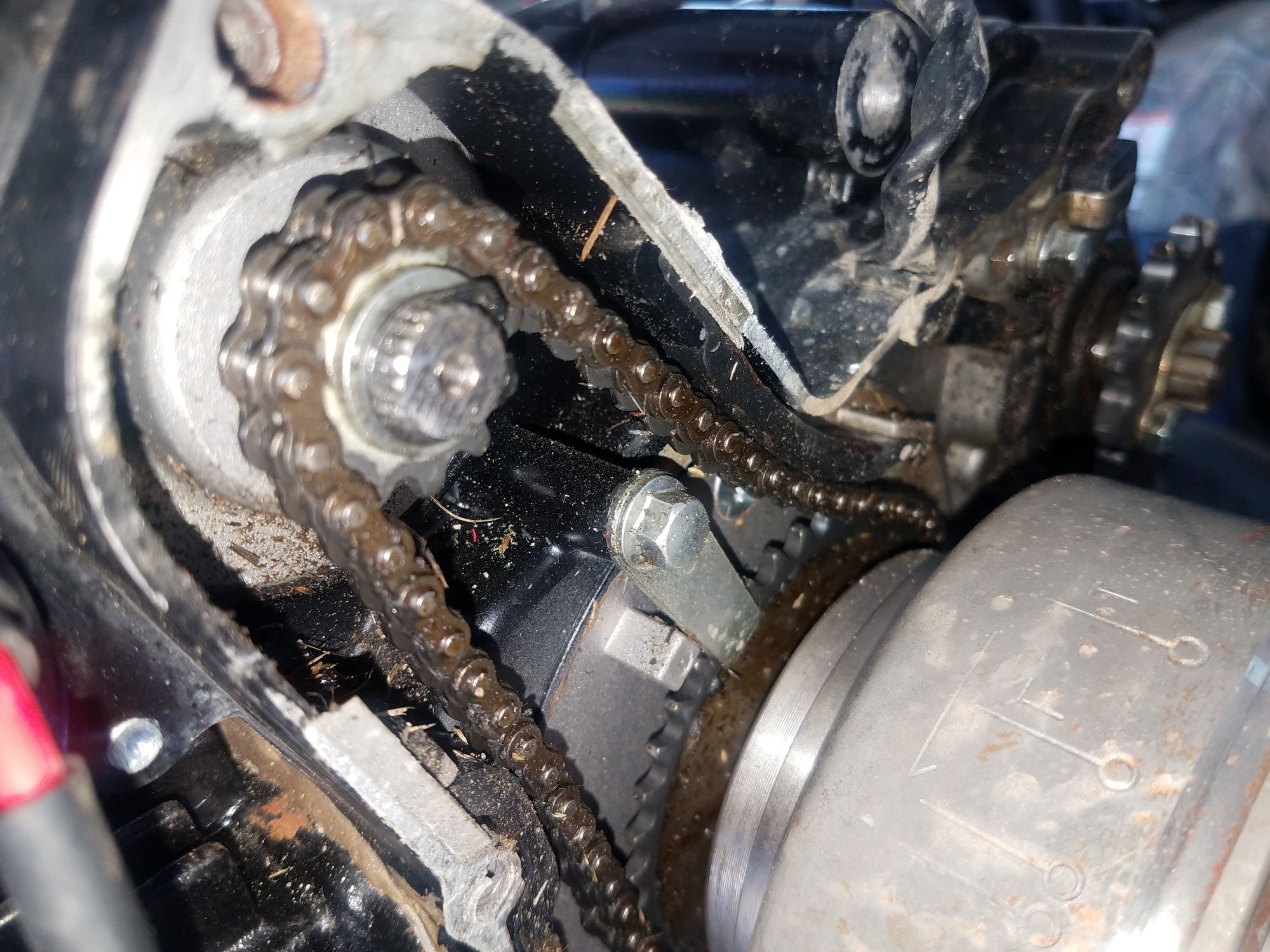

Well I started pulling the engine apart but an emergency errand came up so I wasnt able to finish anything. I did learn that trash has been getting into stator area..
Old Sep 7, 2019 | 01:27 AM
Posts: 7,487
Likes: 387
Stators that don't run in oil always seem to get dust and chaff in the cases, looks like you will have to add gaskets to the list of parts to get. I had completely forgotten, but that is a round door in the case behind the flywheel, you may only need to remove that to get the loose tensioner cap out.

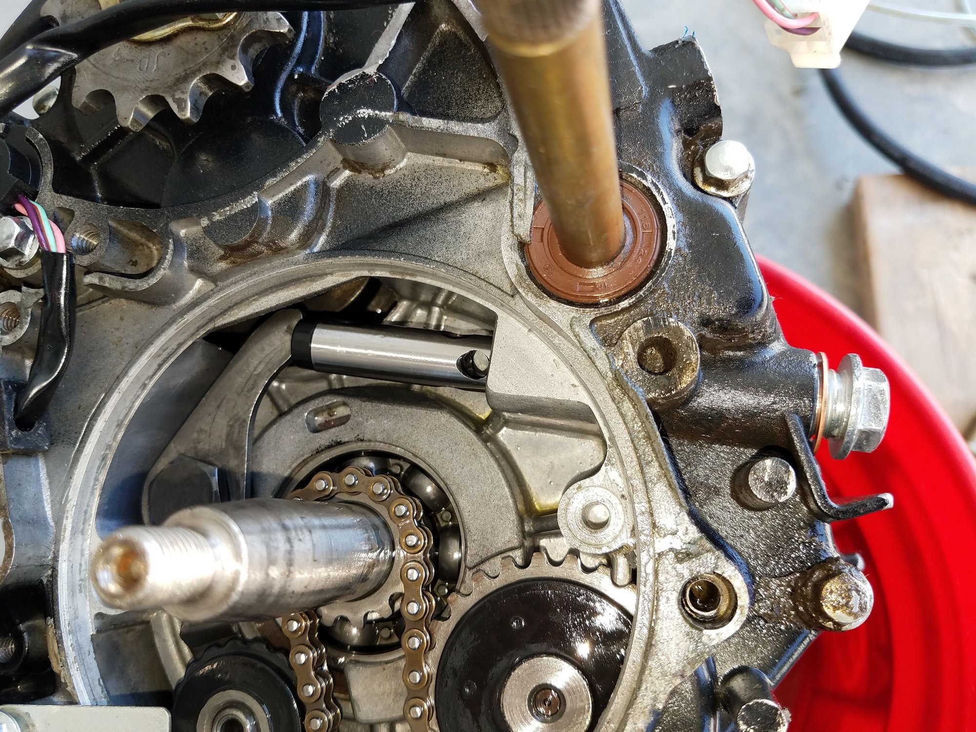

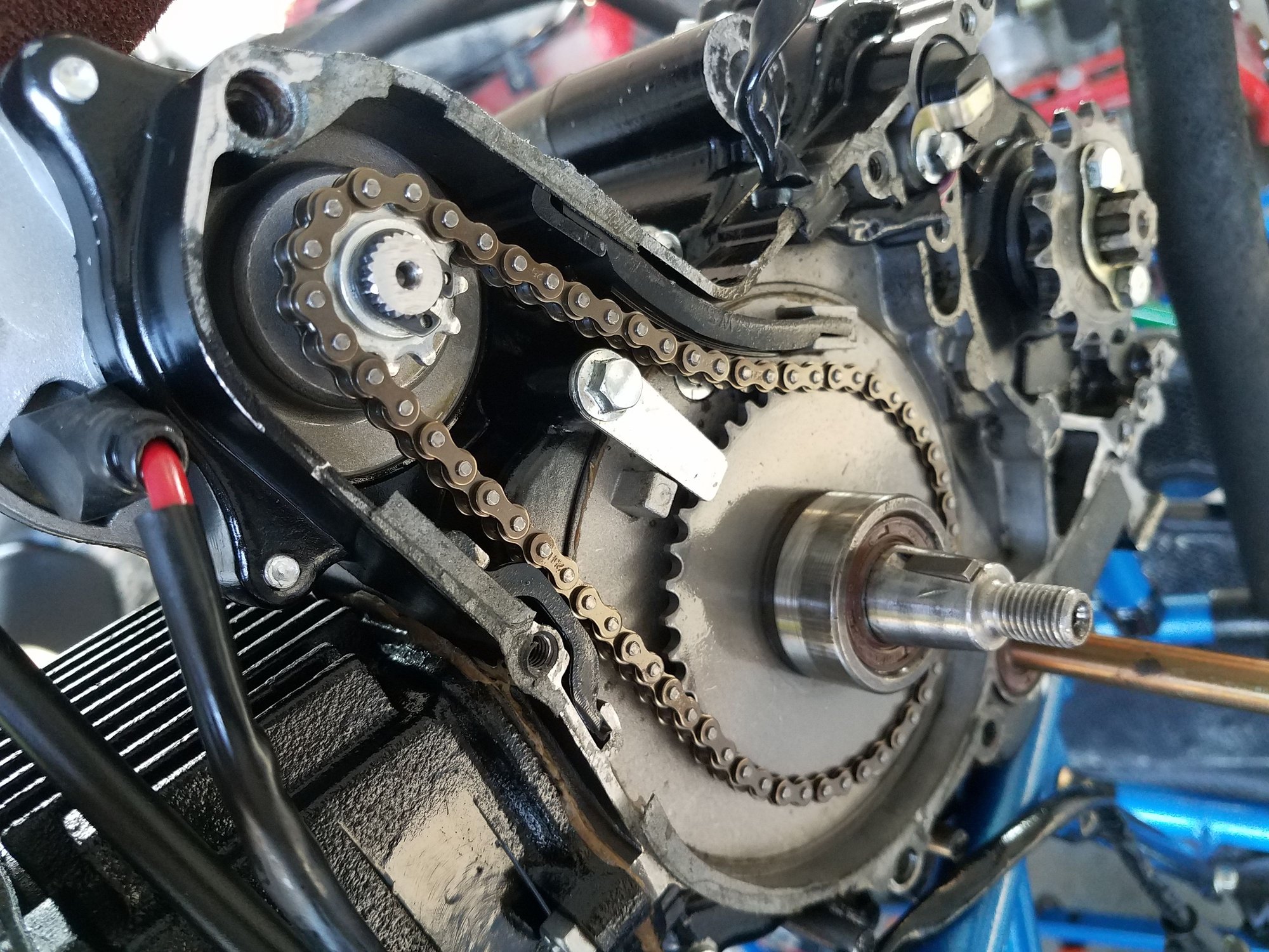

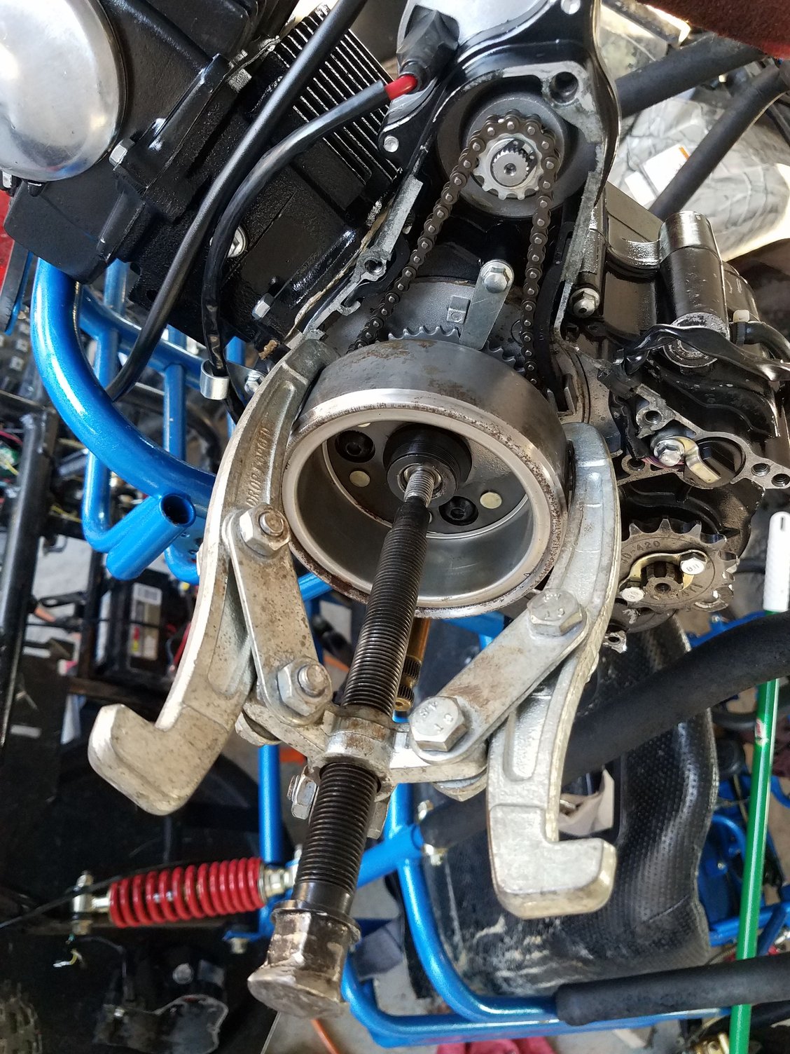

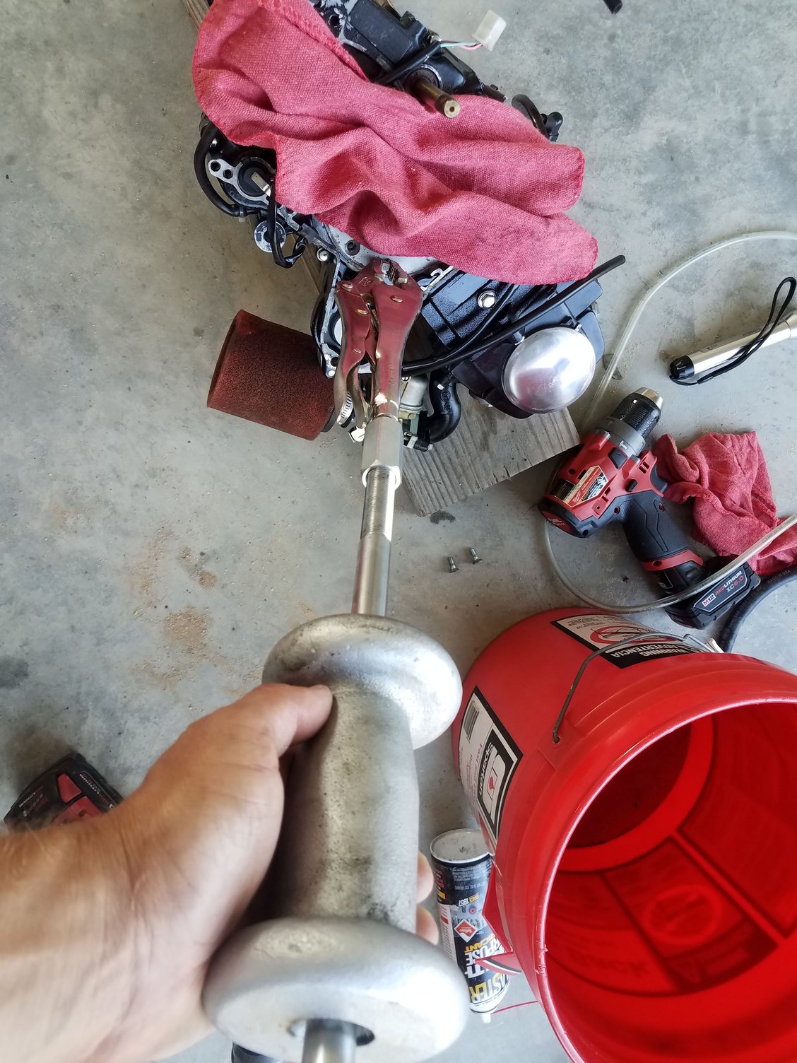

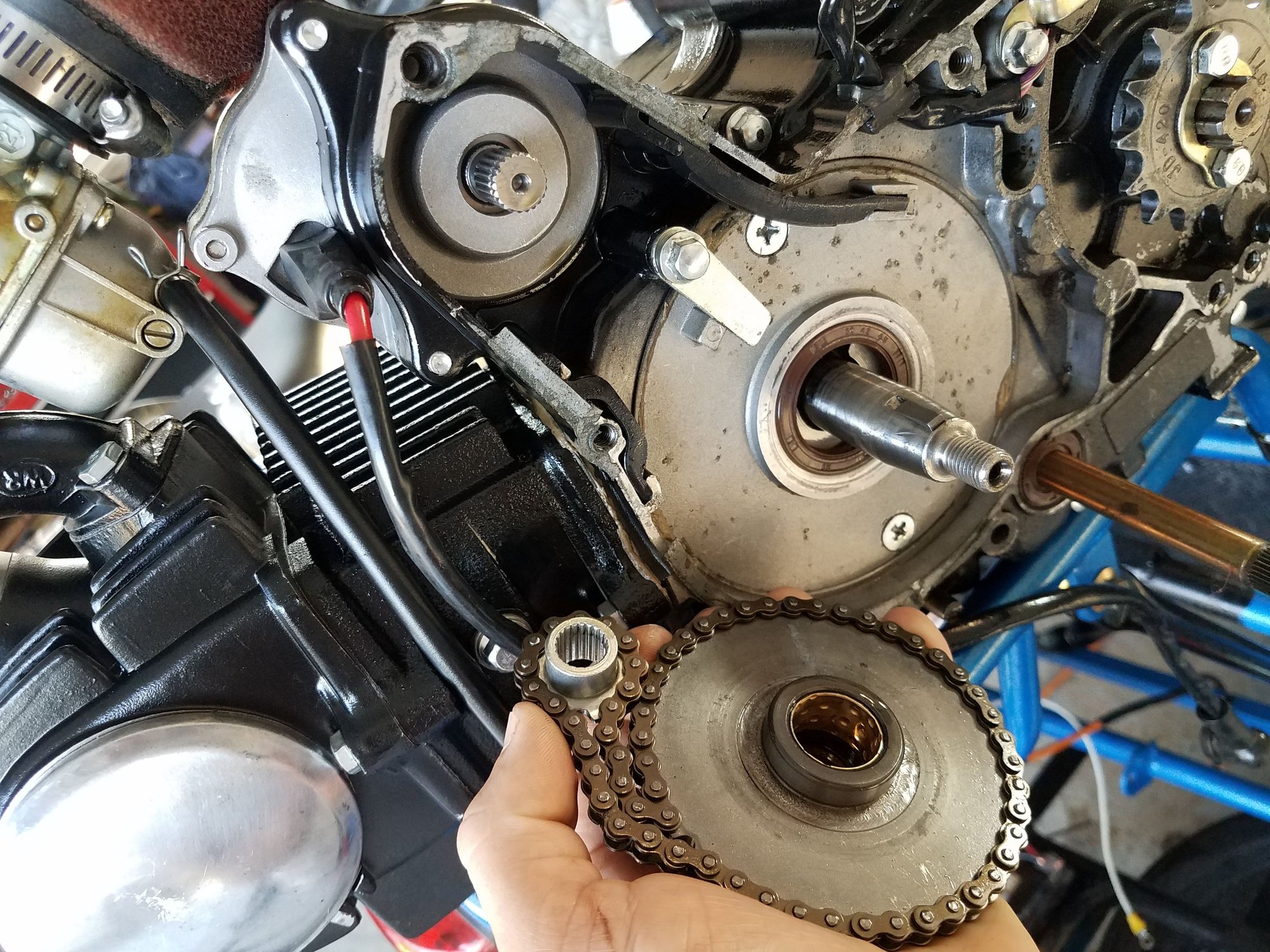

Started pulling it apart this morning..
I have a puller for a GY6 but had to use the generic puller on this one. Of course it popped loose when I wasn't expecting and the starter clutch parts went everywhere.
That left this:
If anyone reading this doesn't have an impact screwdriver, they should order one now.
The plate had some sort of glue on it, I was worried I wouldn't be able to get it loose but the slide hammer got it off beautifully.
That was all the access I needed to get the cap out.
Reinstalled tensioner -

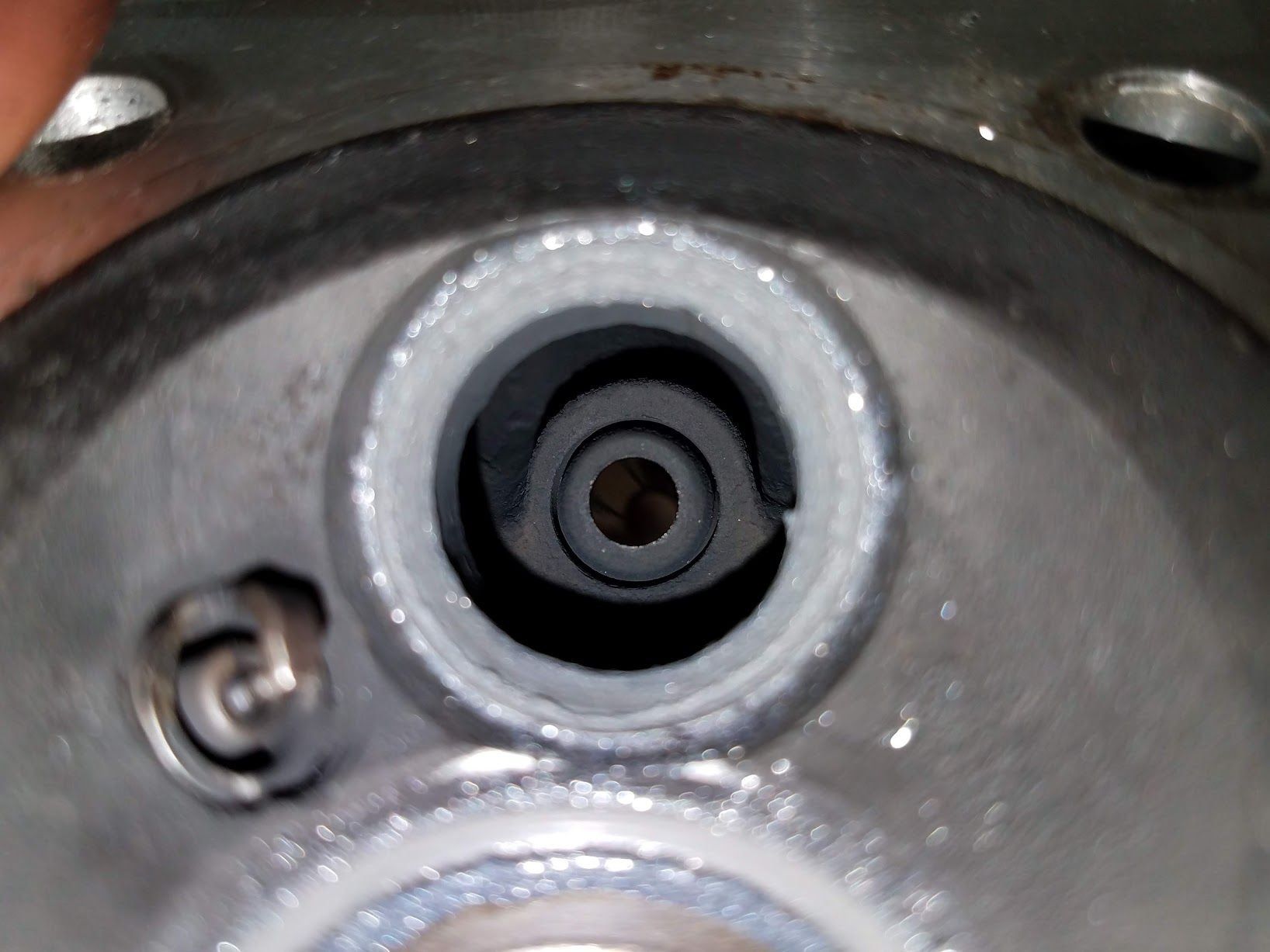

The cylinder walls look great but I obviously couldn't check the rings without properly pulling the sleeve. I messed with the cylinder head a little earlier, a buddy told me to try using gasoline to see if it seeps past the valves. The exhaust valve held the gasoline back for over an hour without any sign of seepage. The intake valve wasn't pouring gasoline through but was definitely leaking. In 30 seconds you could see the area around the edge starting to darken, in a minute it was fairly saturated. The picture was maybe 1-2 minutes after I blew it dry.
I doubt this is why the compression is so low but I'd like to correct it while it is apart. I'm going to check the valve stems later on and attempt to lap the intake valve to see if I can get it to seal off better. May just be carbon buildup. I'm sure the cheap chinese springs aren't helping either.
Intake Valve Seep

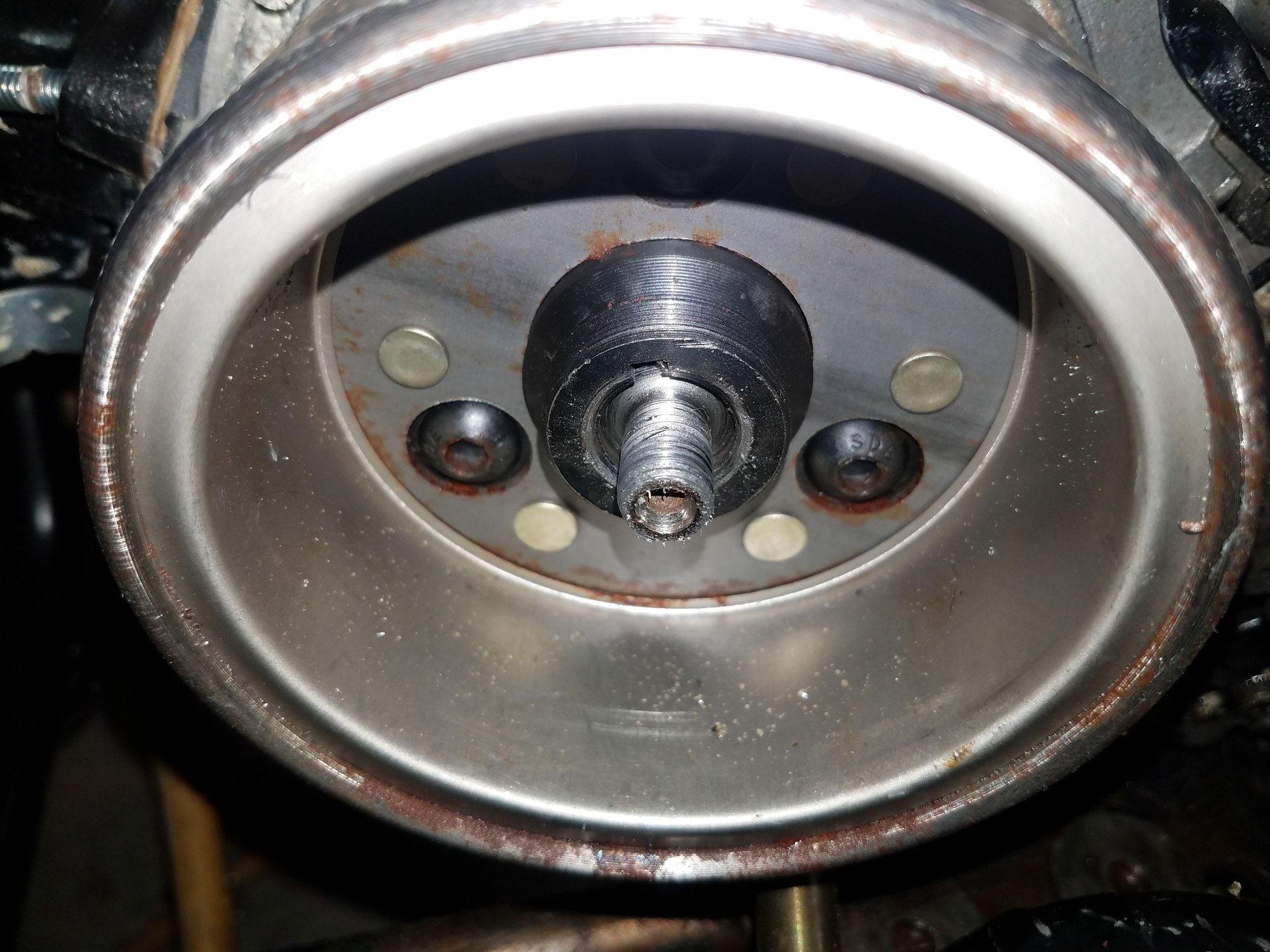

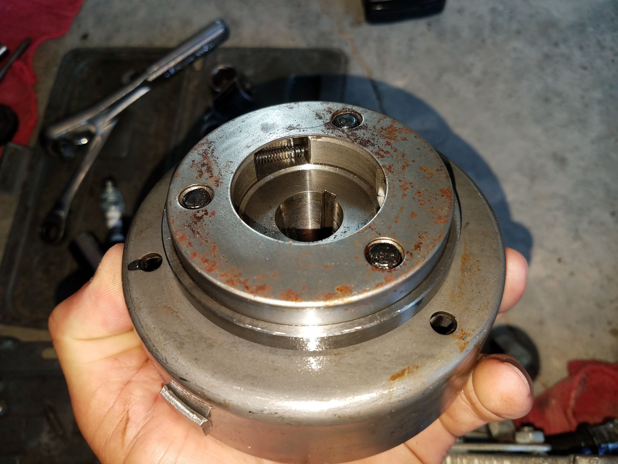

I almost have the engine back together. I need to torque the cylinder head, reinstall cam sprocket, and reinstall the flywheel. The flywheel wasn't slipping on the crank but I'm not sure that it was seated fully.
Crank seat
does that look right?
