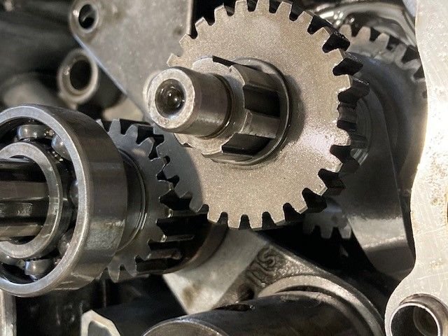

Well I finally got into this. Removed the top end, clutch and shifter, got the inner case open and found a busted off tooth and a flat spot on the other gear. I have no idea what any of this stuff is really called but I have new parts on order from VMC. Does anyone know how to remove the entire gearing assembly? There are 2 shafts and one thing that looks like it engages forward or reverse. I can pull out the shaft with the flat gear but the other seems locked in along with whatever that engaging part is called. It looks like I can pop off the snap ring and replace that one gear but the part I bought is a whole spline/gear set up. I would prefer to swap out the whole assembly if possible, and it seems like it moves up and down, but I just cant get it to pull all the way out. Anyone have any ideas???
For anyone that is wondering, the missing tooth gave the shafts enough slop to pitch the gears tooth tip to tooth tip which locked up the wheels. Once enough pressure was put on the tires it would power over that bad engagement but eventually I can see this ruining god only knows what. Why it happened? I believe I let someone that was unfamiliar with the quad ride it, they revved hard to peel out, wasn't in gear, slammed it in gear, bam... I have had many other atvs and have never encountered this issue before. As far as the chain getting locked up, that was likely not the issue I feel, I only noticed it after that so who knows how long it was doing that when the rider was on it as they were a novice and I was on my own machine not paying attention to what they were doing.

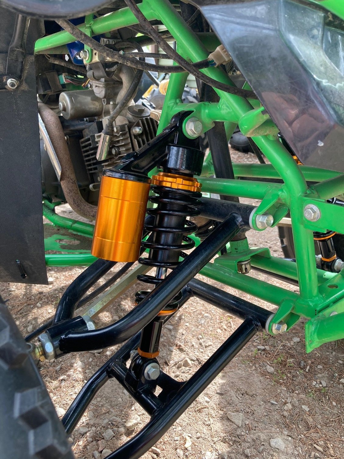

Well I got it back together, new gaskets and oil and all is well. Carb is now popping so I have a new carb on order. The factory ones on a lot of these are not adjustable and new ones are $16 so I will now have these on all three of the kids quads. Picked up some cheap air shocks as well, night and day difference in suspension. Going to run them for a few weeks and if decent enough, get some more for the others. Looking into a rear shock as well...
