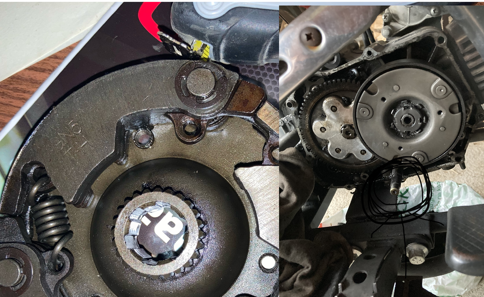

I recently bought a Chinese ATV Zhejiang model YL802, 125 cc.
The clutch is said to be defective.
When I removed the clutch cover, I found that the previous owner most likely installed the wrong clutch.
How do I figure out which clutch is right for my ATV.
The ATV has reverse gear.
thanks for the help

Not familiar with that engine at all, but why do you think it is wrong? The shoes in the centrifugal have no linings left which indicates they have been in there a long time and would be the reason you have no drive.
