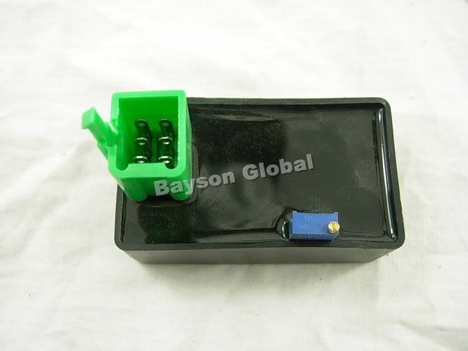

thanks for your reply,hoped you would reply as found a lot of your info in other posts helpful over the weekend, this is the same as my original cdi,
the red/black wire from stator was just taped up in the loom we believe, and cdi just had a 12v power when ignition on, so thought the new cdi might be ac and old one dc is that an issue?
new cdi has same plug as this
[picture snipped]
[This is the first time I have seen a four pin DC powered CDI on a 150cc quad. Normally these have the 6 pin CDI (2 connectors - 2 pin and 4 pin)]
[picture snipped]
[I've not seen a CDI with this connector at all. It is entirely possible that the new CDI is AC powered. Where did you get this CDI? Is there any link you can provide so I can take a look? Was this CDI specified for 150cc quads?]

[picture snipped]
[picture snipped]
