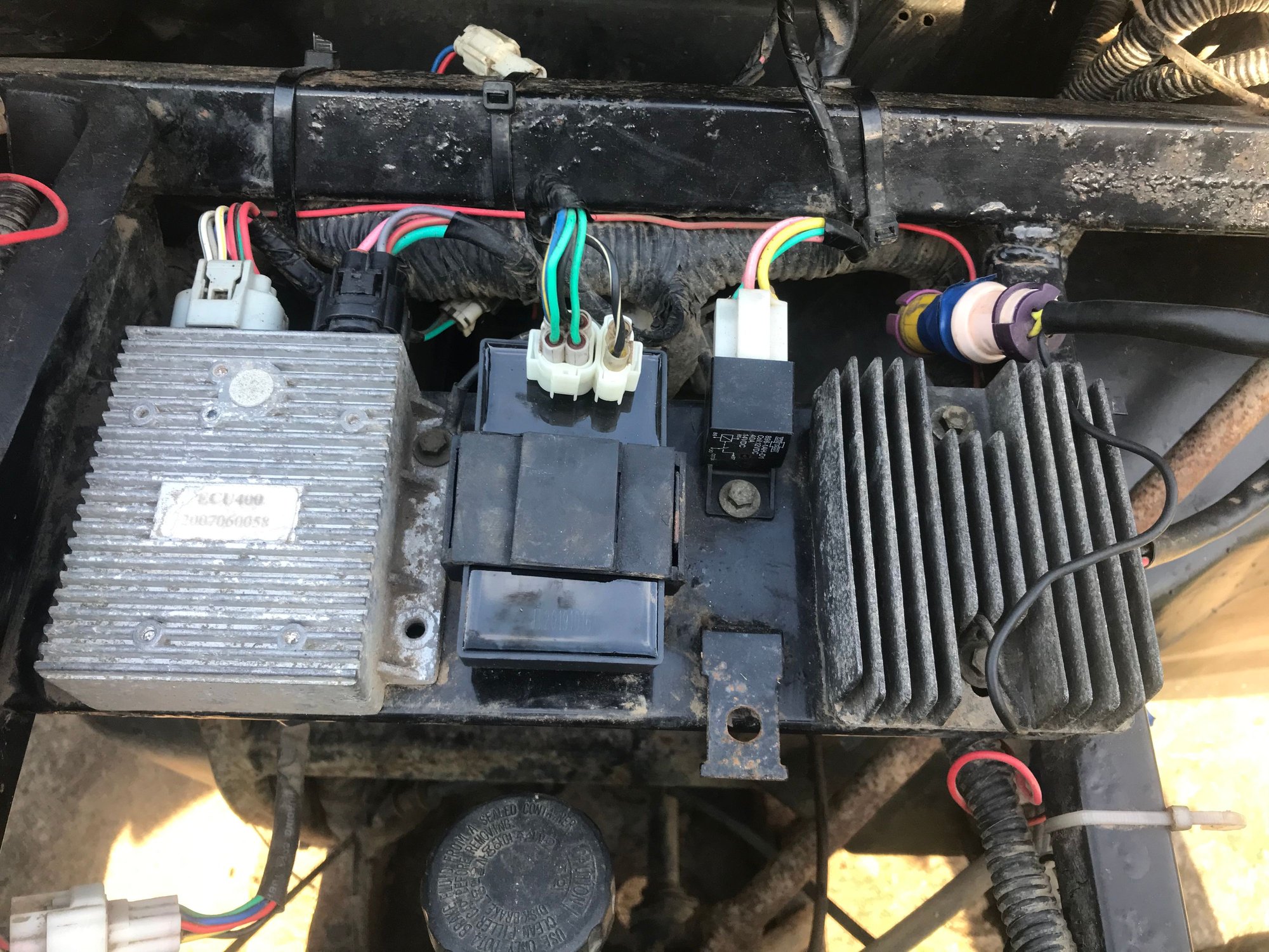

Hi Gerry,
Im after some parts and info.. Ive got the engine running now.... It had a wire off the Stator see attached pic, to be more specific it had a electric connector elbow and that was broken in the rubber and you couldn't
ECU 400
Suspension
3 control modules
Stator wire off
Stator wire on :-)
see it.. Once I fixed that it starts like a treat now.. However the gear changer on the steering wheel doesn't work. Question does the ECU 400 see attached pic control the gear changes, and if so would the machine not run at all if it was faulty.. There are 3 Modules the CDI (Replaced) the ECU and another module see pic.. Have you got these modules in stock and also do you have the mini suspension connectors.
Any help would be greatly appreciated. Im not sure how I contact you, I sent my email address but I never heard back so im assuming you never got it? (cwalsh607 @ yahoo . com .au) Im from Victoria, Australia
Let me know how you get on talk soon
cheers
Craig
Old May 23, 2021 | 12:45 AM
  #29
Craig Walsh's Avatar
Joined: Apr 2021
Posts: 5
Ah ive discovered that I need the electric shift module (possibly) I would assume the motor part of the system are pretty tough.. Will wait to hear from you Gerry

Hello Craig
yes i have extra part . and happy to help you .but where you are located ?
