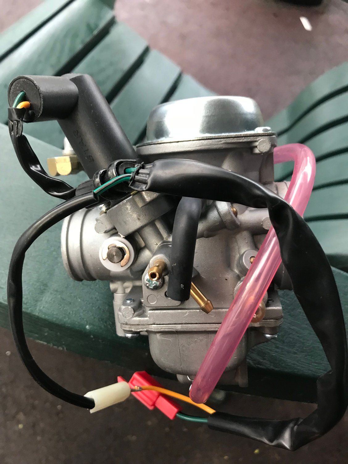

new carb just came in but this has a black plug coming out of it This is old carb without black plug
What is black plug for??
Old Oct 25, 2017 | 03:28 AM
Posts: 7,510
Likes: 390
Electric choke, someone has removed it from the old carb and blanked the hole off. It will have to be wired in, as the choke lets in excess fuel until the engine has run for a while and, if it isn't wired in, it doesn't get power from the alternator and will not shut the excess fuel off.
