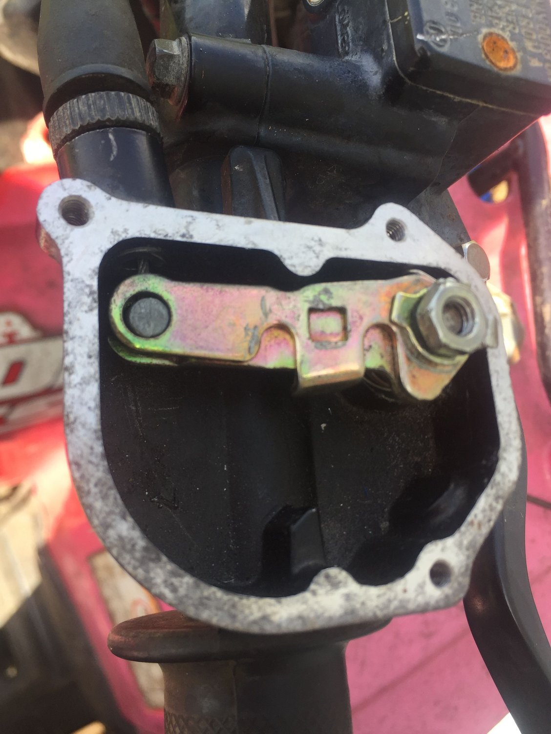

i need help figuring out how the thumb throttle needs to be screwed in inside the box where the throttle cable is. I can’t figure out how the spring is suppose to sit in there, is there a name for this compartment? Can some link a video or something I’d really appreciate it
if you don’t know what I’m talking about here’s a pic

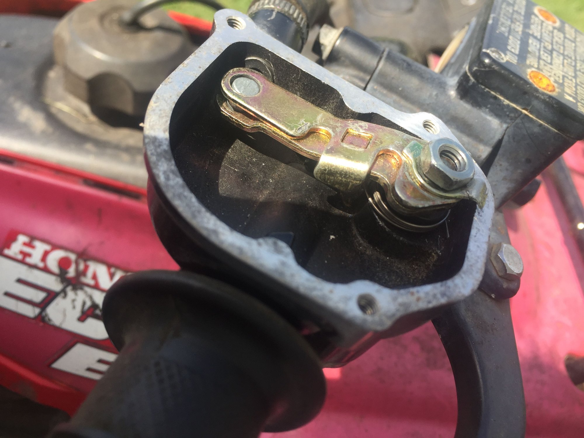

It’s 03 250 recon

I have done this, but one tends not to remember how. Take a look at the modified picture. Spring end A hooks round into cutout B, then shove the arm down, however spring loop C tends to jump off the casting and get trapped under the arm, so make sure it isn't before tightening the nut. If it is, wiggle it back round the casting with a screwdriver, then shove the arm down before it pops off again.
