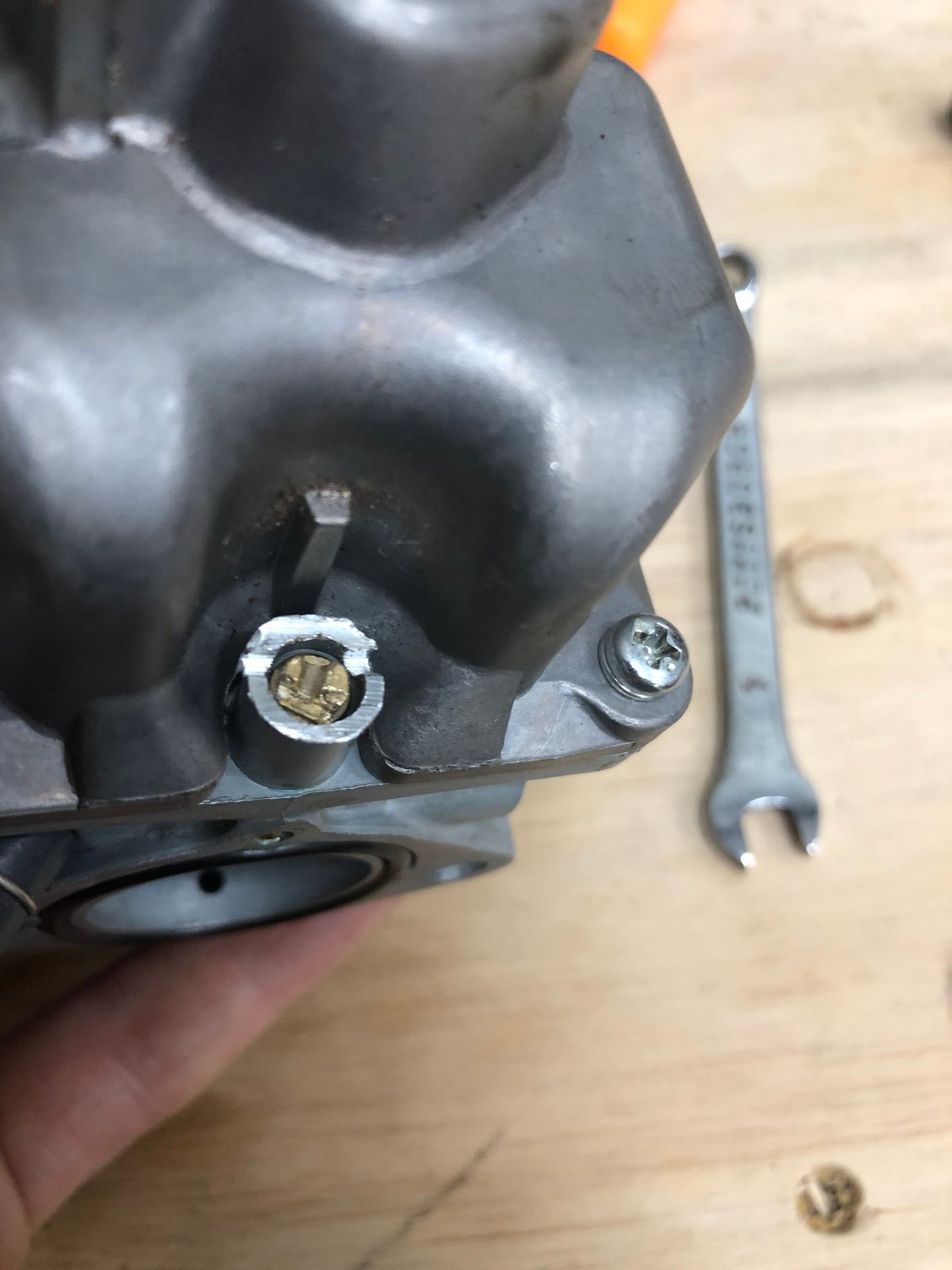

Adding this for fellow problem solvers..
The brand new Honda carbs have Welch plugs installed (brass cap ) so you cant alter the air fuel mixture screw (emission reasons). I ended up drilling mine out and cutting the casting off to reveal the fuel air/fuel mixture adjuster. Not the cleanest job but it works and is now tunable.

They seal it off because you are not supposed to mess with it. It only adjusts the idle mixture anyway, so wouldn't affect the mid range running which you say is the problem area.
