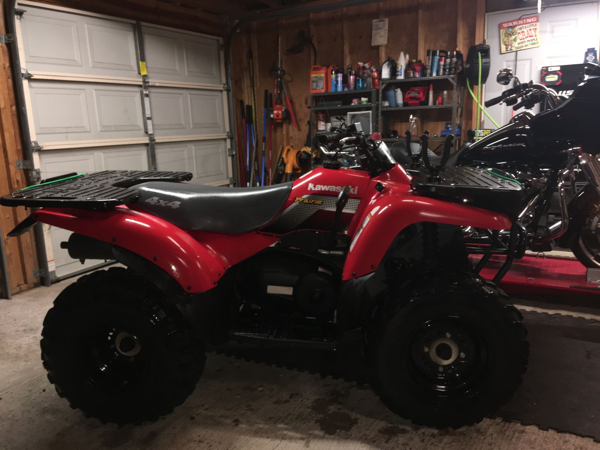

Okay so I found this mint one owner 2002 kvf300 4x4!!! I serviced the machine changed the diff fluid and cleaned it up! The bike only had 889 miles on it at the time I bought it. The bike would skip and sputter and then clear up and drive like normal! I removed the carb and cleaned it. Still does the same thing and all the jets are clean.... HELP!!!

I owned one just like it for 16yrs with no issues.. great machine. Check to see if fuel flow is good, the filer in the fuel petcock might be crudded up. Check for water in your fuel, a common problem today with running storage tanks to low. Mine had developed a slight hesitation on acceleration and was hard starting in really cold weather, so I bought a "Uni" rebuild kit and filter. Changed jets that were in the kit and adjusted the slide settings per kit instructions. Ran like a scared rabbit and started quickly in really cold weather after the kit install. Good luck.

Thanks I’ll check that!! Yeah this bike was in a time capsule I think it is literally like brand new other than the light skip. I filled the tank with 93 and added a little marvel mystery and sea foam. It idles great and will run awesome it just has that little hesitation every now and then at low rpm then goes away. I’ll check what you suggested!!!
Painted the wheels black!!!

The black wheels look good! Drum brakes do squeel, mine did also until they got warmed up.
