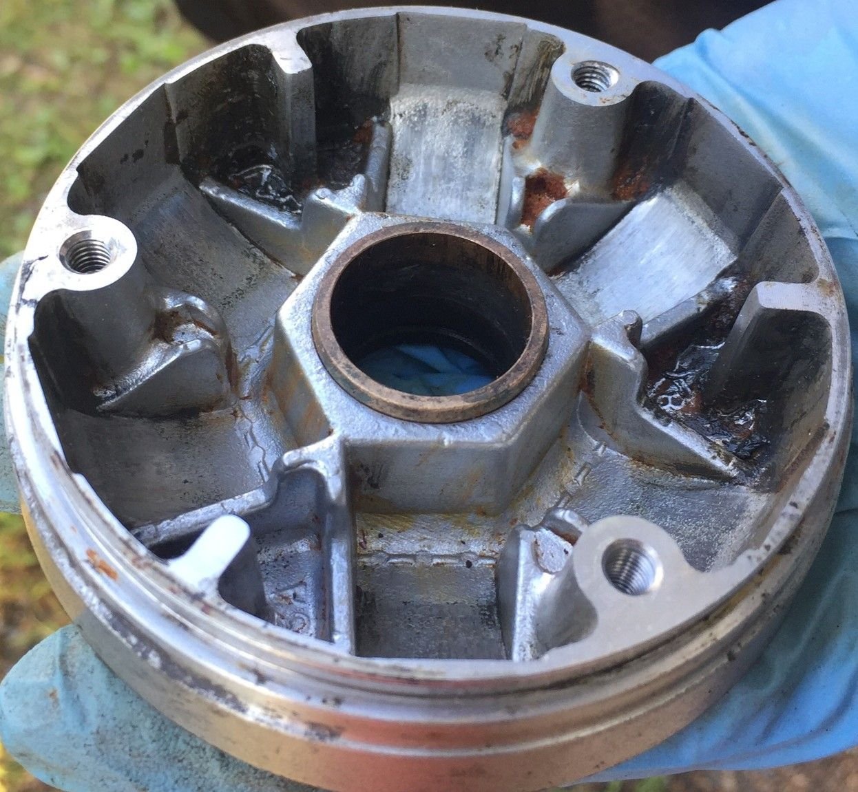

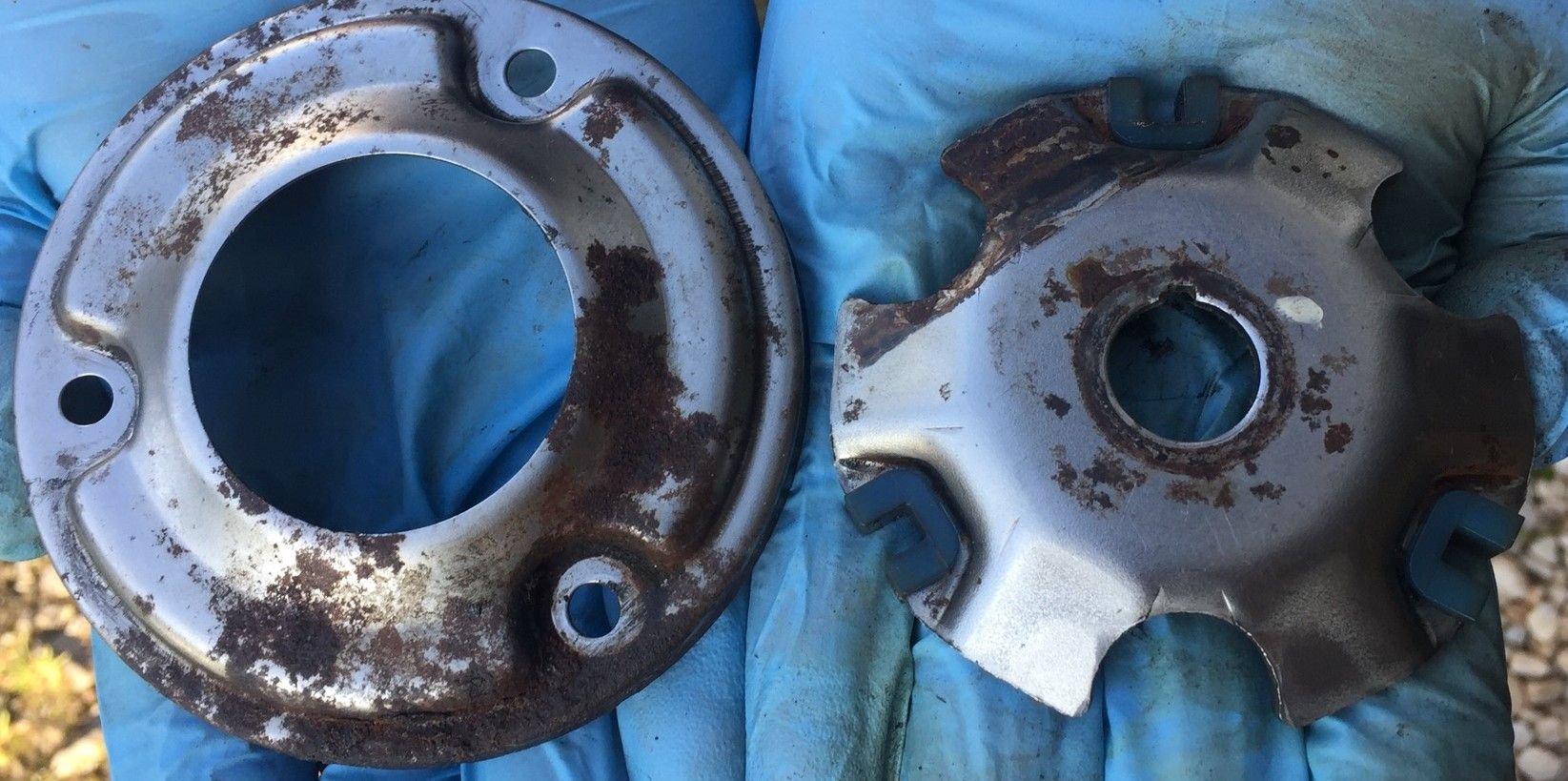

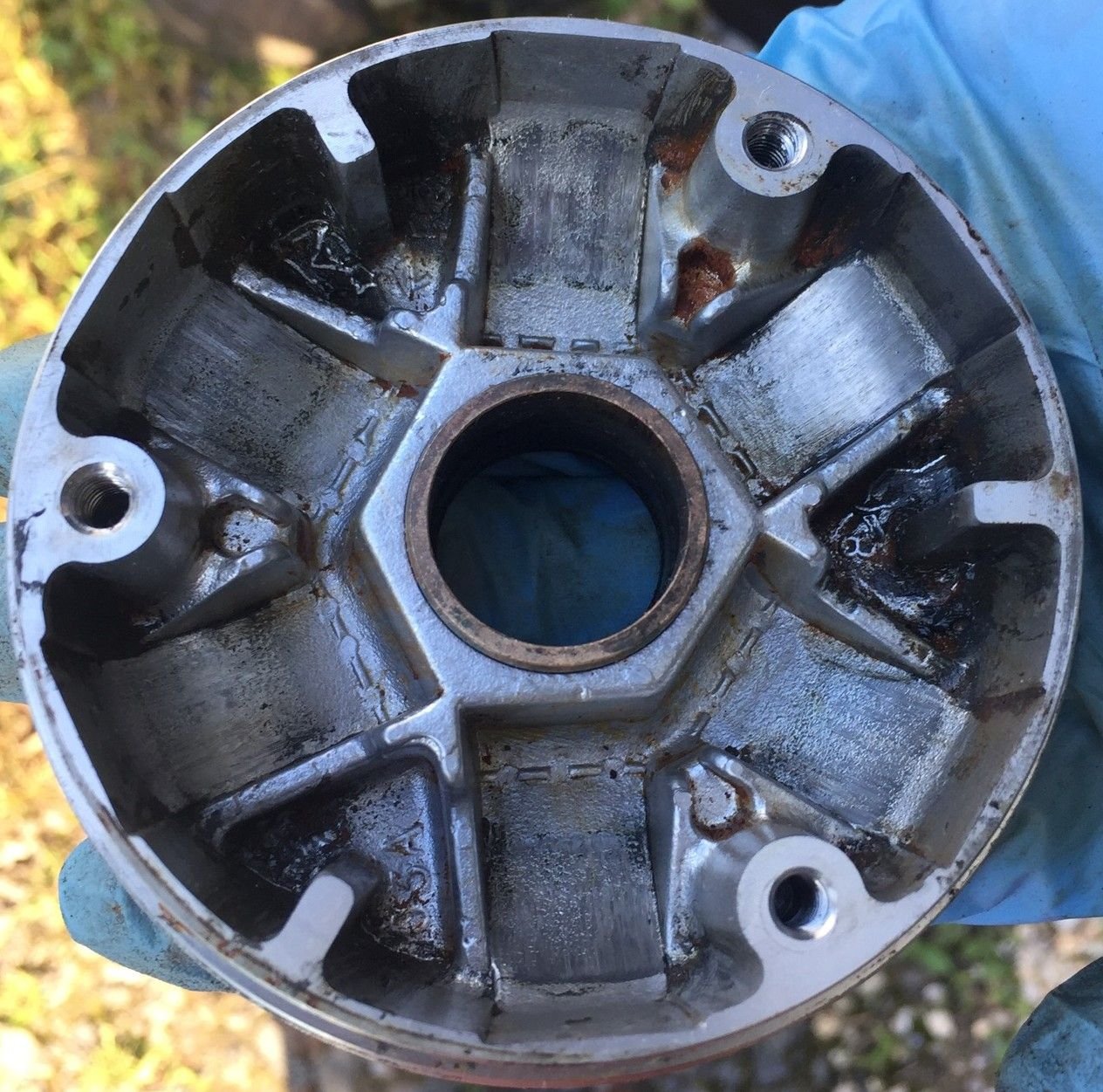

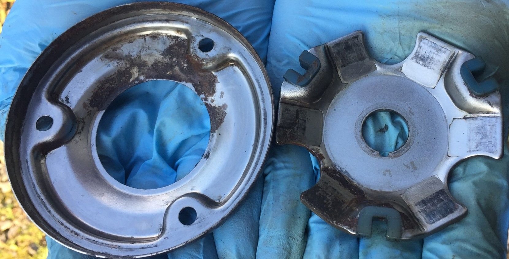

@LT80 , I got all the grease cleaned out that I could. I've attached pictures below of what it looks like now. I can sand the rust off. Just didn't wanna put more effort in to be told it looks like garbage and to buy new lol. It feels smooth inside not deep gouges. And the plastic clips are still super sturdy. None broken.
Let me know if you need any other angles!

Looks good to me!
Run it.

How does that one piece look where the key sits?
Old Sep 6, 2019 | 07:10 AM
  #25
LT80's Avatar
LT80 Expert
Joined: Mar 2001
Posts: 8,340
Likes: 33
Looks good to me.
