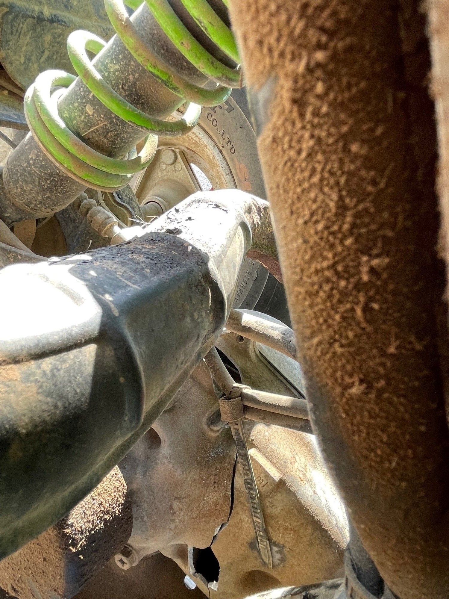

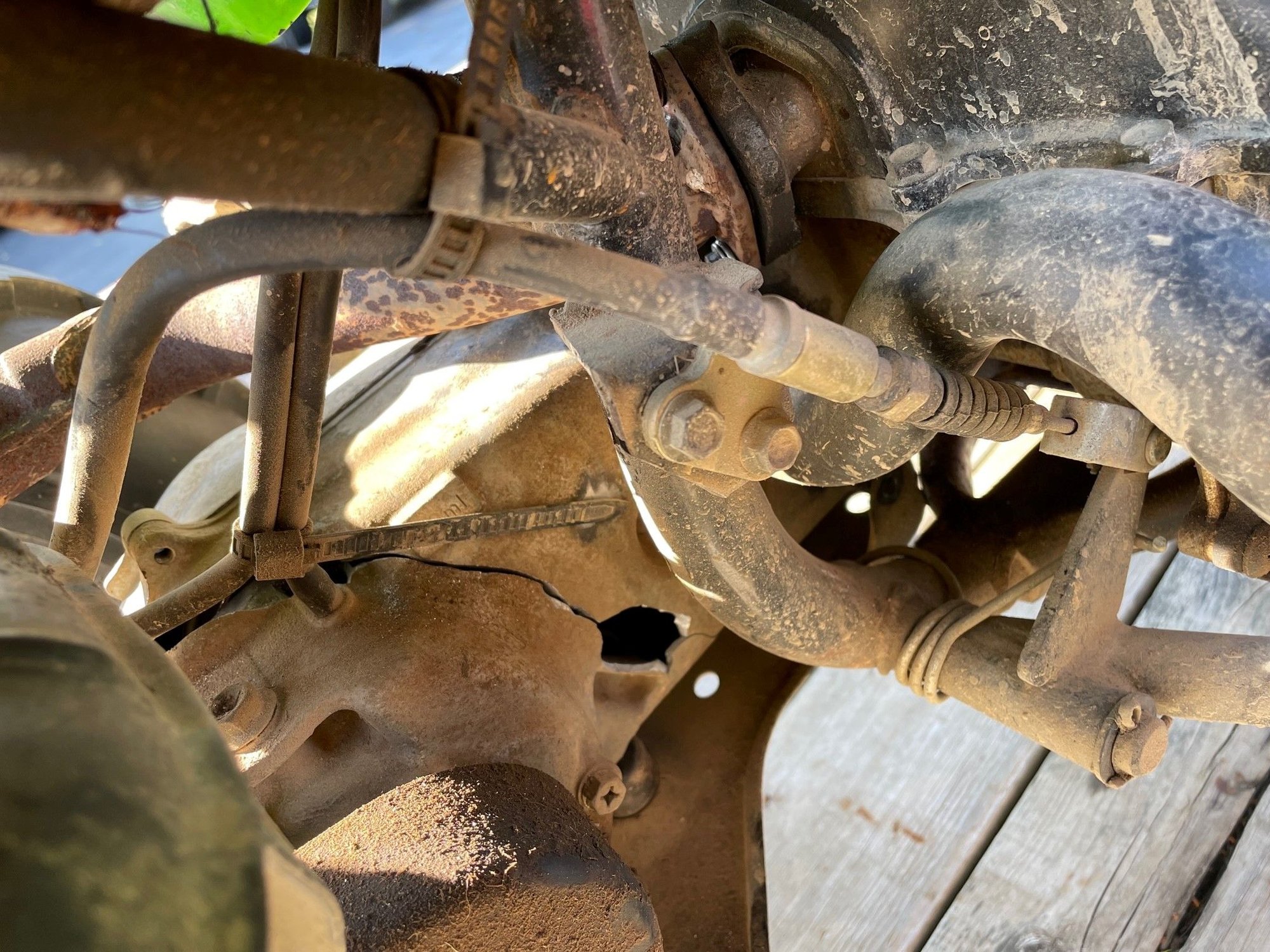

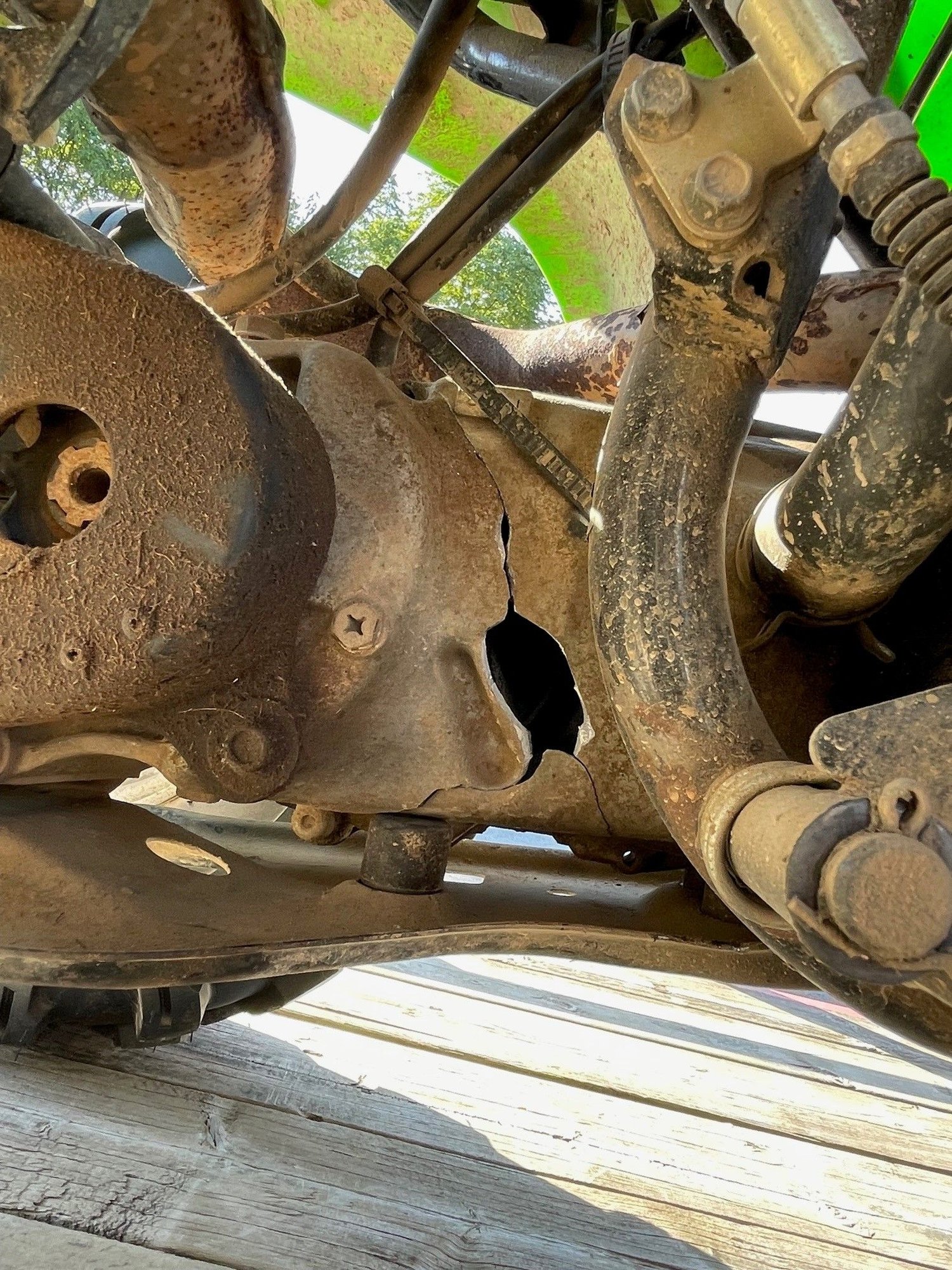

Thank you to everyone that sees this and responds, and glad to be here... Here are a few pictures to explain my issue. To start with my boys could break air, but this time it was the main case to the KFX80, so from what I am seeing it is a common problem. Mine is so bad the guy at the weld shop said he cannot weld it without compromising the integrity of the other metal around it. So, does anyone have an inner case they would be willing to sell me so I can get this thing back together. Thank you in advance or any other advise would be greatly appreciated at this time.
