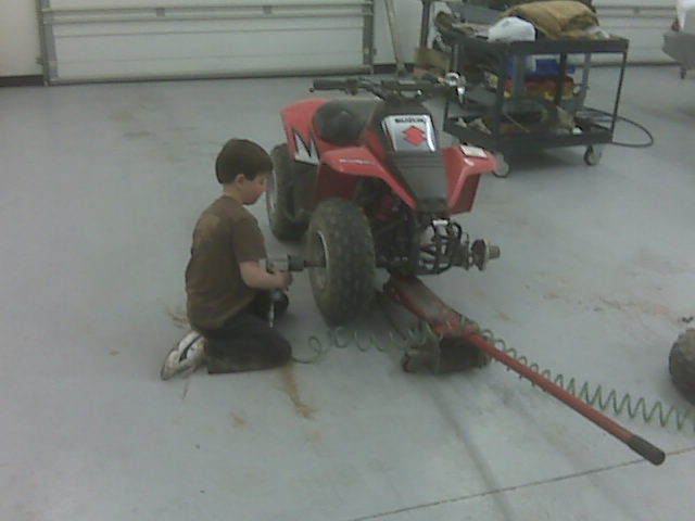

You guys here are A1 in my book,thanks again to all that responded.It went back together leaving out the head gasket, fired it up,sightly different tone with more compression,choke off them same thing acted like it was running out of gas and would die,as suggested,I pulled carb,benched it for a complete disassebly,back together and she purrs,one of these days I will take LTjacks recipes and do some the things he shares for performance.Thanks for the warm welcome and all the help.Gonzo Bend Or.
