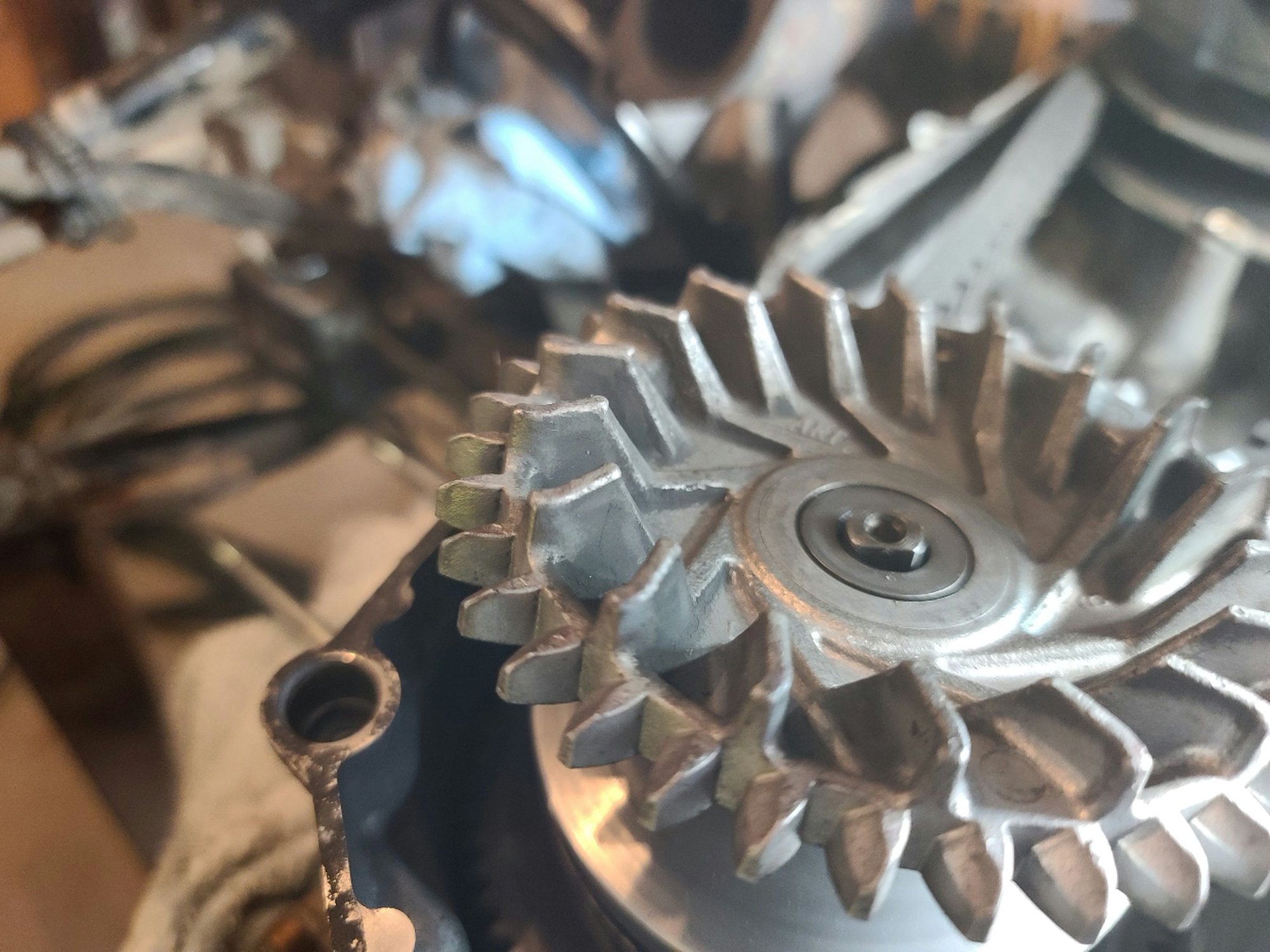

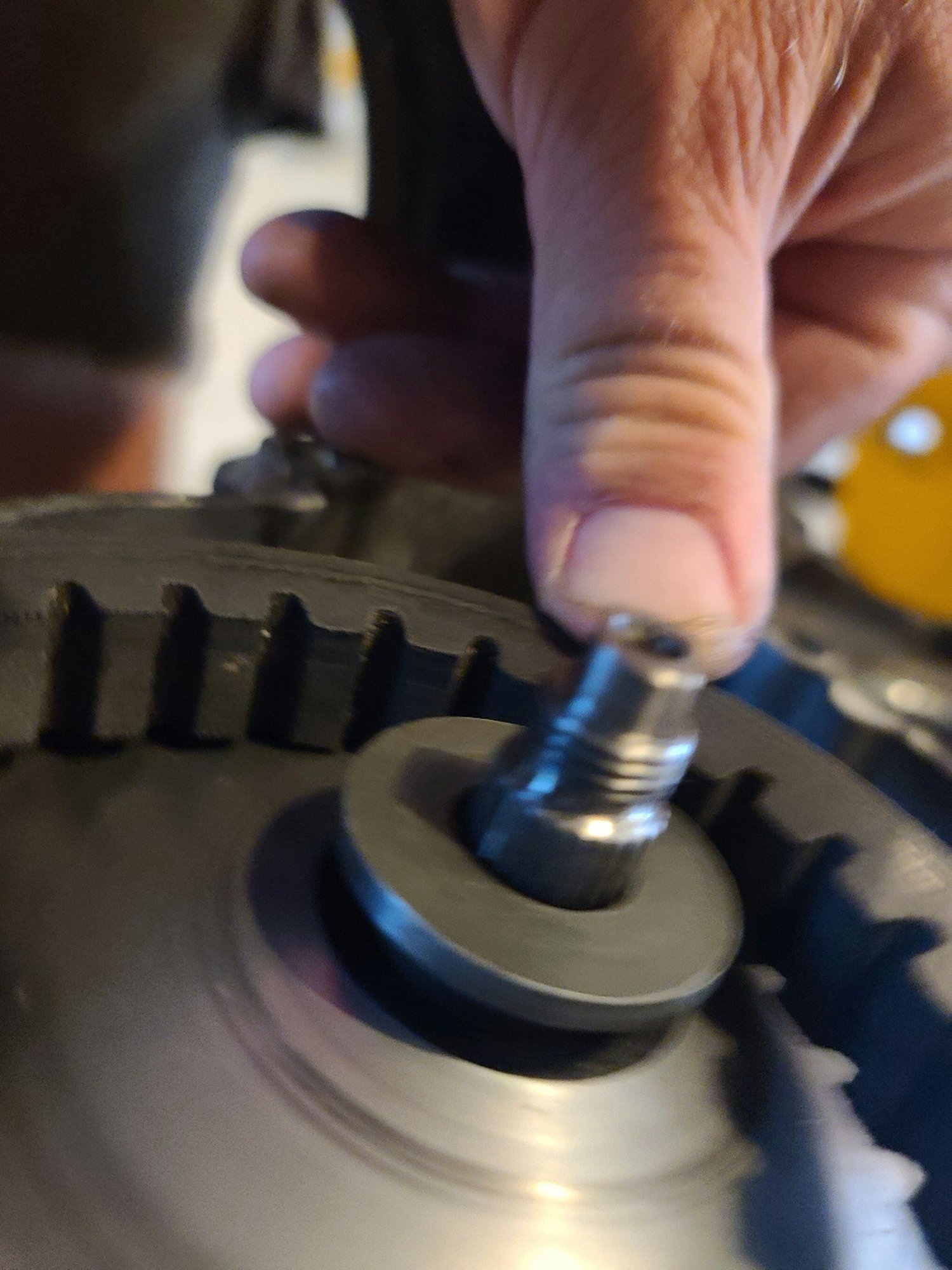

Tried it again, no luck. When I put the belt on and the washer, I run out of crankshaft to thread the remaining parts onto. But I realized, the restriction isn't with the spacer, its with the moveable drive or gear. The clutch belt goes OVER the spacer, which is pushed up against the moveable drive, which is pushed up against the gear, then against the crankshaft spacer/sleeve thing. Hopefully that makes sense.
I think the problem could be with the crankshaft. Does the crankshaft spacer/sleeve thing(see attached "crank" pic) need to be tapped in further, since that prevents the gear from sliding further down the crankshaft? See the pics below. (sorry, did not resize them small enough)

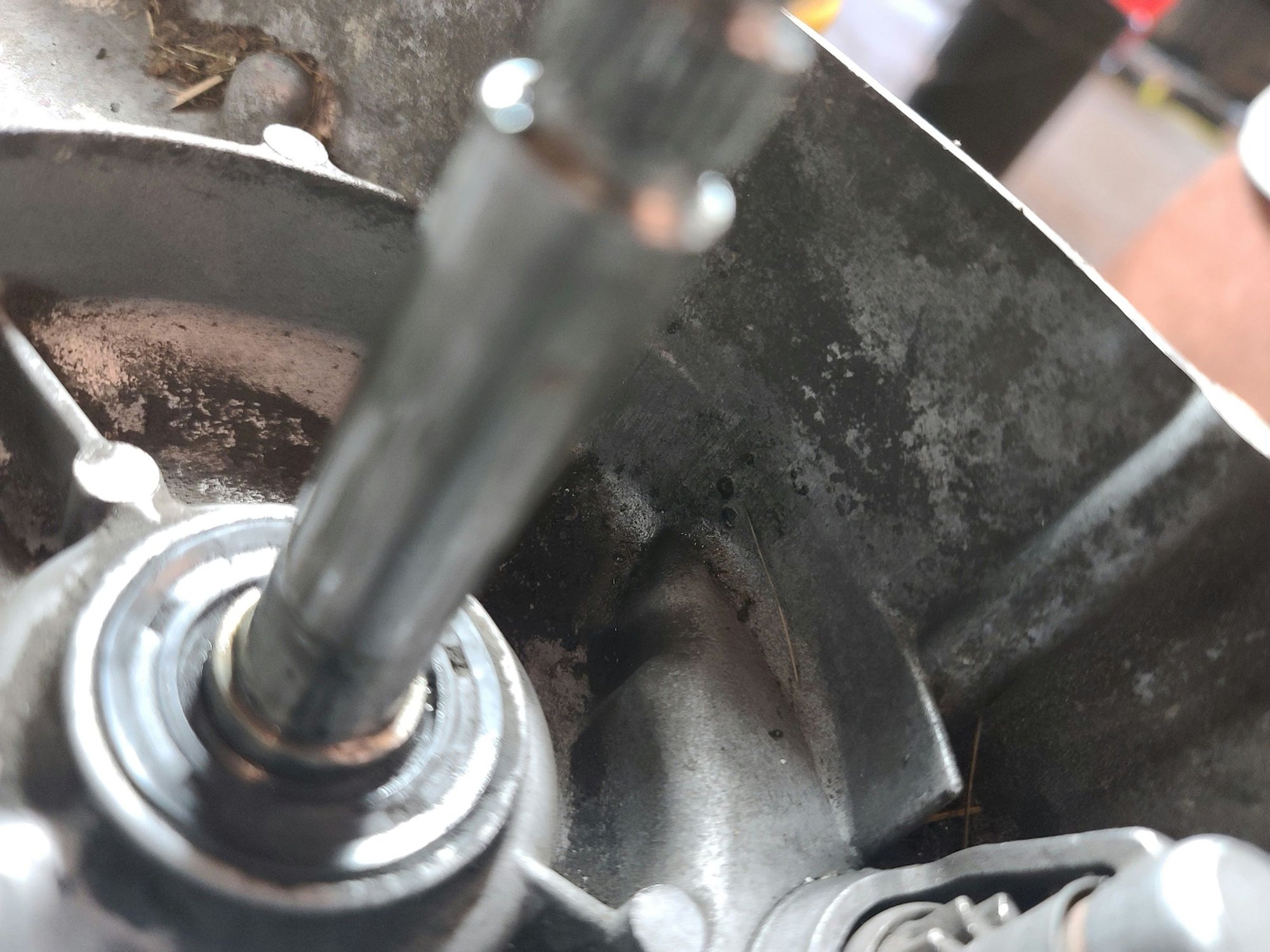

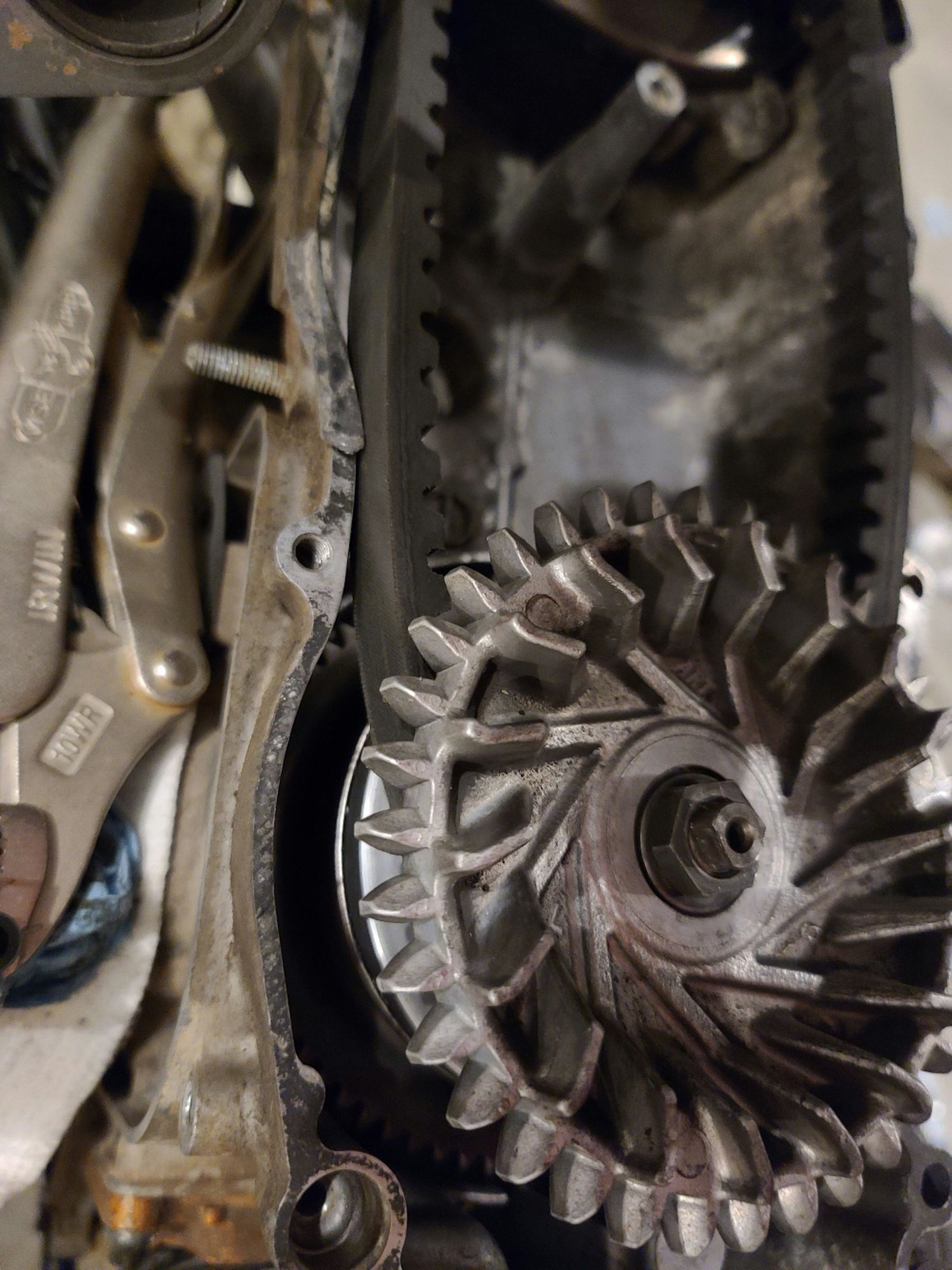

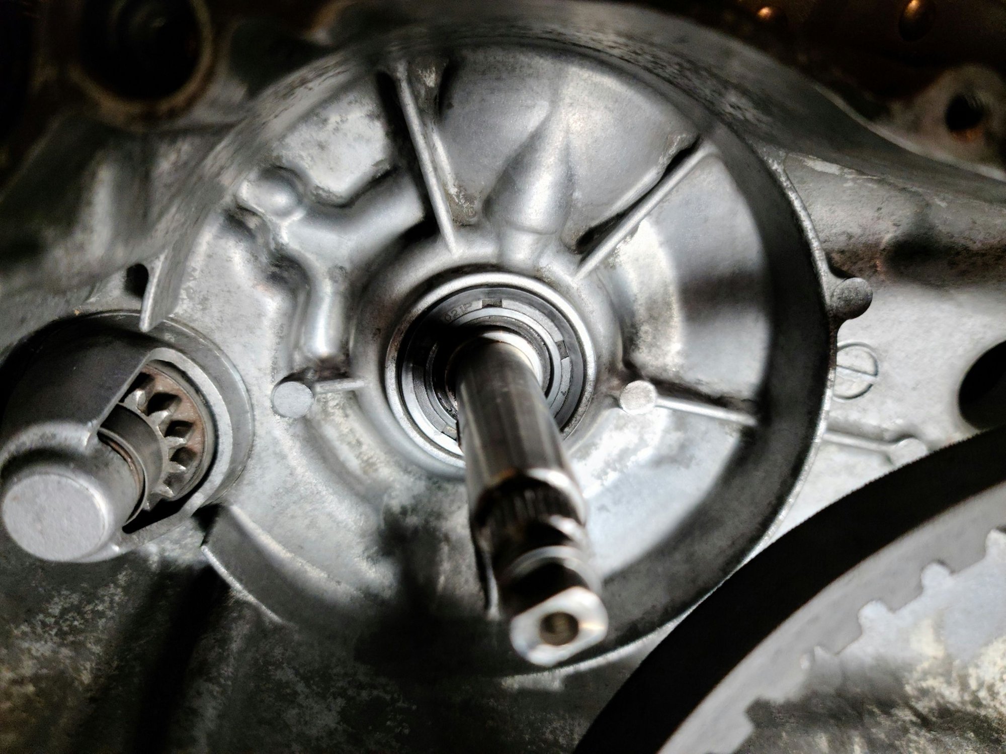

see attached. Appreciate all the help

What I noticed was 2 things,
1) why are you putting it back together not being cleaned?!
2) your seal is beat ta heck up! I'd replace that now. Seals are like 3-4-bucks each. I have them.
All else is fine. I suspect that you are not pushing the belt down in the rear clutch so there is room on the front.

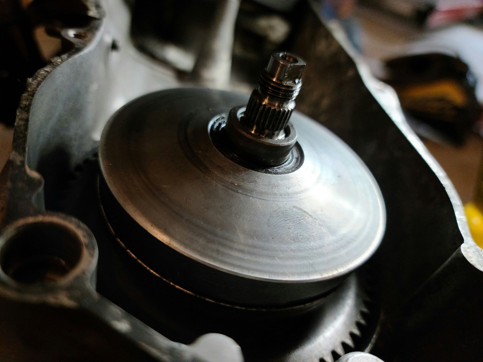

Ok, maybe and hopefully I am following. I pulled the belt forward pretty hard, which allows the clutch to sit deeper into the rear clutch. The washer can be seated further in so the the clutch actually rides on the washer partially. I can assemble the front clutch with plenty of room, hopefully that is what you were saying.........if so we are good to go. How quick can you get a seal sent to me?

To put it differently, the belt now sits more or less on top of the washer instead of sitting directly next to it. This allows more space to fit the remaining parts.
I cleaned and assembled. Will need to disassemble when the oil seal arrives but hopefully you got me past that issue.
Cleaned 1
Cleaned 2
Assembled
