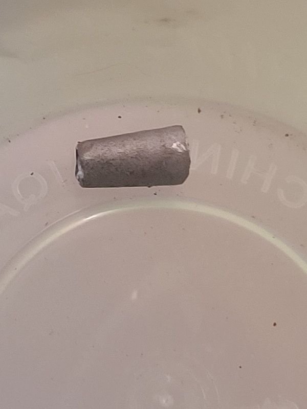

Bike has no power with a rider on. Stalls and dies. Reading through the many related threads for ideas.
would this be causing the problem?? This is only for the vent hose, so I wouldn't think so.
Broke off of carb

That's the hole for the vent. I see it's a cheapie carb anyways.
I recommend this one. https://www.ebay.com/itm/Carburetor-...72.m2749.l2649
I use the oem slide in it tho.
