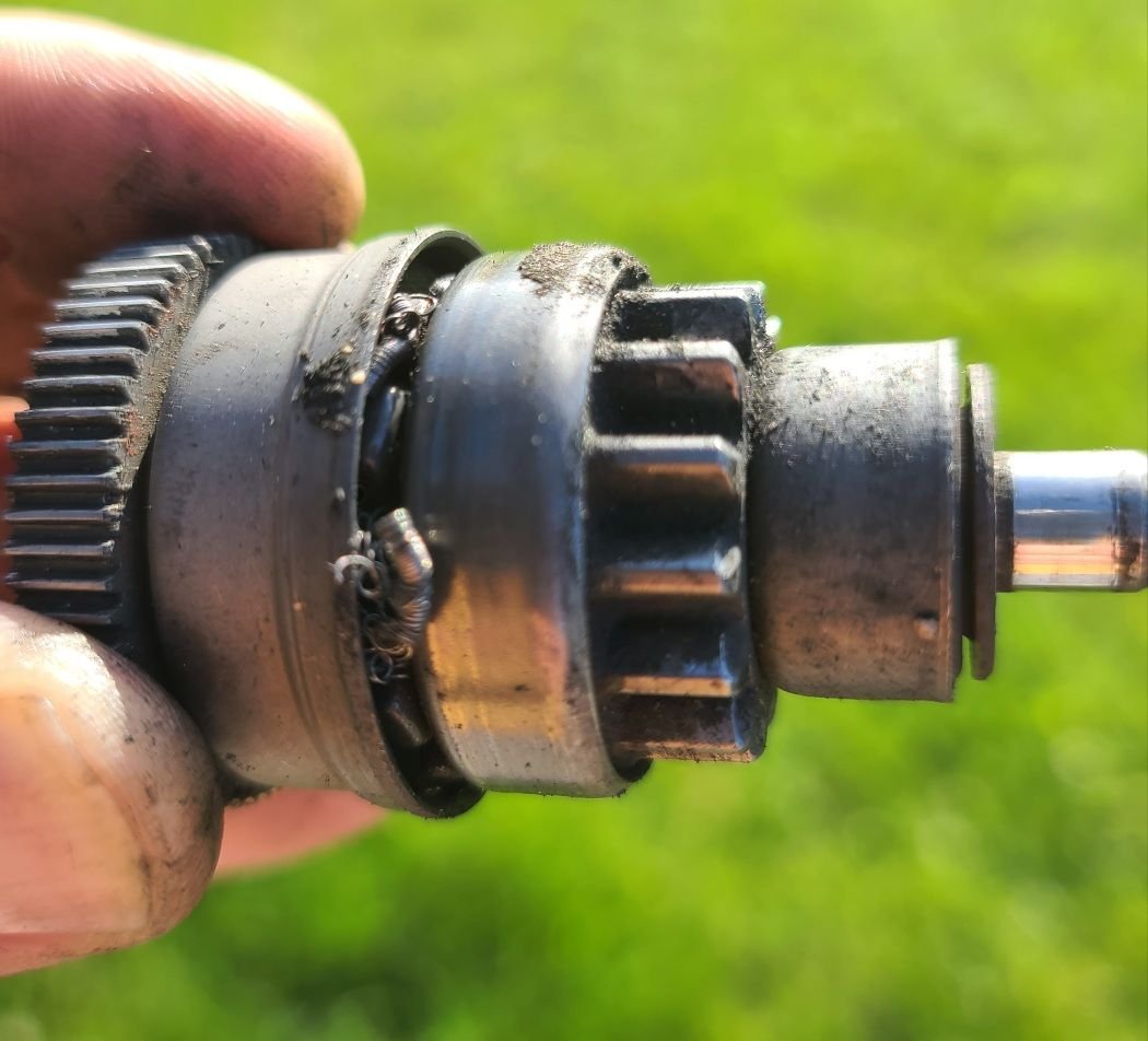

Rather interesting, there were like 20 tiny springs that were all tangled together in the pinion assembly of the starter. Strange, Glad I got a new starter on the way.

Installed starter and new carb, fired right up, still hear a ring when starting, never noticed before. However, is there something that needs to be done with the new carb? It dies when I attempt to ride it and give slightest bit of gas. Almost the carb needs cleaned again, but this is brand new. I took slide needle spring and copper limiter out and using existing. Dang, I thought we were there!!!
