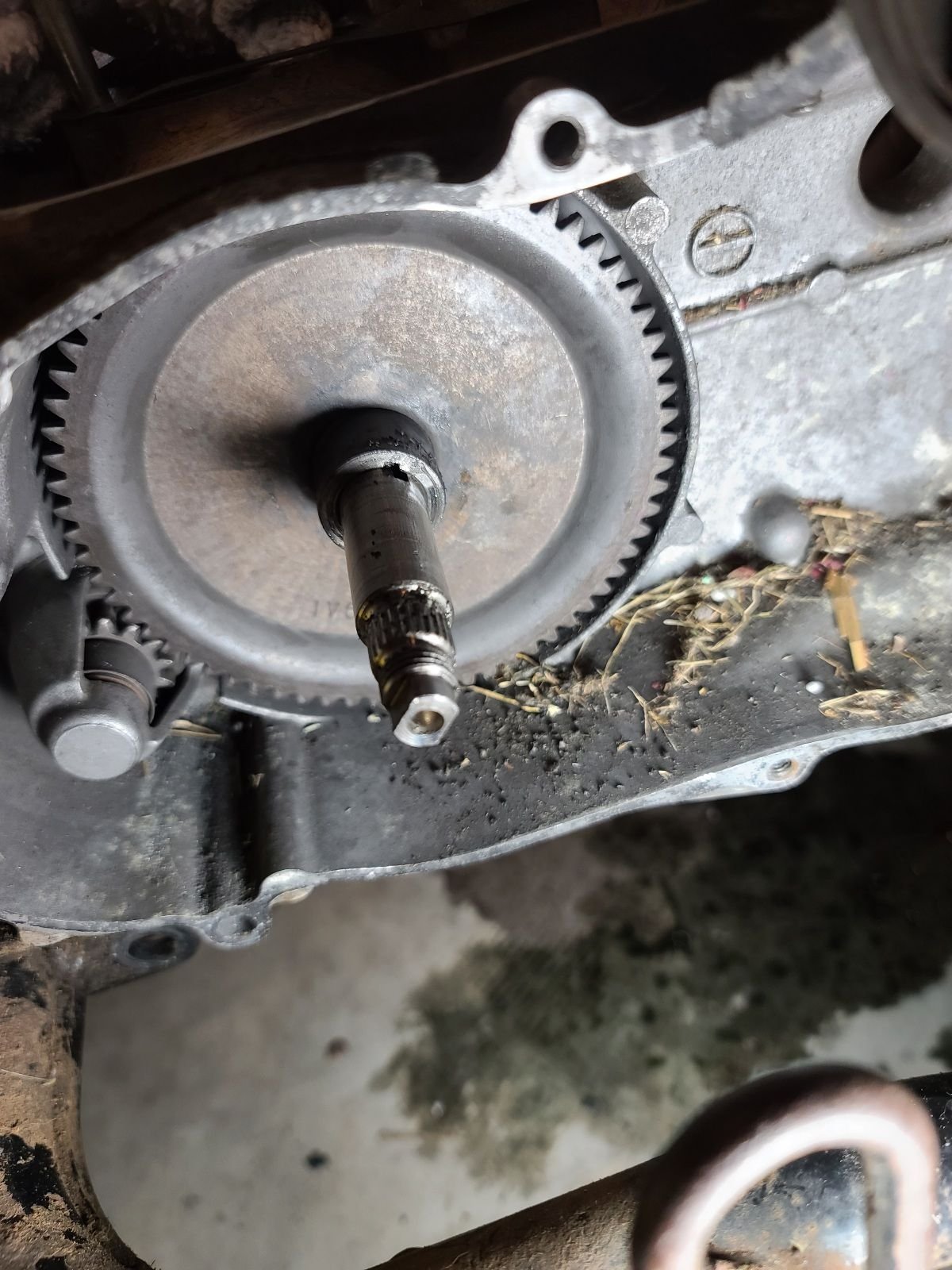

Can I please get some help. I can't figure out how the heck to properly install the clutch/transmission. I am following assembly here https://www.suzukipartshouse.com/oem...transmission-1
But I dont have enough room on the crankshaft to bolt on. I should have documented disassembly better.

1st off, I don't see the key in there. 2nd, you need to tap the spacer down in.. It'll be fine.

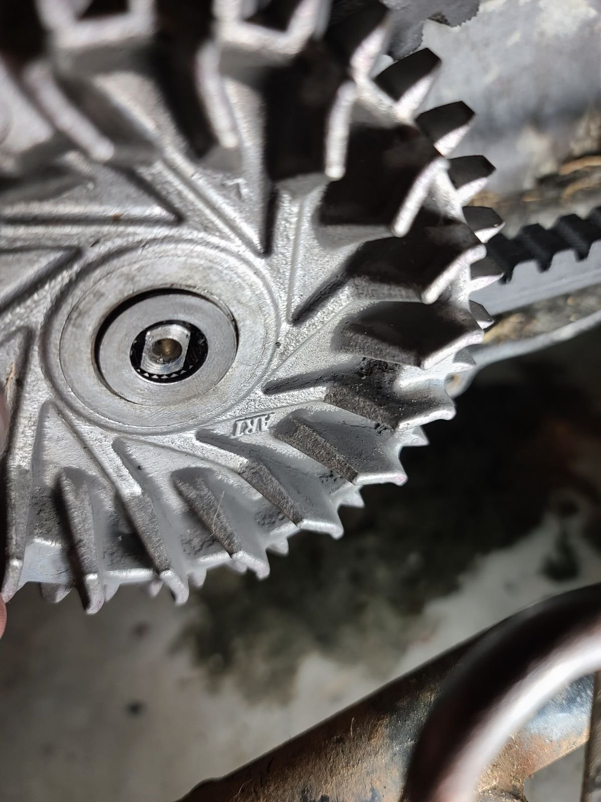

Found the key, squeezed it in the keyhole. Everything assembled and aligned with the key. Tapped on the spacer, it won't go any further. I think its some issue with the movable drive, but what do I know. The rollers do have flat spots in them, but I made sure to place them flat, and securely hold the movable drive to make sure the rollers to move or turn sideways. Still doesn't want to go on. Getting frustrated. Spacer length measures 1.275 so need the washer. Turned the bike over sideways to assemble the front clutch, still didn't help.
The spacer doesn't go into the crank all the way flush up past the grooves in the crank. Needs another 1/8 inch.

Look at both pics (one of the pics above), the spacer is down in on the current pic, not in that one.. I think it's fine. Put the outer face on w/spring washer and nut. Let's take a look see.

I am not sure what pic you are refering to, when the spacer is where it needs to be. Pics are numbered 1-5 for reference, but I am not seeing it. Sorry man. I will try again today , but it seems the spacer has no more room to go in. I have tried and forced attempts to get the nut on but can't ever grab the thread. I am waiting for the "you idiot" light bulb moment haha.

OK, 3rd pic down. See how far out by the splines the spacer is. The newest pic shows the spacer down in and the washer in place. Splines are sticking out.
I'm saying put it together. I think it is OK. If you still wonder, show me a pic of it all together.
