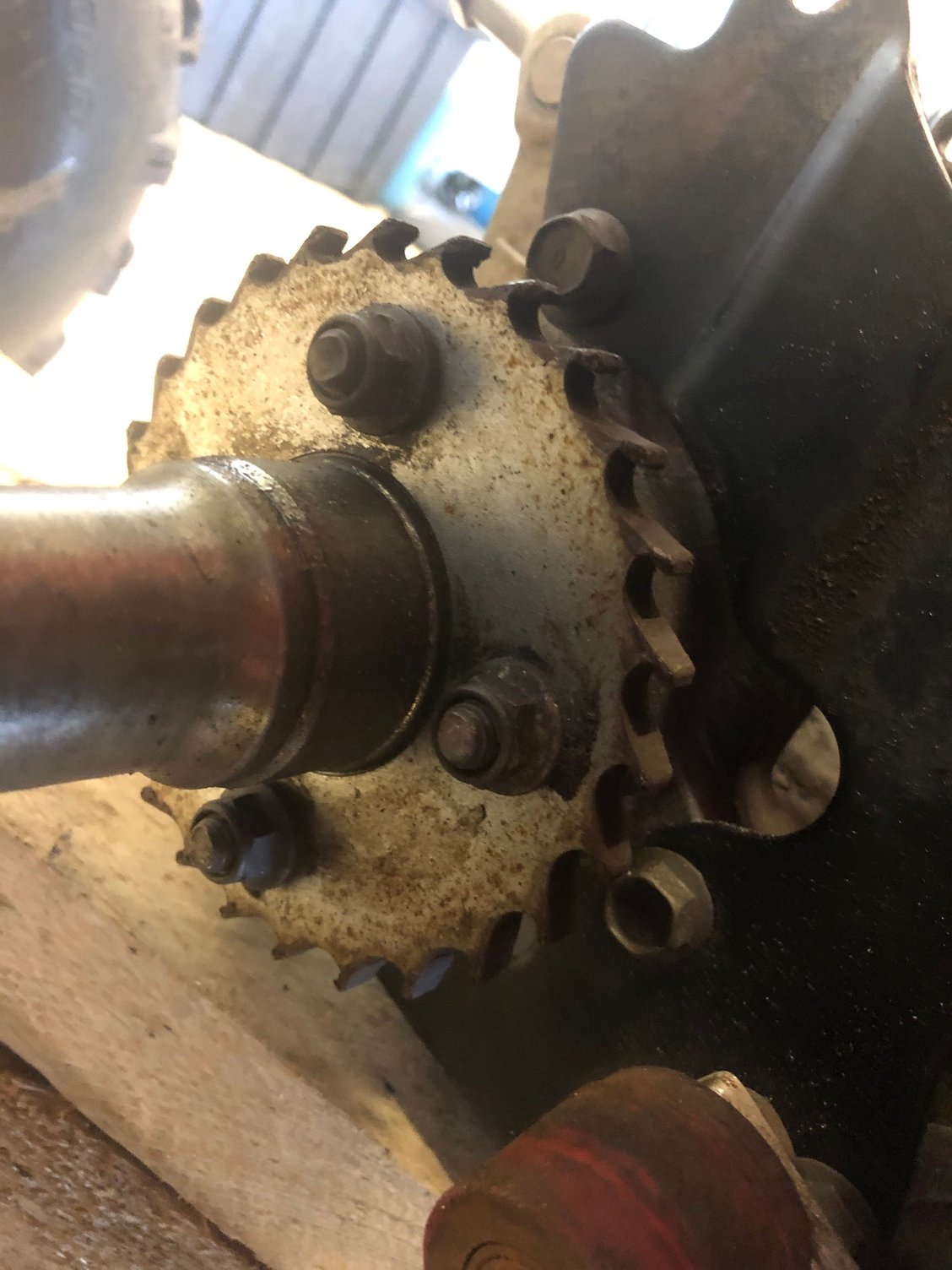

Default Would you look at that
It was the rear sprocket i think 🤦🏼‍♂️

You could fish with that sprocket, LMAO
