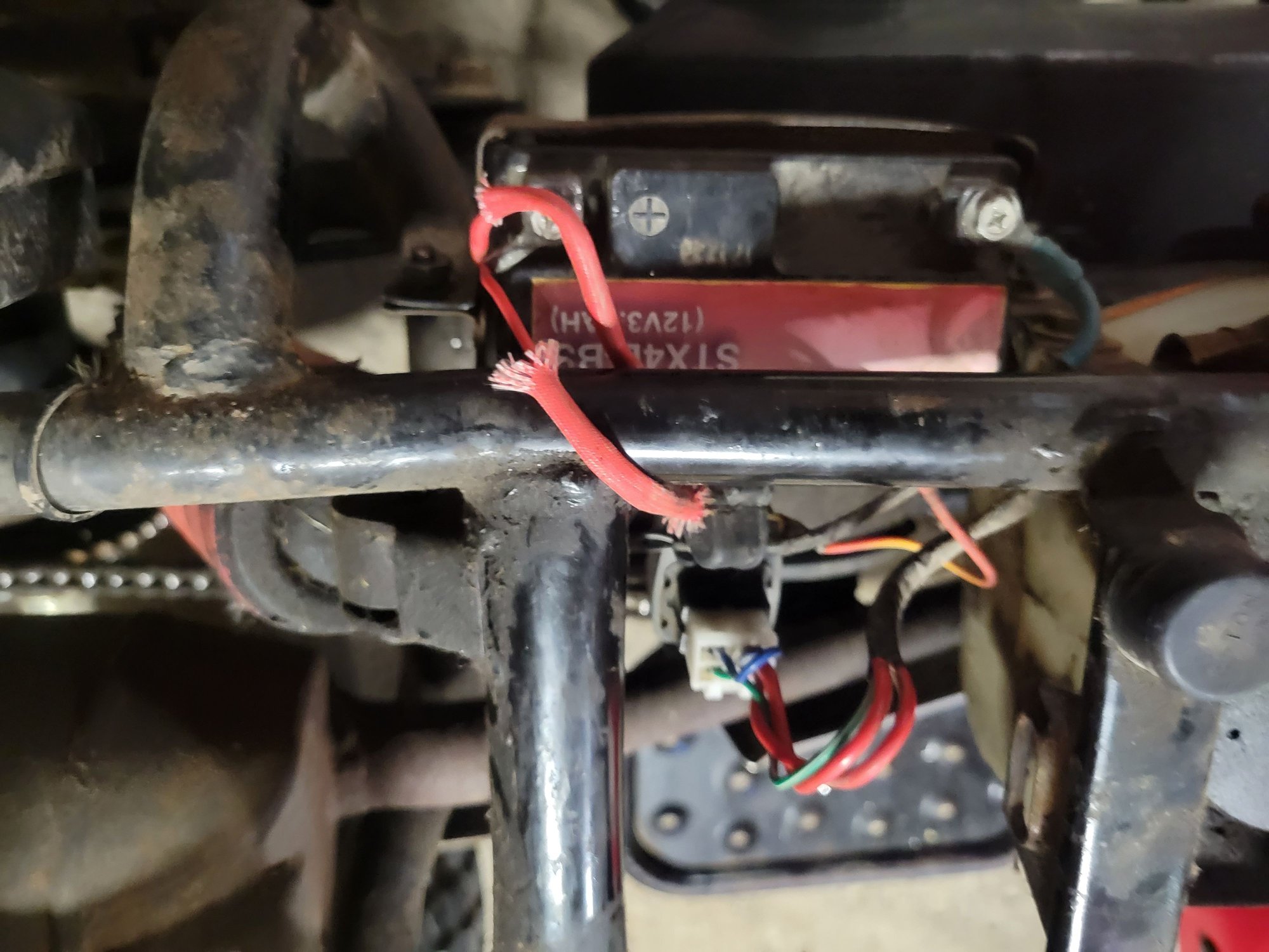

I have a eton txl 50cc atv. The electric start doesn't work. Tried new battery didn't work. Checked all electrical plugs and added dielectric grease. I ran power to the starter and it works. There's one inline fuse on the positive terminal at the battery and that is Still good.
How do I check the kill switch? This machine has a relay and not a starter solenoid. I tried a different relay already. I had it running a few times with Kickstart but I need to replace the spring on the Kickstart now.

Ok. This model has no lights, basic kill switch/starter button combo. What I'm thinking is I have a bad starter button. I posted a picture of the one I have. Im wondering if the models that have the light switch added into the kill switch block will work and plug in or not.
