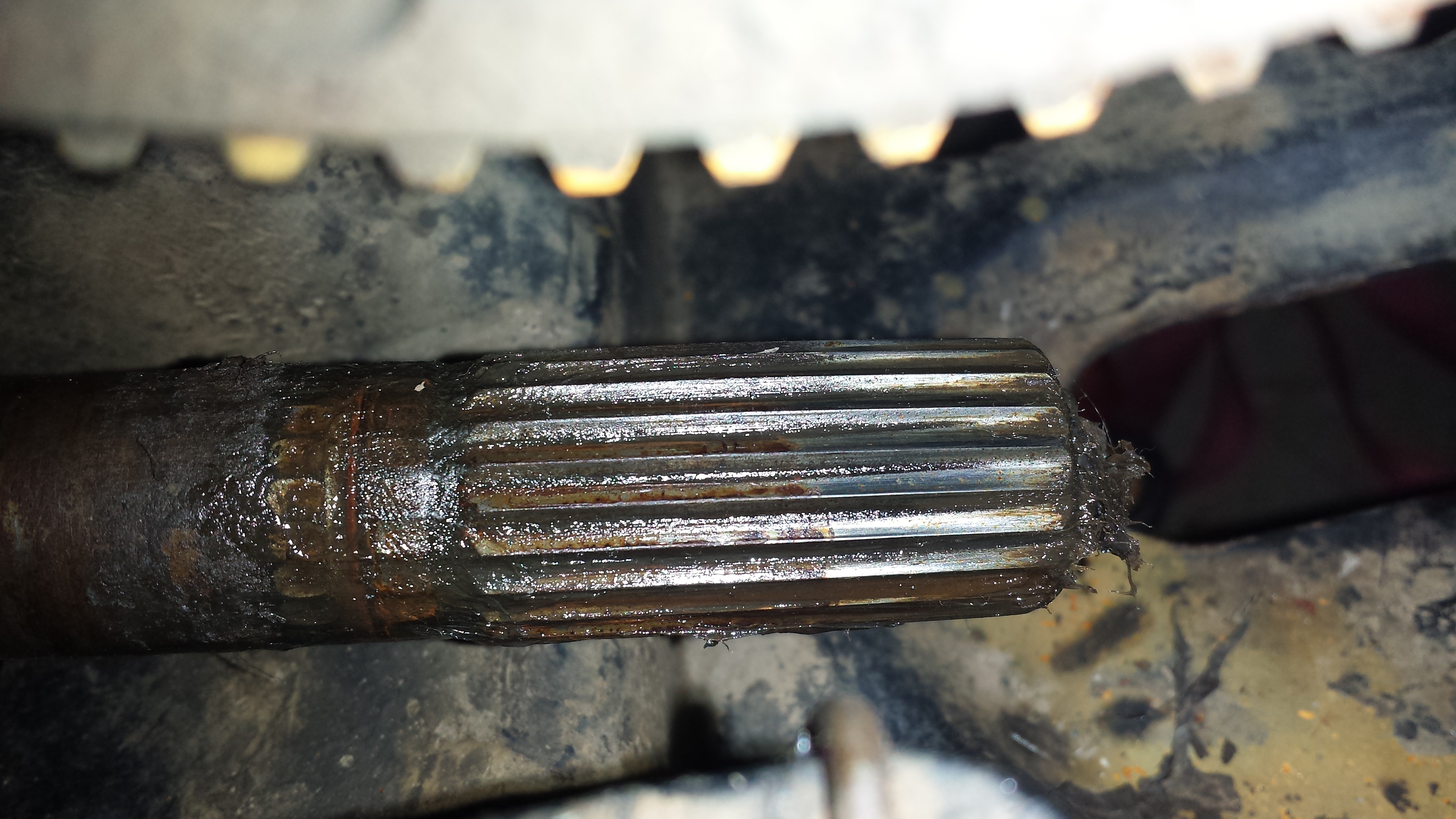

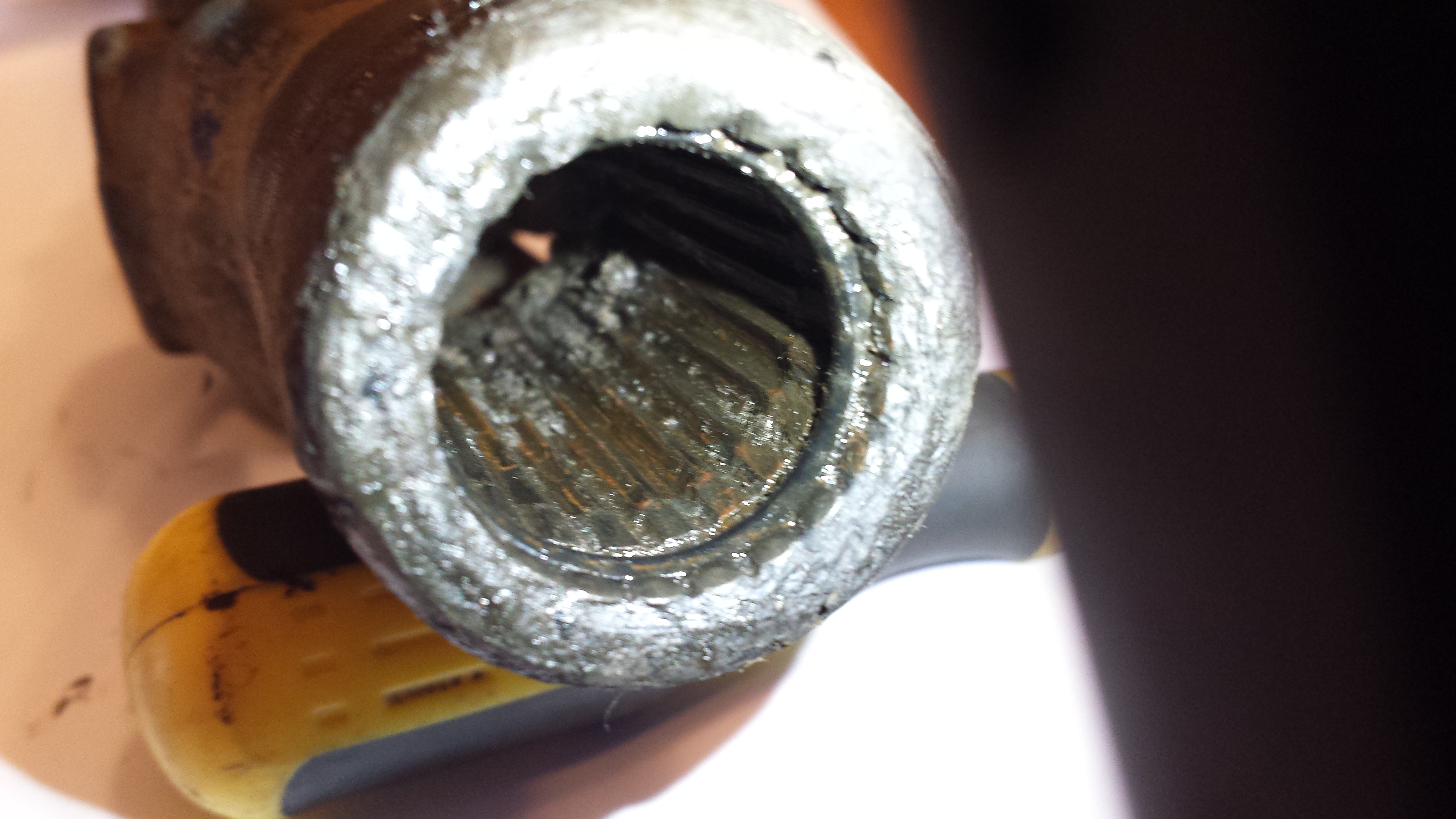

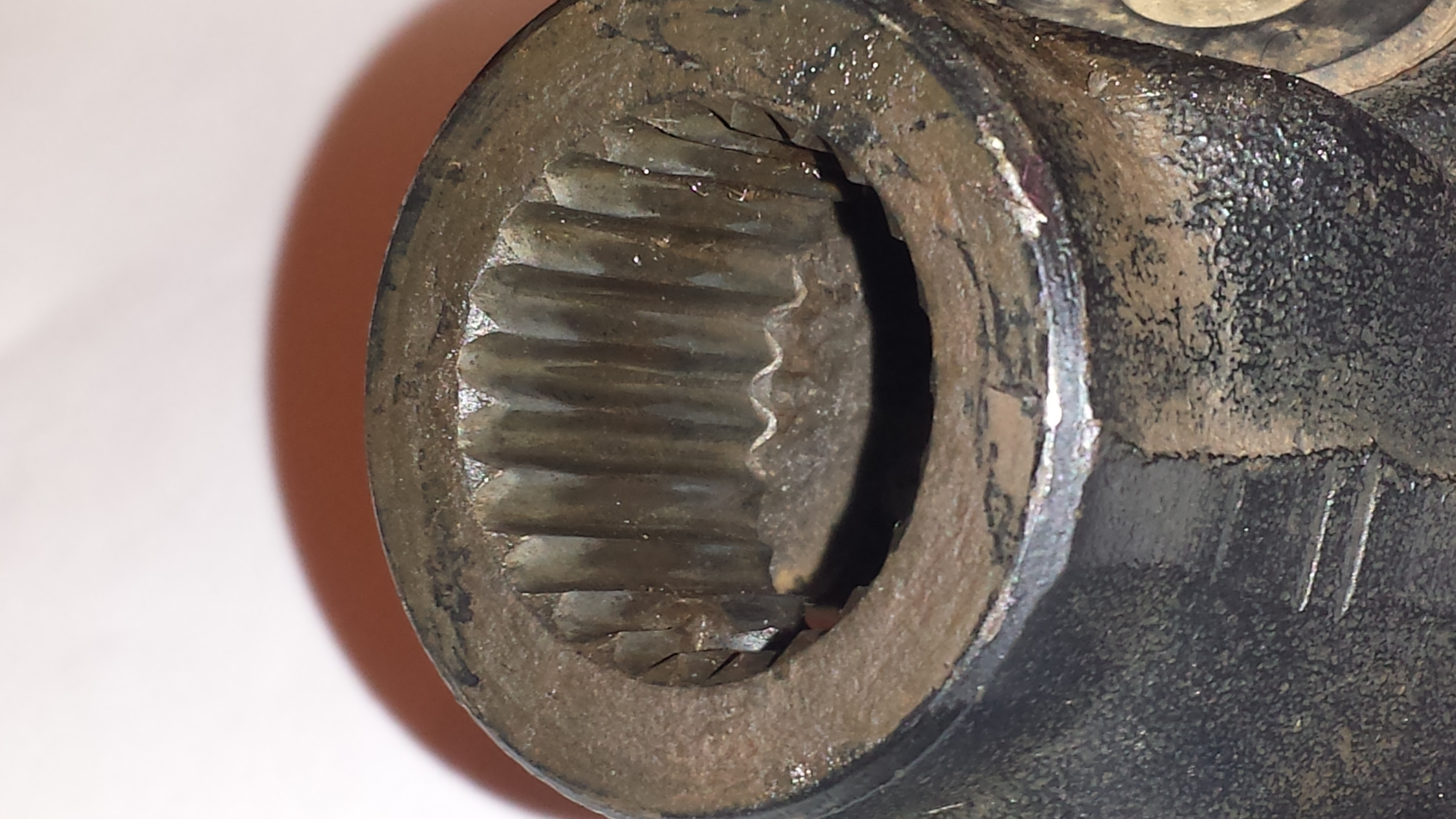

Hey guys I was wondering what parts to order with regards to the prop shaft and transmission shaft piece and differential spline shaft piece. Here are some pics of the prop shaft yolks and the splines they go over. Could you tell me if they look wore out. I know I need u joints. Guess I got to figure out how to put pics up now lol...

Don't see any pics.. If the yoke spines are in question along with the u-joints,then cheaper to replace the prop shaft as a unit rather than trying to rebuild one..

There's two pics....

Old Nov 20, 2015 | 03:17 PM
  #49
First pic the splines look dry and worn from no greasing looks like. If it's the rear yoke by the gear case,this is the one most people over look on greasing as the zerk is hard to see and get to without a flex grease hose.In fact both look pretty dry. I'd think seriously about replacing the prop shaft assembly and be done with it if the u-joints are worn also.. Gear case shaft splines and diff shaft splines are harder than the prop shaft yokes.Think they're made that way on purpose.

Ok thx there dry because I cleaned them all up to show the splines. Do they look like they have enough splines is the question knowing I cleaned them off.
