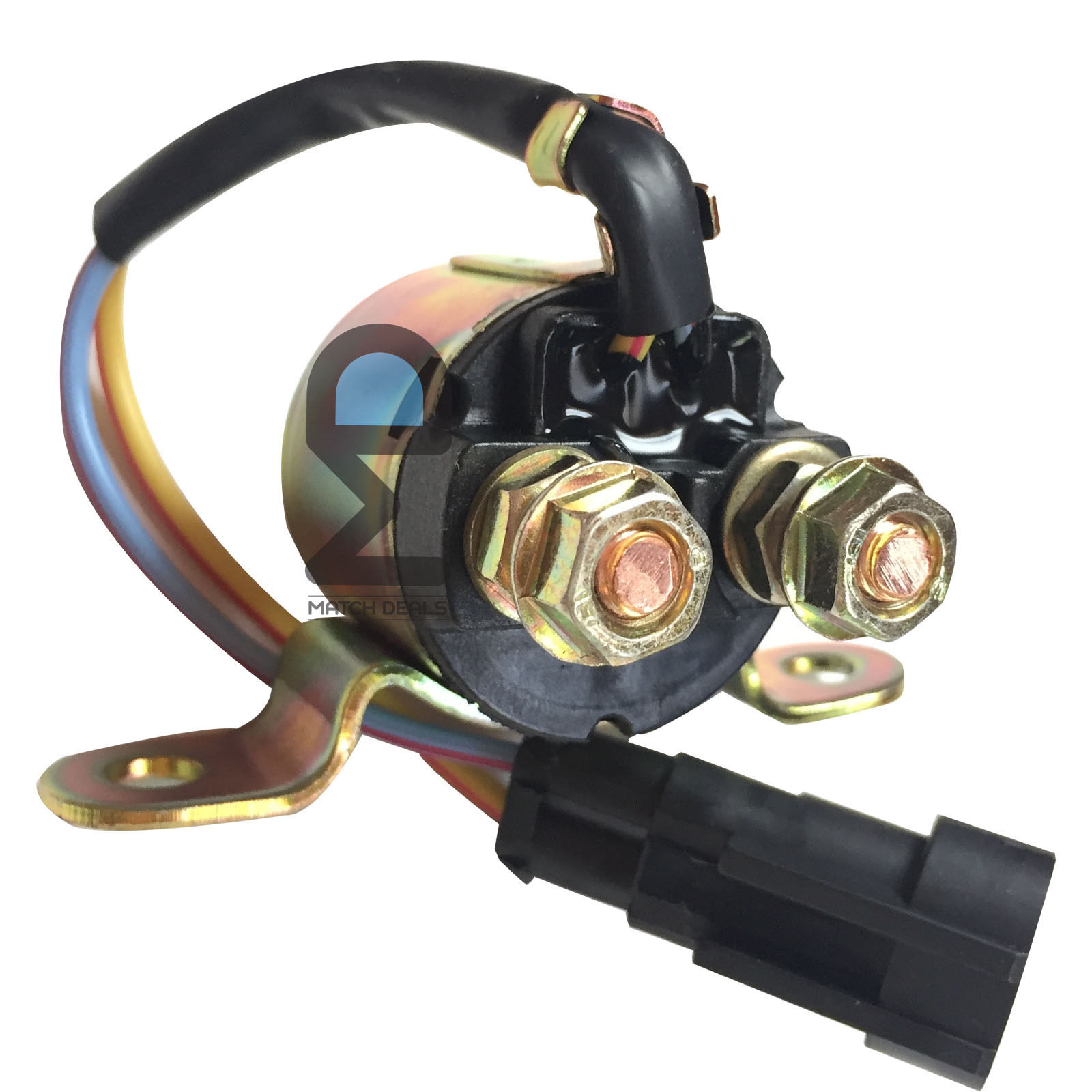

With the key on, the bike has power to the console to tell me what gear it's in and I can access the diagnostics, etc. Kill switch turns all the power off and on, as it should. Lights work, brake lights work, can hear fuel pump after key turn. Turning the key to start does nothing. No power to starter, no click from the solenoid, nothing. Tried it in park, neutral and other gears, just in case (but display console does show the correct gear the bike is in). Tried it with and without the brake lever depressed. Lights don't dim to indicate power going to a jammed starter. Voltmeter on battery shows 12.4 volts. Just in case battery was having trouble under load, added 2nd battery via booster cables. I have 11.9 volts to the plug on the solenoid when turning the key to start (so ignition circuit should be okay?), and I can jump the solenoid pins to start the bike (in any gear, as this just puts power straight to the starter). Once it's running, everything works as it's supposed to - lights 4wd, reverse override switch, all of it.
I've replaced the solenoid (twice) with same issue. I've read about issues with both the circuit breakers and the fusible link, but I think if it was either of these issues, I'd have no power at all...? So, either I'm wrong with one or more of my assumptions, or there's something going on that I haven't thought of yet. Help? Please?

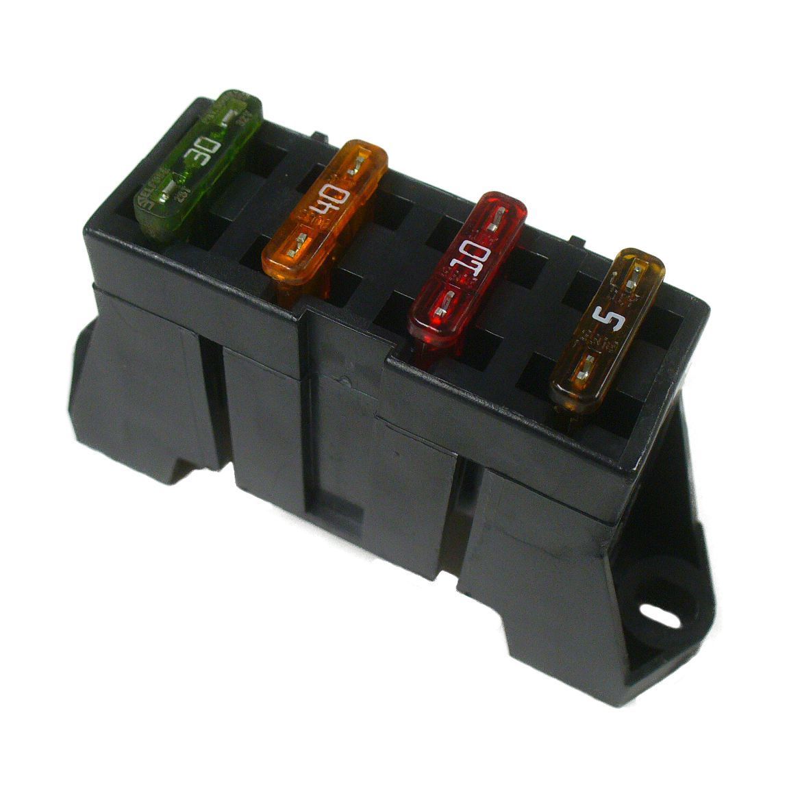

Check the fuse block as this was another problem area.Lift it up from the frame and check wires that may have partially pulled out from the pins or for corrosion.Erratic power from these have caused a lot of frustration for owners.Delphi fuse block are cheap if needed,along with other moisture resistant fuse blocks.https://www.diyautotune.com/product/...ar-fuse-block/

You're not getting power to the starter solenoid coil , unplug the starter solenoid and check for 12 volts when key is turned to start , I'm guessing you're missing the negative , tap a wire to the brown and ground it .

Missed that. If the delphi block,fuses and wiring are ok,just pull the solenoid and scrape around the mounting area on its frame and see if that's solves it.Had a couple that had to do this. If you still have problems follow the starter system flow chart in chapter 10 in this cheap manual.

Sorry for not coming back and posting, as the solution I found wasn't a "solution" but just a workaround. The ECU is supposed to send ground to the solenoid for "okay to start" type signal (bike in Park, or Brake depressed = "okay to start"). Continuity test said wire okay, but no joy. Grounding solenoid to frame "solved" issue (although bypasses the Bike in Park or Brake Depressed safety features). Bike now starts fine, but in any gear, without the brake requirement...
