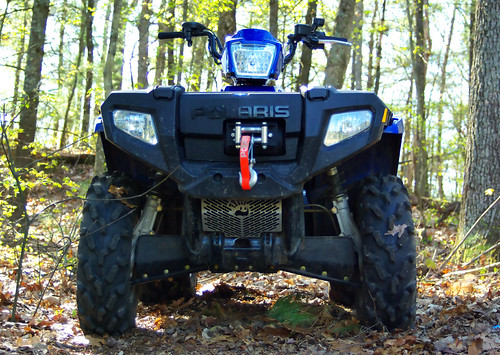

Here it is on the quad. I had to put the machine on some dirt to make it look right.

Mornin .22
That looks good. I was lookin at your right front tire and I'm not sure But it kinda looked like mine. So I thought I would show you a post I just made on camber. Hope you don't mind. I'm not trying to hijack your thread.
http://atvquadsquad.com/eve/fo...=8421069635#8421069635

Hobbles- Should I do it on both tires? Also you call it a ford radius arm bushing, is that all I ask for if I go to my local car parts store? How hard was it to take apart and put back together? What about the springs, I don't have the tools you used to compress the springs.
thanks for looking out for a fellow rider.

Afternoon .22
Yes you do both, There are 2 sets in the box. The part number is K8361 at O'Reilly. and yep, ask for a ford radius arm bushing kit.
And YES!! you SHOULD have 2 spring compressor's. Be careful !!! I do believe a person could get hurt doin this job..
Any thing I can help you with, just ask..
