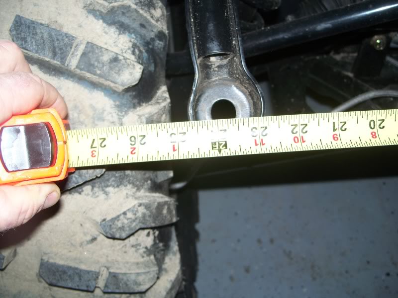

You actually have to rotate the swaybar up and over to the rear..it will hit if you try to go down with it..
Also in order to clear the BHs you have to bend it quite a bit..the BHs are about 11.5"...you'll know you have bent it enough when you have to pry it past that heat shield on the left side..lol..
Here is how wide mine was after bending to clear the BH2.0s...
Like I said you will need to work to get it back by the heat shield..I loosened the heat shield mount bolts to make it easier to get the sway bar back in position...worst case scenario just take out the heat shield bolts..

HO.... I see you had 23.75" or so on that tape measure. Was that on center on the opposite side? I ask because I got my distance to 23.5 on centers and had plenty of clearance around the heat shield. Like half inch or so. Am I looking at the picture correctly? My horns 1.0 come soon and I want to be able to mount em up and go so I am getting the clearance now.

i install terracross 26/11-14 they it the sway bar so i use the tie down trick. i crank until i hit 22 1/2" center to center for the night let it go now 23 1/4 so i get 3/4 and roll the end they never touch again
