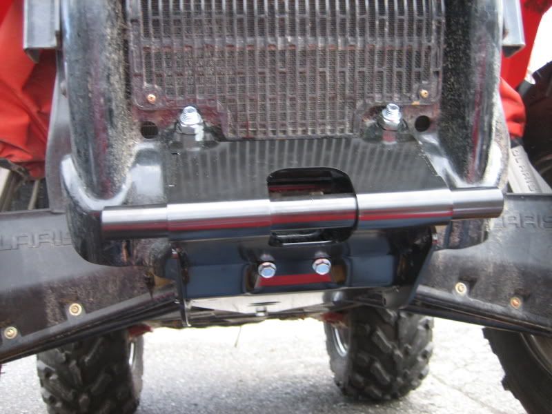

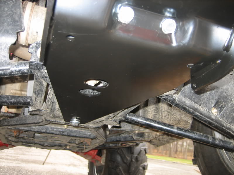

Skunksquasher- when I look at the mount that is attached to the frame of my quad, it is comprised of a bar and has a heavy steel that almost looks like a skid plate. This steel unit does go back to 1/3 of the quad and is attached to the frame at three different points with bolts. Does this sound like the g2 mount? The plow has reminants of the glacier sticker. I dont know if there is another Glacier plow that has the quick disconnect. I guess I will know if the promark mounts up with it when I try to mount it.
Old Nov 11, 2010 | 09:09 AM
  #43
x2 bum's Avatar
Joined: Jul 2010
Posts: 60
found some pictures.

I have owned 2 Glacier2 plow systems. My newer G2 has a thicker mounting plate than my previous one. My older one bent-up like a pretzel but my newer one held-up well last winter.
Maybe dealers (and more likely internet venders) are still stocked-up on the older, inferior systems. I don't know.
If you do a search here on our forum you will see many complaints and many topics about the G2. It's really too bad Polaris didn't try-out the product before sending it to market.
A local welding shop welded a reinforcement along the perimeter of the plate which solved the problem on my older G2 plow system.
If you want to clobber snowbanks and spin-around in circles, you'd better buy the old style Moose push-tube system! LOL!

That's certainly a much better looking mount than the original POS G2. Of course, PoPo used all the money from the suckers who bought the original G2's to develop and build a decent mount.
Glad you got the better of the two.
