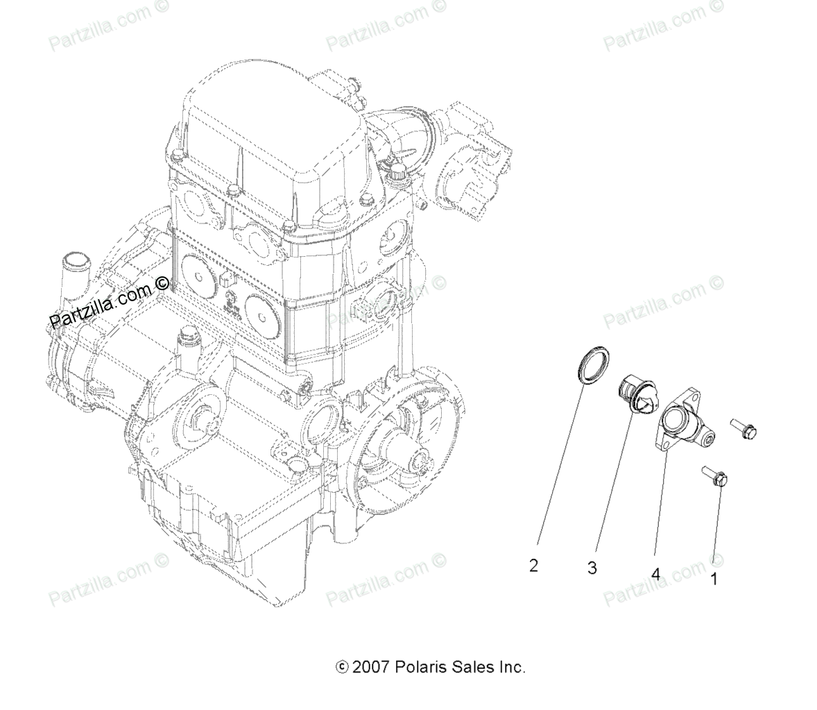

Thanks OPT. I will take the rad out tonight and give both real good cleans. While i have the system apart is there a way i can check the thermostats? And where are they located? Sorry new to Quads and don't really know where to start.
Old Nov 6, 2017 | 02:34 PM
  #35
When you drain and pull the radiators you can check the thermostats. Both are on the side of the engine. Should open in a cup of boiling water. The t-stat o-ring is also the housing seal and can be reused if not damaged.If you need to replace one,ebay or amazon has them for around 25 bucks. If you need manuals on these new to you machines,you can get a pdf service manual for 5 bucks.Polaris ATV Service Manuals PDF Download
