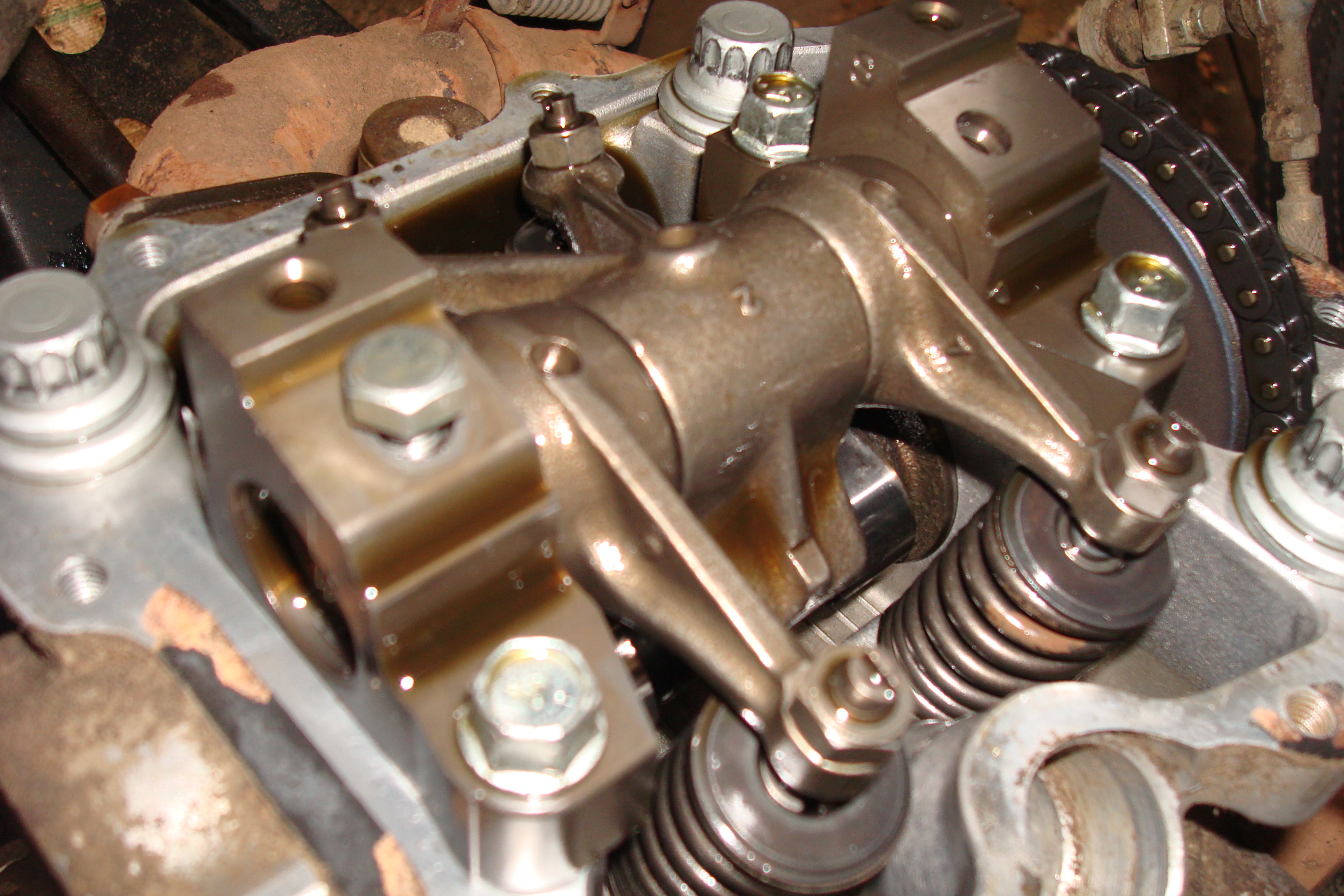

If you look close at the picture of the rocker arm assembly, you will see the little bolt that holds the rocker shaft in place, is loose, and ready to fall out. I found it like that, when I took the valve cover off to insect the cam.

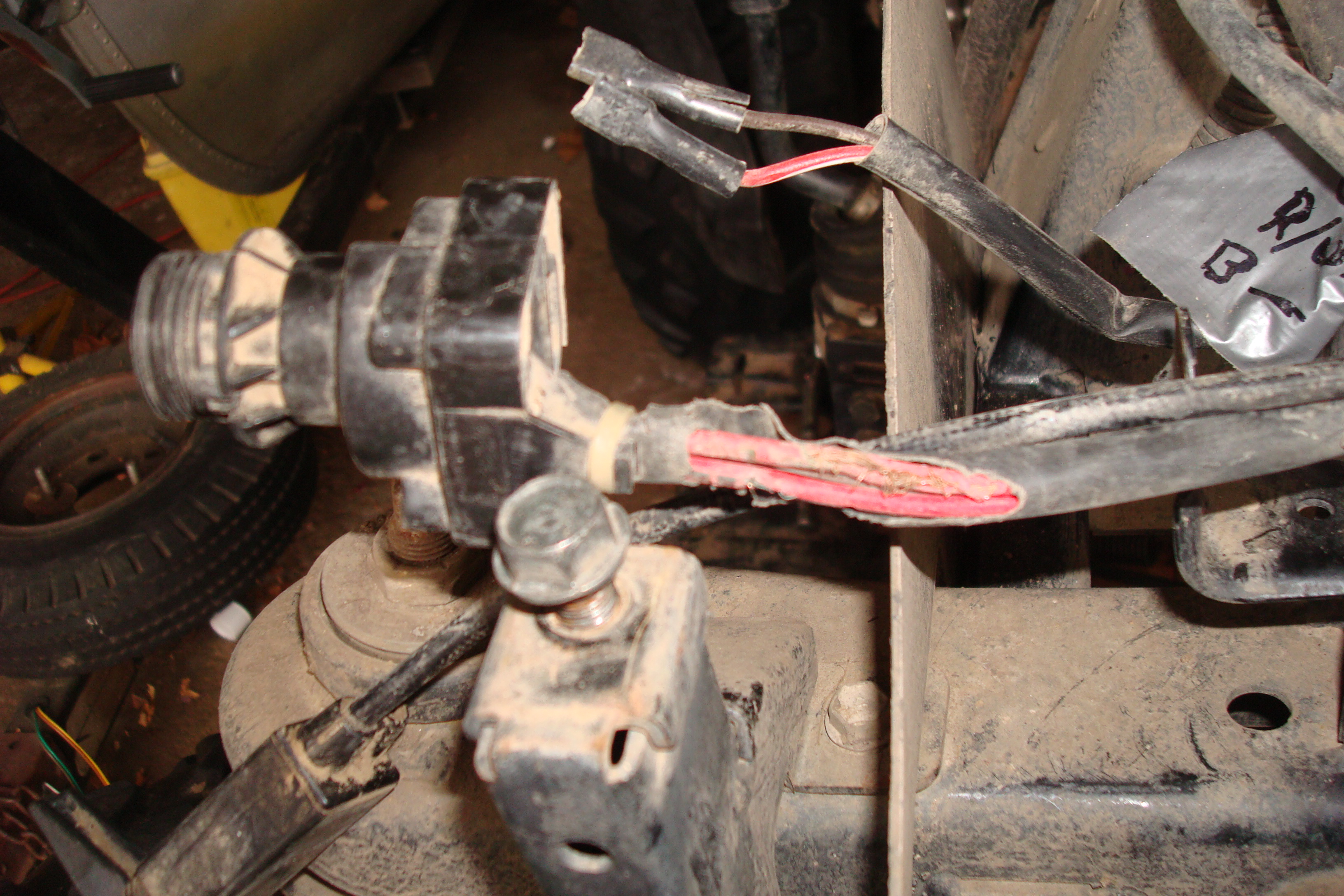

The starter switch harness is all chewed to hell by mice.

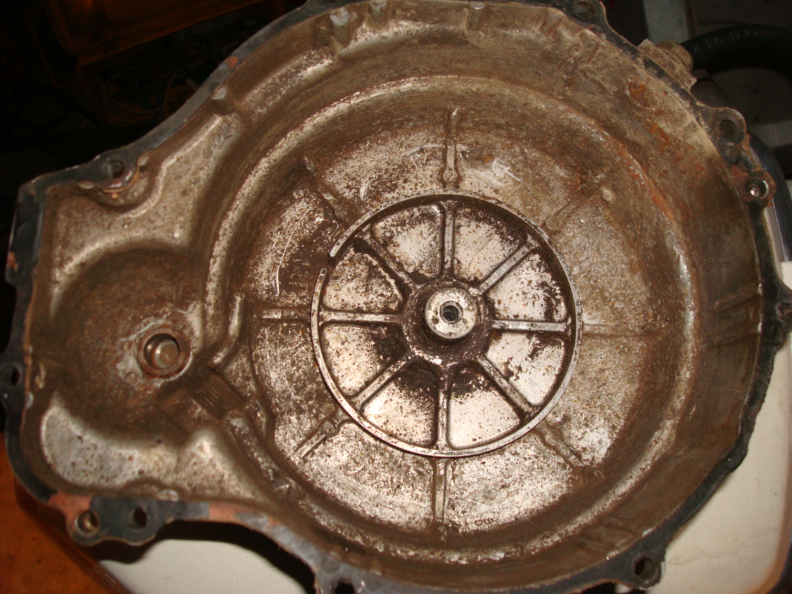

I took a picture of the recoil housing to show all the chips and cracks in it. They didnt show up though. It looks like the pull cord assembly exploded inside there and tore everything up. I pulled the flywheel and there was metal shavings all over the magnets and stator. Luckily the transmission and the rest of the Sportsman are in good shape (so far). I've got my work cut out for me on this one.
Sounds about like what happened an 01 Scrambler 500 4x4 I had a couple years ago. Pieces of the pull start came apart inside the housing and tore up the stator. I ended up just getting rid of it as the cost to fix it was almost as much as it was worth. There was something wrong with the transmission too when I shifted into reverse, it would clunk the whole time but it would still engage. I usually just avoided using reverse unless it was completely unavoidable. I just put it in neutral and pushed it. The engine still ran great though you couldn't start it. I ended up selling it not running for $250.

You can get aftermarket recoils fairly cheap now along with cheap Caltric stators if needed.Stator Fits Polaris 3086984 | eBay http://www.ebay.com/itm/like/181266412561?ul_noapp=true&chn=ps&lpid=82One thing about mice is that they're not prejudiced,they'll eat any wire no matter what color. They love that plastic..
The bolt on the left block is to lock the rocker shaft,keep it from moving side to side. Would gum up the works if it came loose and got lodged,but sounds like you have other problems to deal with also.
