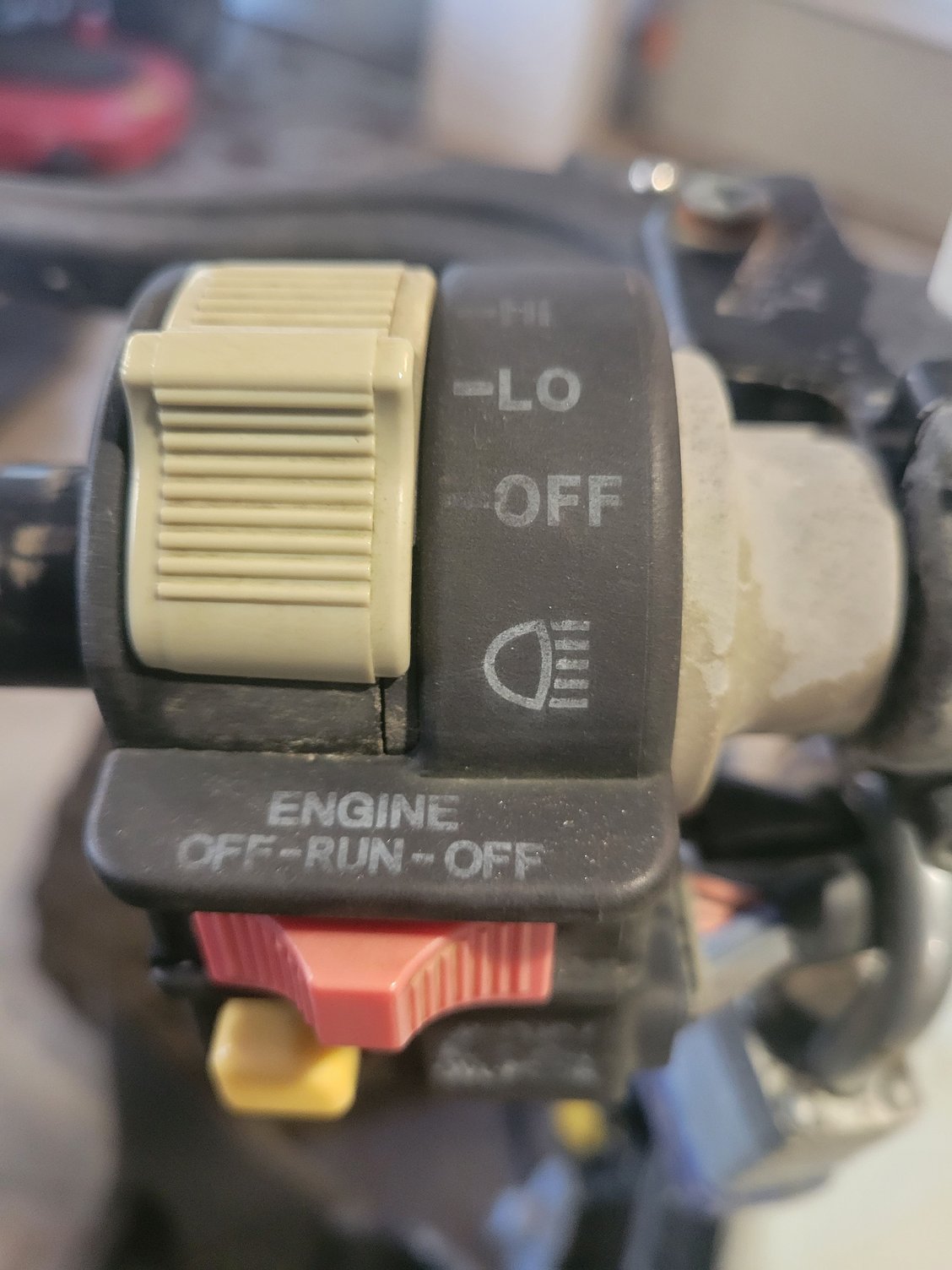

That is another great question! Maybe i can get some help with that as well. The letter for the year is Y in the VIN, I can't find a tag anywhere else on the quad that has the year/model. What year is Y? I am leaning 2000 as that was what seller told me but he didn't seem too confident.
Here is a pic of the starting switch. No green button. Seems similar to what I have read about on the sportsman where u push up the red button but that is not an option on this switch.

Y would indicate it is a 2000. Looking at the oem parts, it should be the push up type switch. In case yours is bad, not a bad price.
