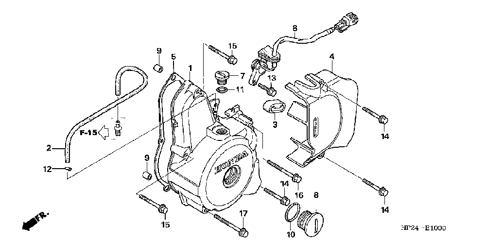

My trx90 is doing the same thing. Neutral light might come on might not. So I replaced it now it's doing the same thing. Could it be a loose wire or something else?
Old Sep 11, 2016 | 07:00 AM
You can get better help posting in the Honda section,but remove the connector and clean and see if that helps.Item#6 in the picture. Here's a free pdf manual that might come in use for this and other problems.http://www.mediafire.com/download/8y...ice+Manual.pdf
