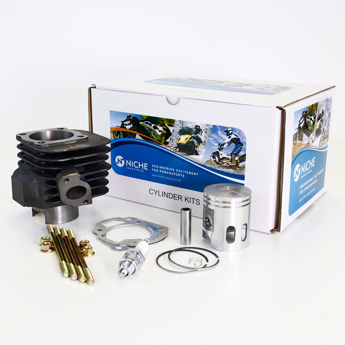

The niche top ends are a china top end with their stickers on them. They are all the same. 10-13 bucks each in volume on Alibaba.
After dealing with the china stuff, I think it's all junk, but it is affordable.
If you used the niche studs, this could be the problem. The studs are especially junk. I think they stretch.

As long as oem cylinders are 140 bucks by themselves people are gonna go gaga when they see those 35 buck kits. Really can't blame em as I'd probably give one a try myself just to see. 50/50 crap shoot on cheap Chinese electrical modules and engine top end kits as to getting one to work right,but the pics look so pretty..
