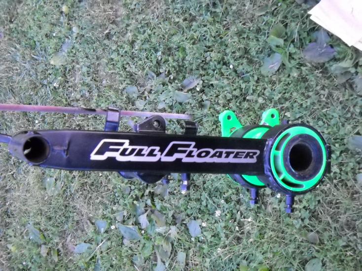

got new pics up in my album. the rolling chasis probly wont happen by Saturday. Got distracted riding a 250s that i might buy for $400.00 with no damage done to it. frames a lil bent but the engine is strong.
heres a pic of the swinger for the Mistress 2.0.

That looks sick! Is full floater the new name?
no its called Mistress 2.0. i just used some leftover vinyls and cut that out. i couldnt come up with a design for the neame that i liked. i tried using different letter styles just couldnt get it. it says full floater because the rear suspension fully floats now. i install needle bearings in everything, no more bushings in the shock.
if anyone has an 87 lt230s i have an extended swinger for that year only and it'll fit an 88 too. it came with one of my new parts quads. its about a 3 inch extension if anyone is interested.

gotcha. can that extended swinger be modded to fit an 85?
