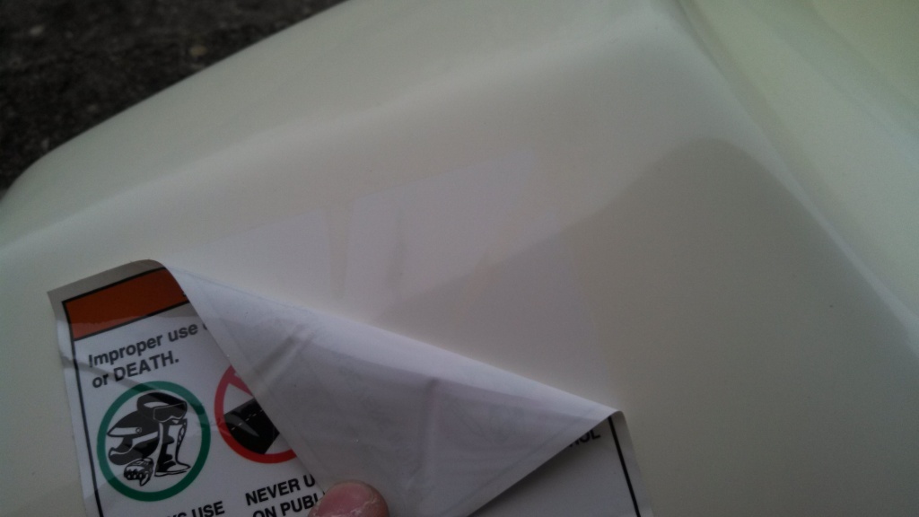

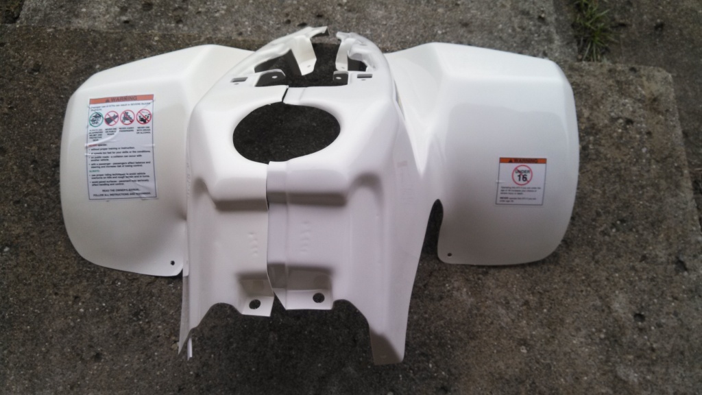

My Maier plastics came in today. The left side of the front is yellowed What a pain to have to return these. I ordered another set, hopefully it will be here by the middle of next week. And hopefully it looks alright. Gonna hold on to this set until the other ones come in, just in case the new ones have a yellowed right side
Is maier the only place to get the plastics from now?
I don't like the way the front plastics are split.
