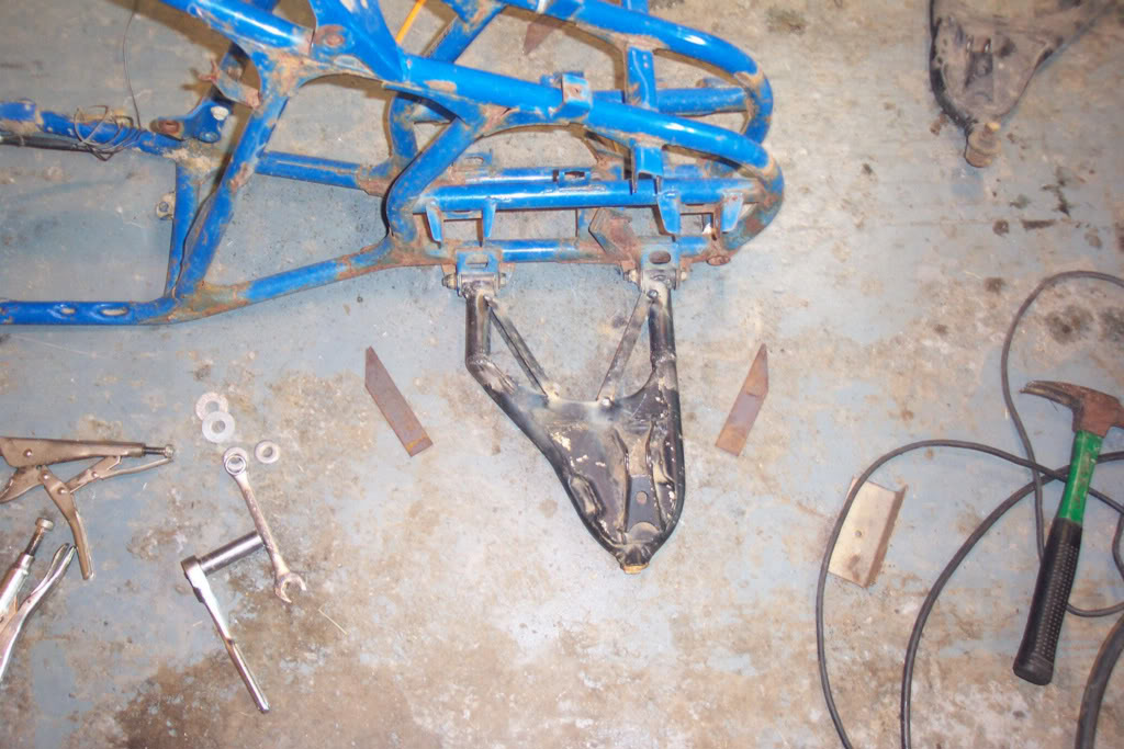

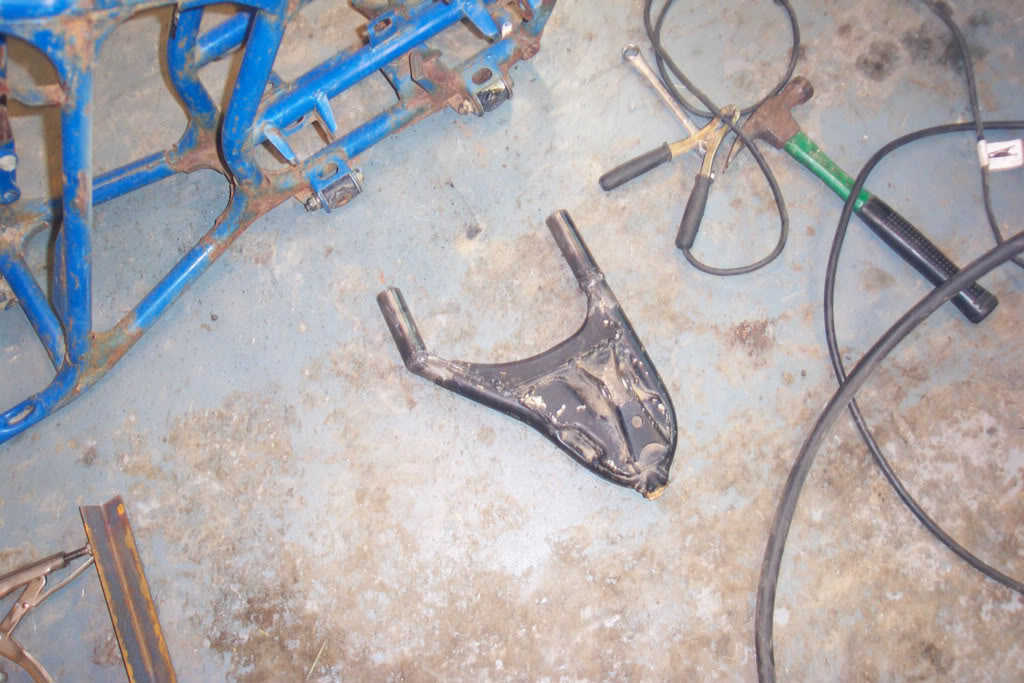

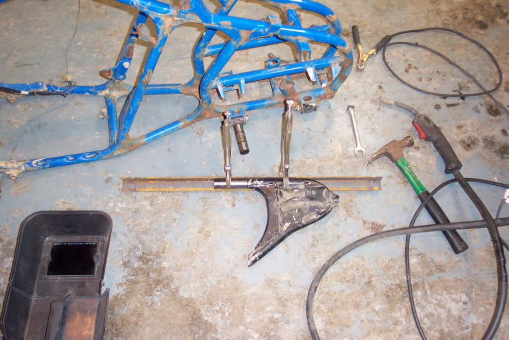

First, cut off the ends of the arms as straight as possible. I used a hack saw and lots of patience. Then I heat treated some Ford 460 wrist pins (what's stronger than that?). Then I clamped everything to the angle iron like in the pic and welded.

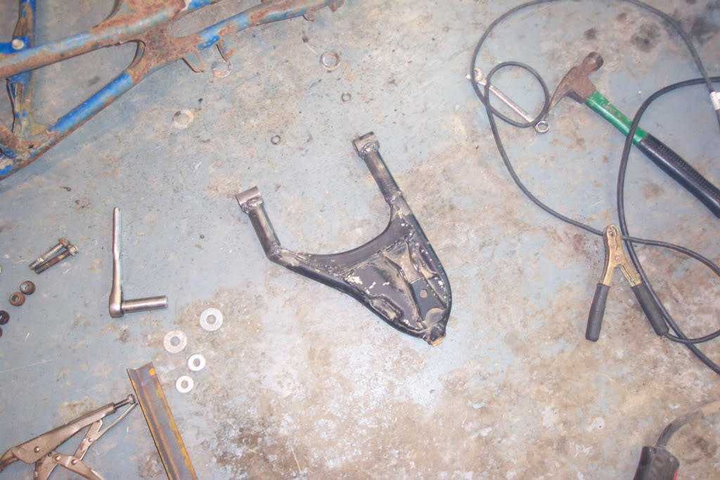

I forgot how I did the other one, apparently I didn't take a pic of it either. But it has to be straight somehow. I know in the end, I used a scissor jack to spread the ends to fit just perfect. A press can be used if you spread too far, but not everybody has a press. Maybe a car or truck is heavy enough, I don't know.

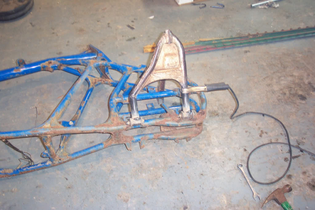

Then I sanded some washers down to fit the a-arm ends in the frame snuggly. Then I welded the arm to the ends.
Viola!

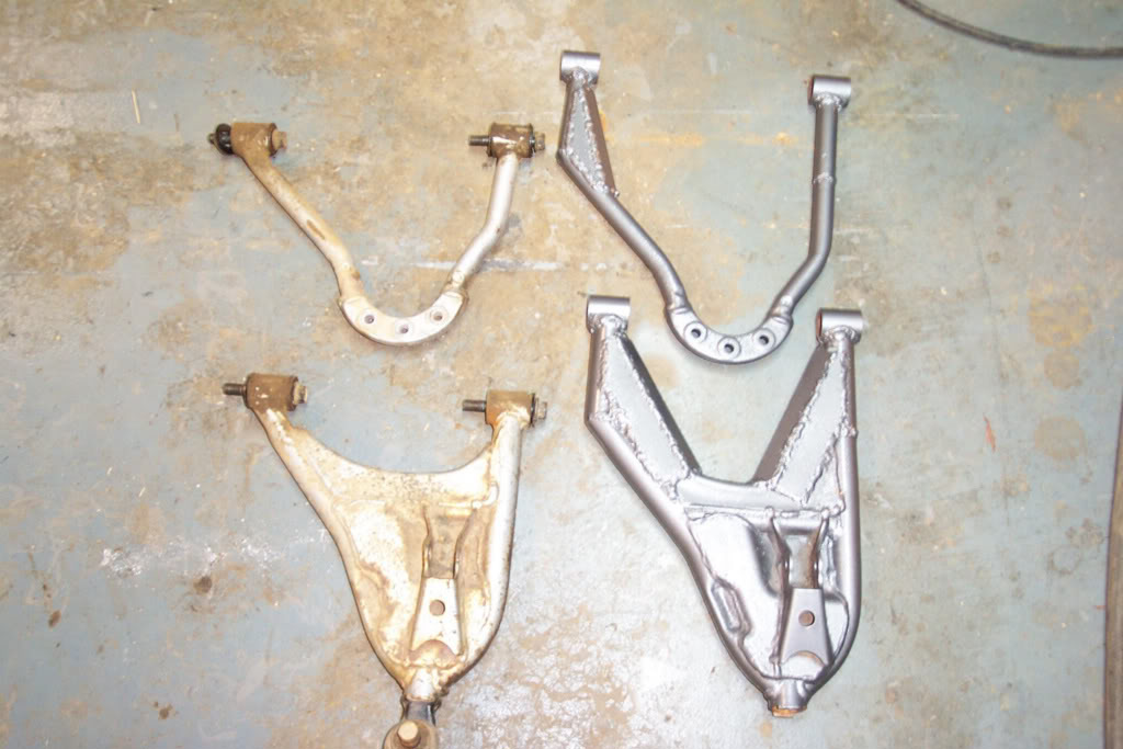

Remount it back and ready for welding the gussets. I used thin angle iron for the gussets and flatstock for gusset covers.
All painted up and looking pretty.

I wish it was really this easy. Keeping everything straight is the hard part. If one arm is more forward than the other, the quad won't track right and will pull to one side. A press and scissor jack can correct some welding distortion, but its best to be near perfect right after welding. Taking lots of time setting up and clamping is key to a good welding.
Btw, the 86 and 87 arms have different bearing styles. The 86 uses heim joints and the 87 needle bearings. They both will fit in the same frame though. Just so you know what you have when you order replacement bearings. You can't change bearing styles.... I've tried.
