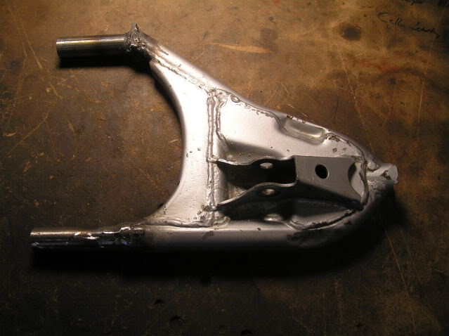

well, i didn't get that mojave, but i do have some good news. the 230 a-arm project is back in full-swing!
tonight i welded some of the first arm:
im still waiting on the nuts and heims.
sh!tty welds:
i decided to use my craptastic flux core welder and i guess ima hope for the best.
a little cleaned up
LOTS of bracing to come, ill keep u all updated.

Nice work man, looks good.
