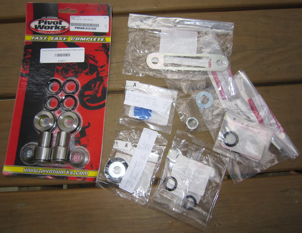

More parts came in today, all new swing arm bearings, seals & spacers. Also all new seals for the shock, cushion lever and arm. The missing swing arm bolt cap & axle carrier long washer were also in the order.

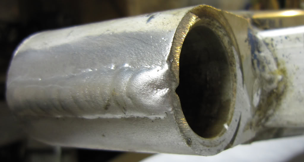

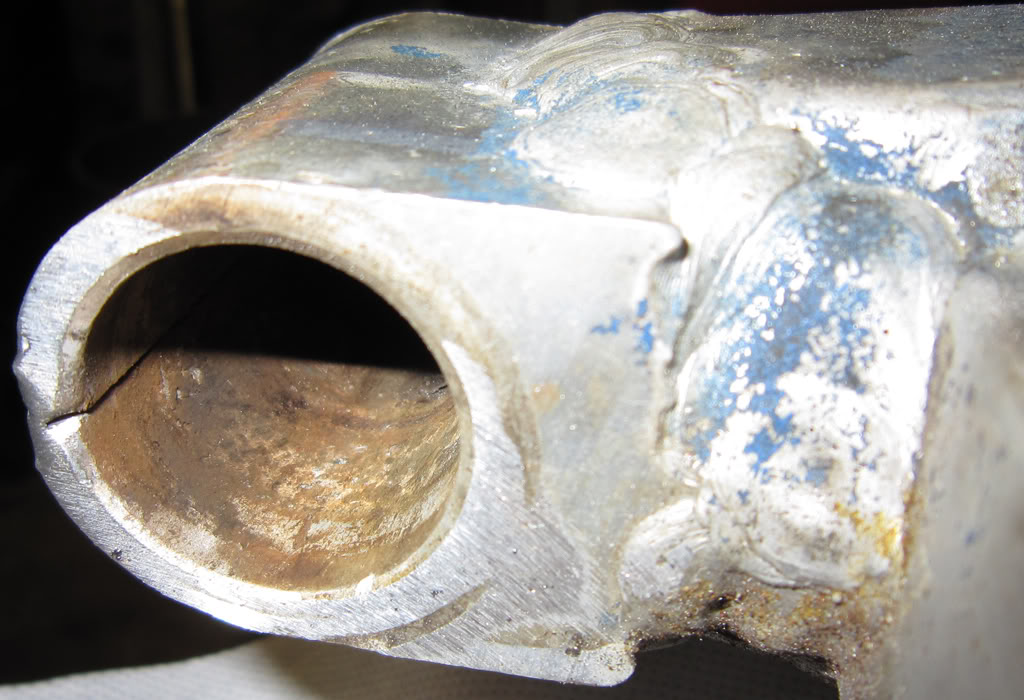

Yes I switched out both the drive and driven gears, pretty easy just need patience with those C-clips. I could have gone to the hardware store but I did not know the thread and exact style, I also did not know the width of the washer it was only 2 parts.
As for the welding, the bill came to $85 combined between the swinger and case half. Pretty nice looking weld extended all the way across to prevent future cracking.
The inside was not welded, the break was not even fully closed before welding I don't think but he said he used a clamp.

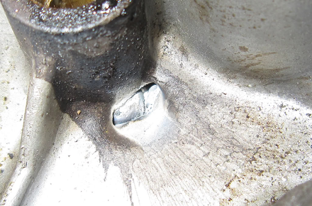

Here is the case half, will need to be grinded smoother with a dremel tool.

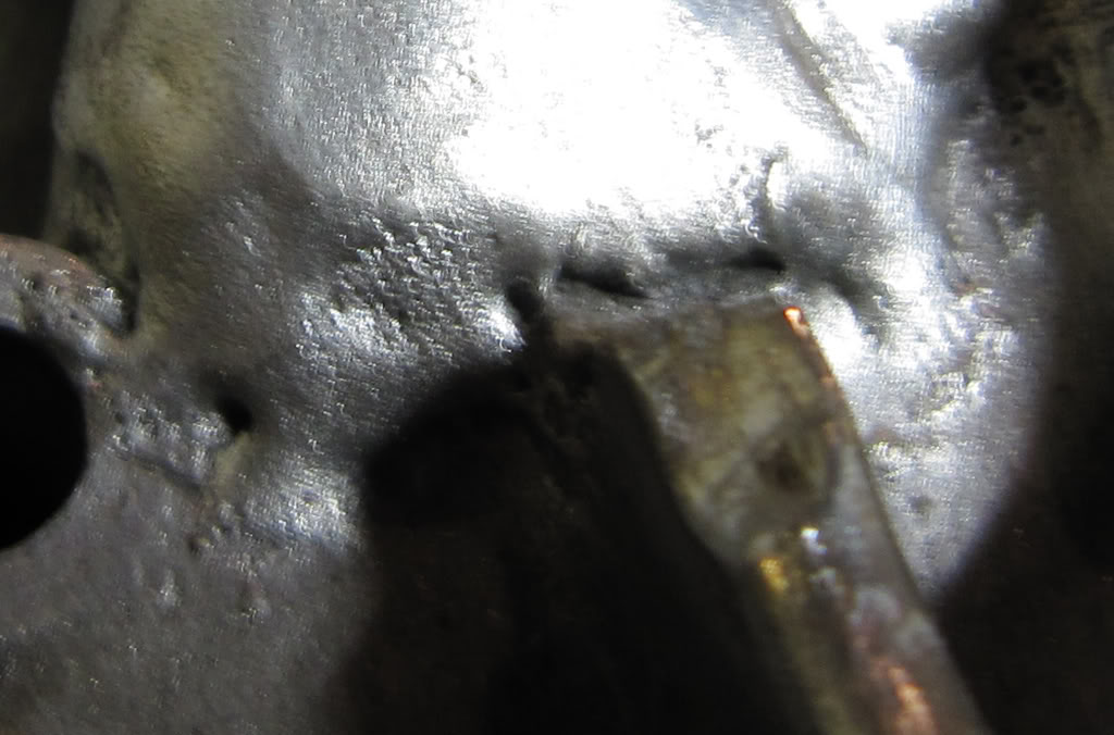

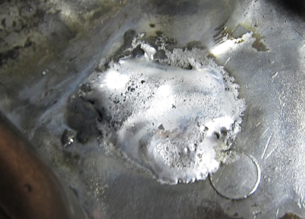

They are decent, I am worried about a few spots possibly leaking oil not sure.
Not sure why they stopped here:
The other one is a bit better, my grandfather thinks they "drip welded" this side.

That one hole I would take it back and have them weld that some more. If they are a good shop and value their name, they should fix those spots for free since they didn't really finish the job it looks like.
