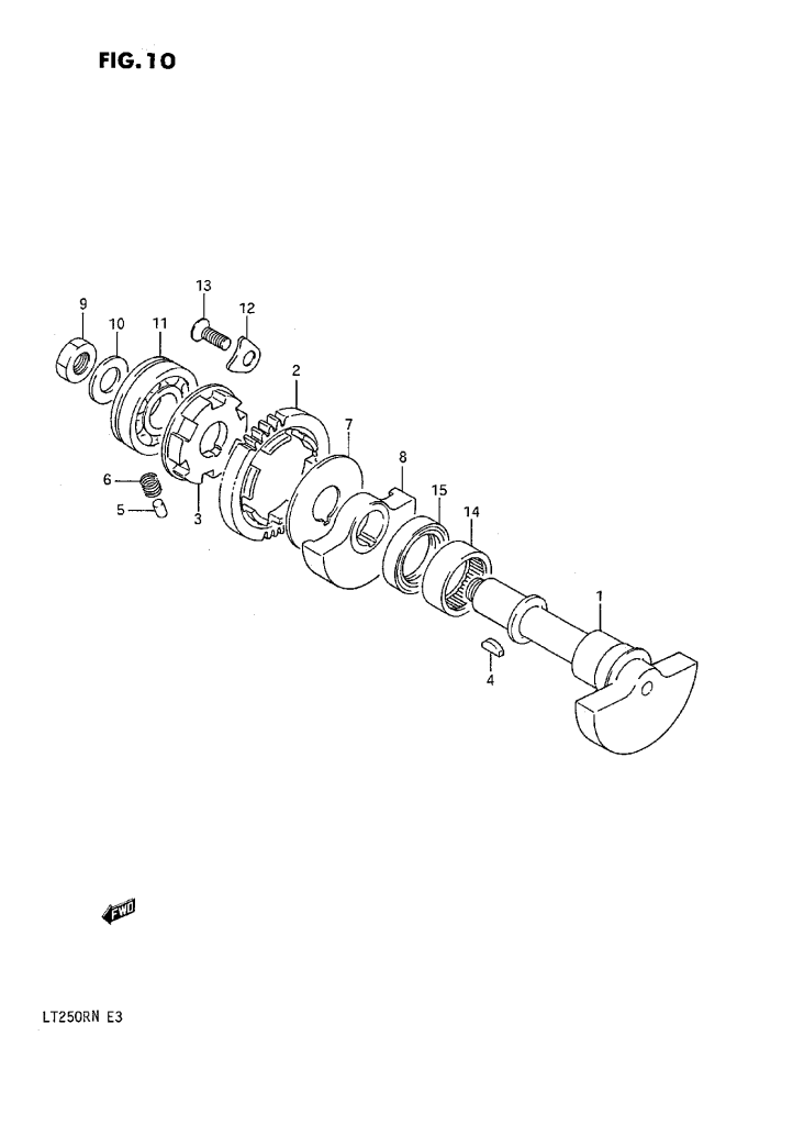

also, you know on page 6 where the nut spun off. When you replace it, I would first check and make sure that there is not supposed to be a bent washer on it. Because if there is, you put the washer on, then you torque the bolt down, and then you bend the washer on one side of the nut, to stop the nut from moving, thats how my crank works, I wouldn't use locktite on it, unless its your last resort.

As for the balancer driven gear, it has a torque rating 43-58 ft lbs. So anywhere in there should hold it (I will probably go 50-55) and the balancer drive gear is rated at 50-68 ft lbs.
According to this #10 has two parts on the list, #10 is out of production and just says washer, replacement 10A says washer, and replacement 10B says lock-washer. The Clymer does not say to thread-lock it so I will torque a lockie instead.

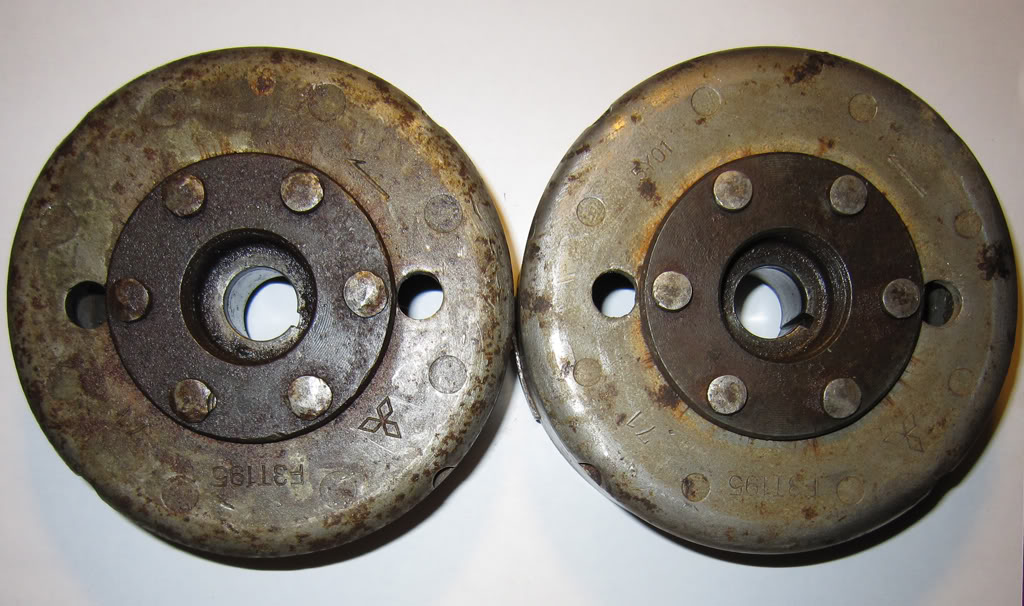

These are the flywheels side by side, the one on the left came off the running engine, the right is my spare. The rivets are a bit chewed up on the left one:
Also the rear of the one off the engine is all ground down and "dug out"
I think I should definitely swap them out, this is the only major chunk in the spare:
They both say F3T195 71, the only difference is one says 5Y01 and the other says 4X01

I would weigh them and see if there is a difference in weight. I think on the 250r, they need to be balanced on both sides of the crank right, so I would make sure to check the weight.

What? There is not a flywheel on both sides of the crank I'm not sure what you are talking about. But I will mention this to the guru at the shop when I visit and see what he has to think. If anything the new one will be heavier because it's not all scraped out and such.

Ok, I just looked into it for you. Looks like the flywheel itself needs to be balanced. Which I would assume means even amount of weight on both halves of the flywheel. I would go with the one on the right just because its in poort condition, but I would be worried about weight issues because the flywheel has holes drilled in it. I'm pretty sure when you have alot more weight on one side and less weight on the other side, it will create more vibration and probably less power. Its kind of like an xbox 360 controller vibrator. There is a "crank" and connected on one end of the "crank" is a "flywheel", but the flywheel is really heavy on one side and light on the other, this creates the rapid vibration you get in the controller when it spins. The vibration will increase as you increase rpm's. It might not do any damage internally, but it will probably vibrate more and you might see a little less power.
