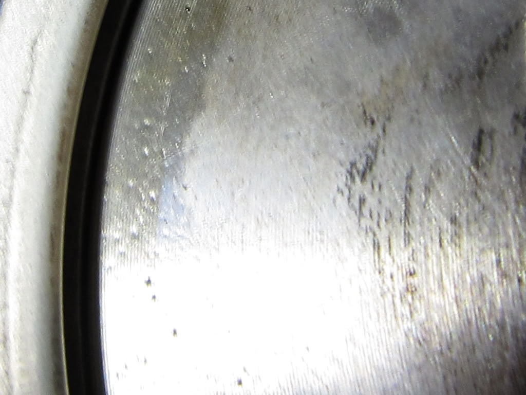

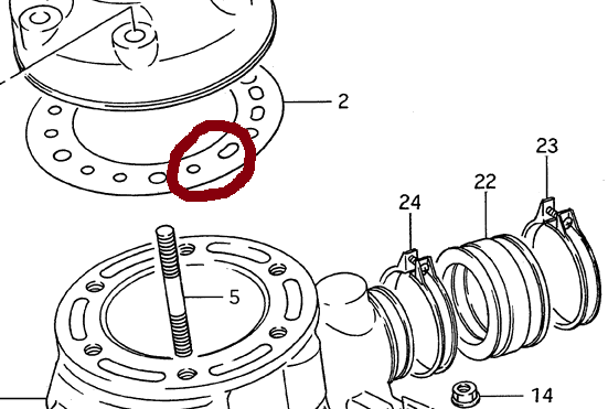

So I got the head gasket situation straightened out (I think) I read a handful of 1985/1986 250R head gasket threads on multiple sites all saying something different. I resorted to the microfiche showing the slotted and circular holes both together between two studs facing the flywheel side:

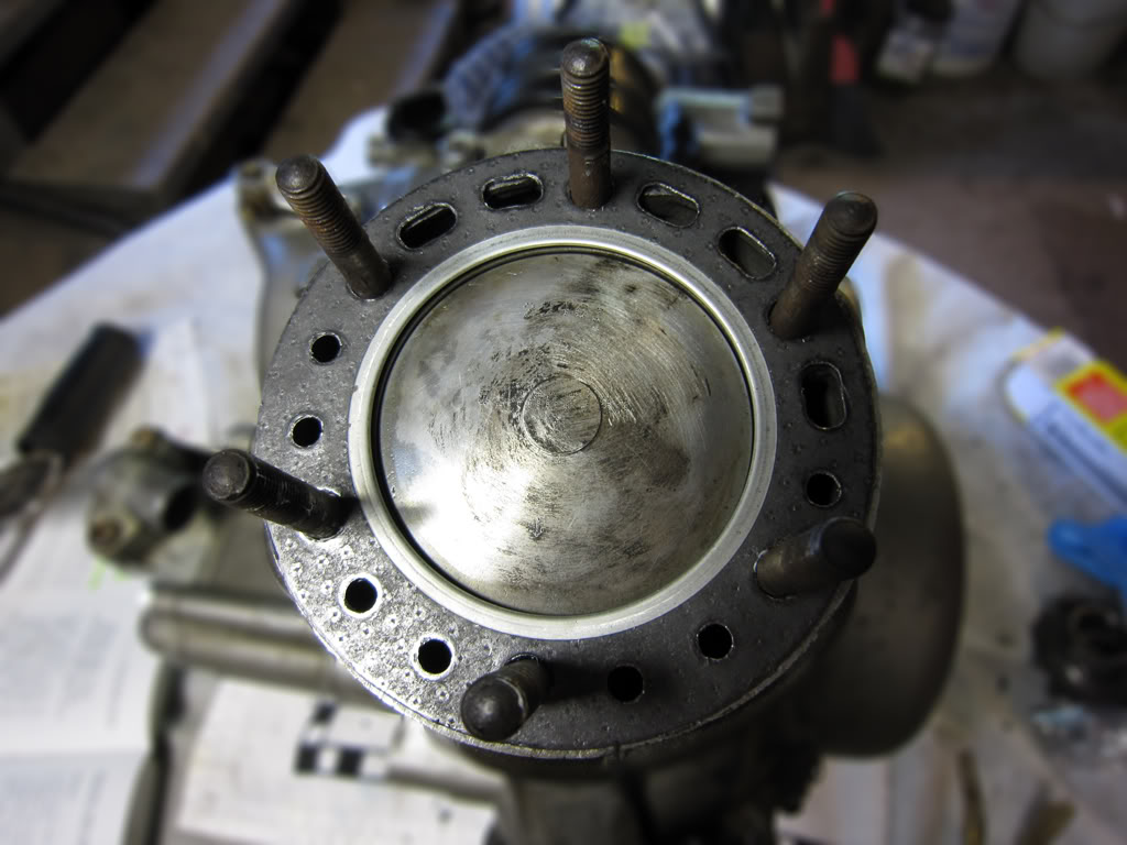

I applied a small amount of Three-Bond to both sides of the head gasket just around the bolt holes:

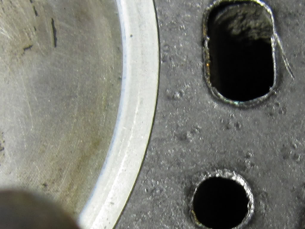

If you look at the image above you will see the gasket is pushed slightly to the left and there is no play in the bolt holes. It even effects the inside of the cylinder ever so slightly and it's not the angle of the photo I checked up close:

If you loc-tited them and torqued them, you should be ok as long as enough thread went through to keep the two items together. Also, about the gasket, does the piston hit the gasket? If the piston doesn't hit the gasket your ok, but if does, you gonna want to try and move it over a little because you don't want the piston to rip your gasket nor do you want the gasket to leeve marks in your piston.

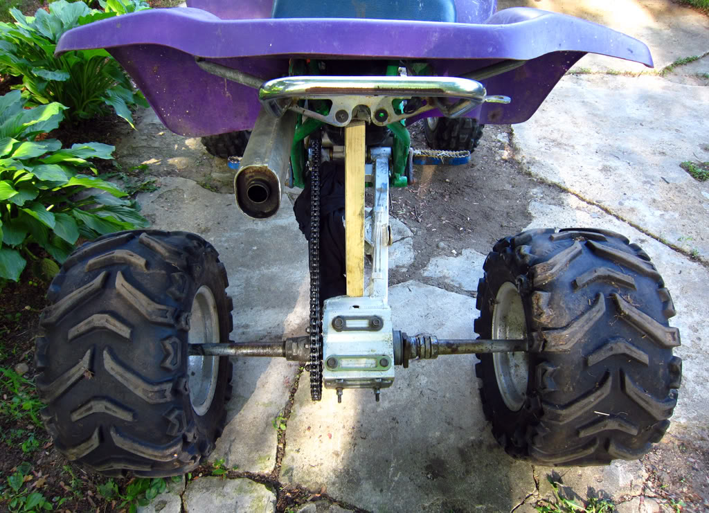

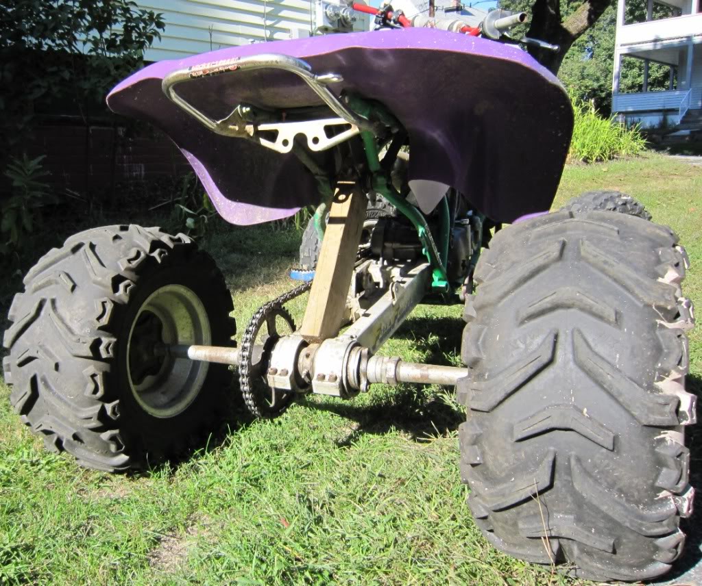

What a longgggg day, I spent 7 hours trying to make the damn shifter move plus get the engine all connected. What it came down to is pulling the clutch side apart down to the shift fork...which needed to be removed along with the ratchet mechanism inside the shift drum. Somehow one of the two spring wings was jammed which concerns me because how did this happen and what if it happens while I'm riding. All seems good, requires a lot of rocking to change gears sitting in place. Even though it looks like a roach it's really coming together this year, many new chassis bearings and seals but needs some paint. I kicked her over today and she started right up (minus the prime kicks with a dry carb) I think there is more compression with the new rings and hone because the vapors and smoke really shoot far now from the exhaust. Idling for a few min gets the cylinder, top of radiator, and water pump cover are all very very hot to the touch I would assume the pump is working correctly because the radiator and pump cover are both just as hot as the cylinder, normal?
I still have some work to do in the rear including rebuilding the shock, the 2x4 works for now haha I love my new 89' swinger! I have the rear disc brake stuff now too...but that is the least of my worries
