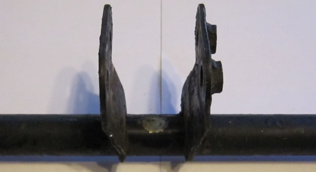

I straightened out the bent fender bracket I bought off ebay, came out decent, now I just have to bolt it on after I get the plastics back on.
