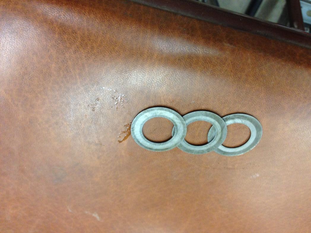

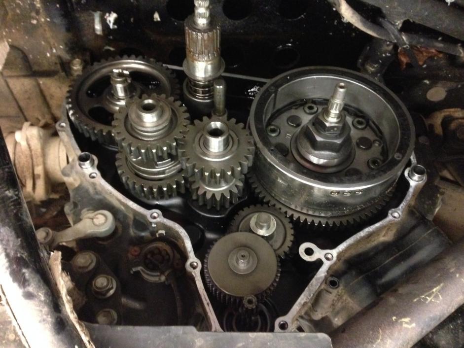

Finally got to install the stator in this today. In doing so, when I removed the stator housing three thrust washers "appeared" at the bottom of the case when removed from the engine. I have searched the service manual to see if they are all located in a stack together ( as they were, neatly so) when I pulled the cover, or did that happen by chance and they go elsewhere. The parts and service manuals are of little help. I am attaching pics...any suggestions?
Thanks!

Maybe look at a parts fiche at a online dealer.

  #14
pennsdalerepairshop's Avatar
Joined: Sep 2009
Posts: 40
LT80:
Did that; about as clear as mud. Planning on doing more research tomorrow...
