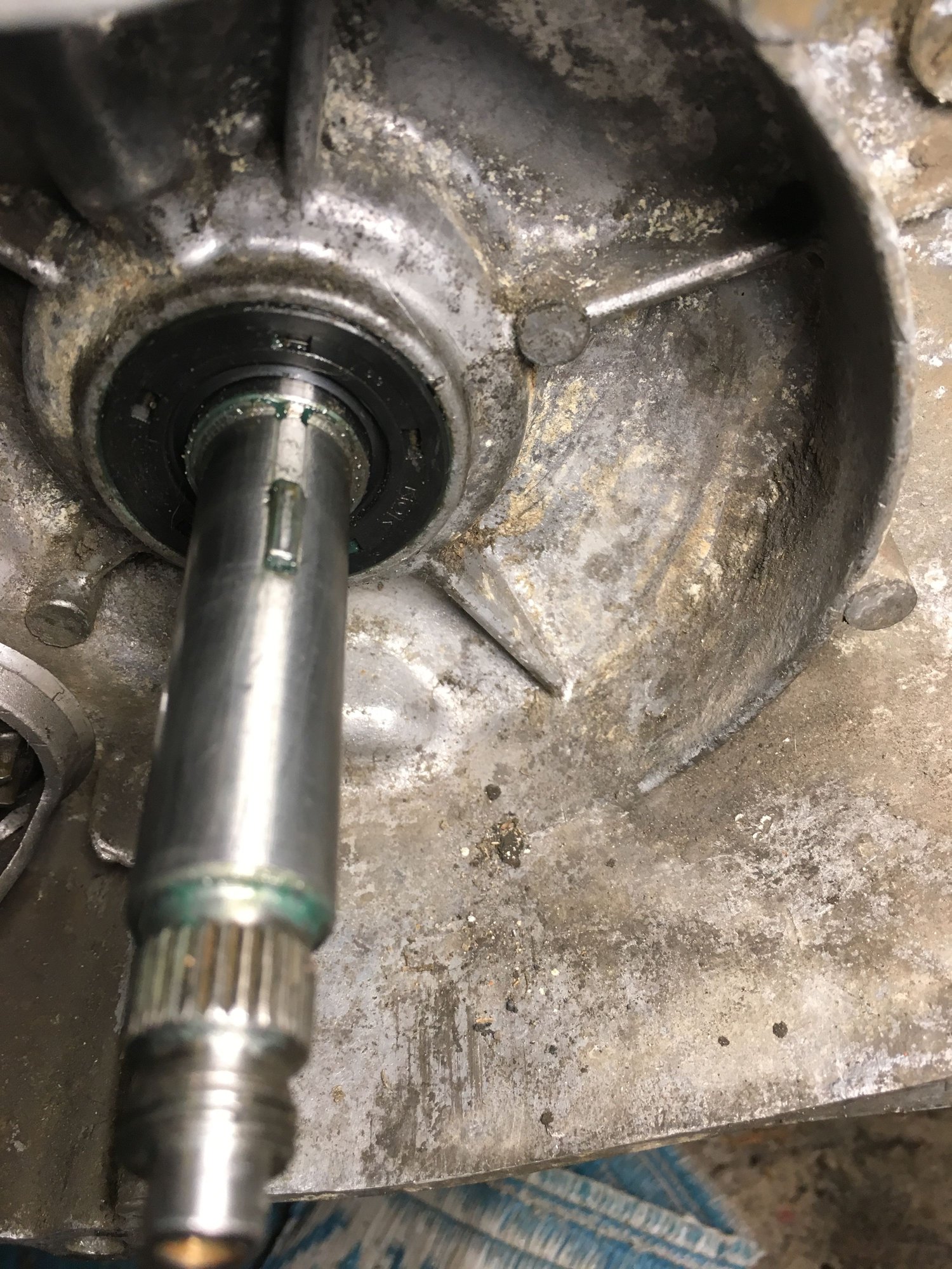

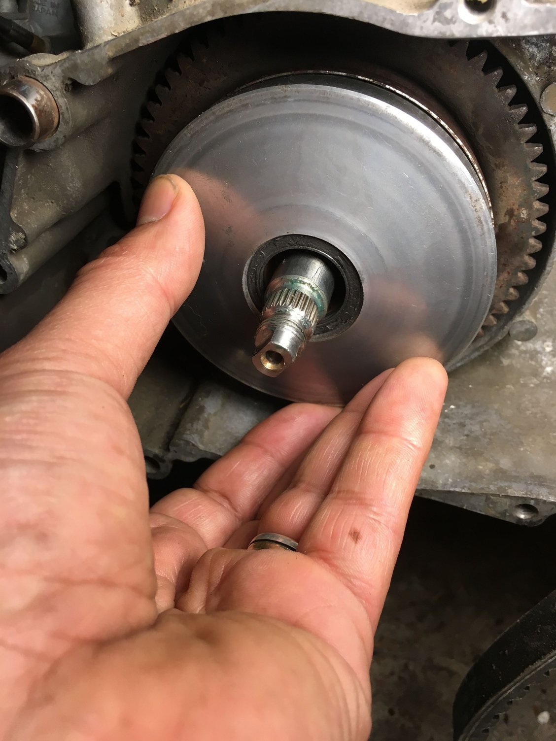

Hey LT, and all you other helpful and learned folks.
I am reassembling the front clutch. And have gone through the past threads on the topic but still am not convinced this assembly is properly set.
My issue is I can’t belieb be the little amount of key that is contacting the front clutch face to apply all that torque when the bike is under load !
Also the belt bushing seems to be pushed in to far making the washer run directly on the belt. Which I’ve seen others post about before.
I almost feel as tho the crank shaft needs to be shifted towards the clutch side ! (Prob not the case tho as it is set in place.) or the flywheel is not setting back far enough maybe
take a look at these pics and let me know your thoughts.
heres Crank and key...looks fine to me
Crank and key
add flywheel, looks like key is barely enough to grab clutch face to me. It still does mind you but ...
Flywheel added
showing clutch face
Front clutch face
added clutch to crankshaft and all ok except shy key
Clutch on crank shaft
slide bushing onto crankshaft through front clutch ...still seems ok
Bushing added
add washer and now things get sketchy. not enough room for belt on bushing.
Washer post bushing
Belt riding on top of washer (belt I removed had groove in it from washer)
fully assembled . I believe that the whole assembly needs to shift towards crankcase.
Assembly complete but ...
Just thought Id ask since seems like lots of people have knowledge to share.
thanks in advance for you time folks.
cheers,
T
