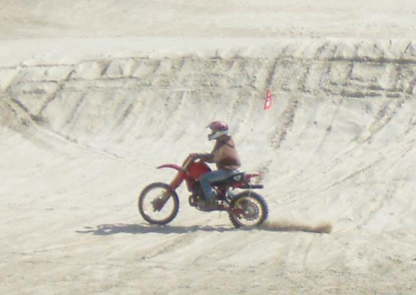

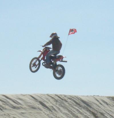

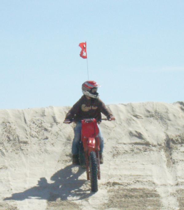

Finally had the Maico out to Knolls this last weekend and it ran better at 4000 ft vs 6000 ft. I agree that it could still go 1 step leaner on the main, the plug was mostly black, with a little dark brown on it. One step ought to do it.
However, it is still a runner. Here are some pics of the bike in action.
No, this is not me, it is a German exchange student who lives with me, he LOVES the Maico, and oddly enough, he had never heard of them before. He rides a bullet bike in Germany, but is restricted to a 125cc machine until he is older.
