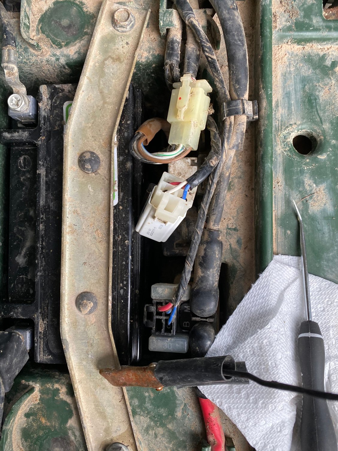

Looks like the white wire is the wire that the temp sensor must be grounding out. If I ground it the fan comes on. So I should be able to put a switch inline with that and be good to go.

I don't have a diagram, but thanks for the word of caution. I could just put a switch between the two wires going to the sensor, seems like the safest bet.

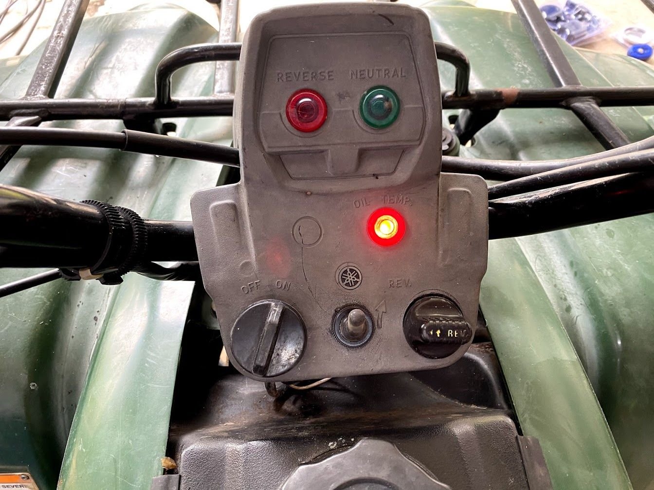

So I just tapped into each of the two wires off the temp sensor and ran them up to a switch on the dash, works like a charm.
The bare ends went to the switch.
Oil temp light comes on when switch is turned on.
