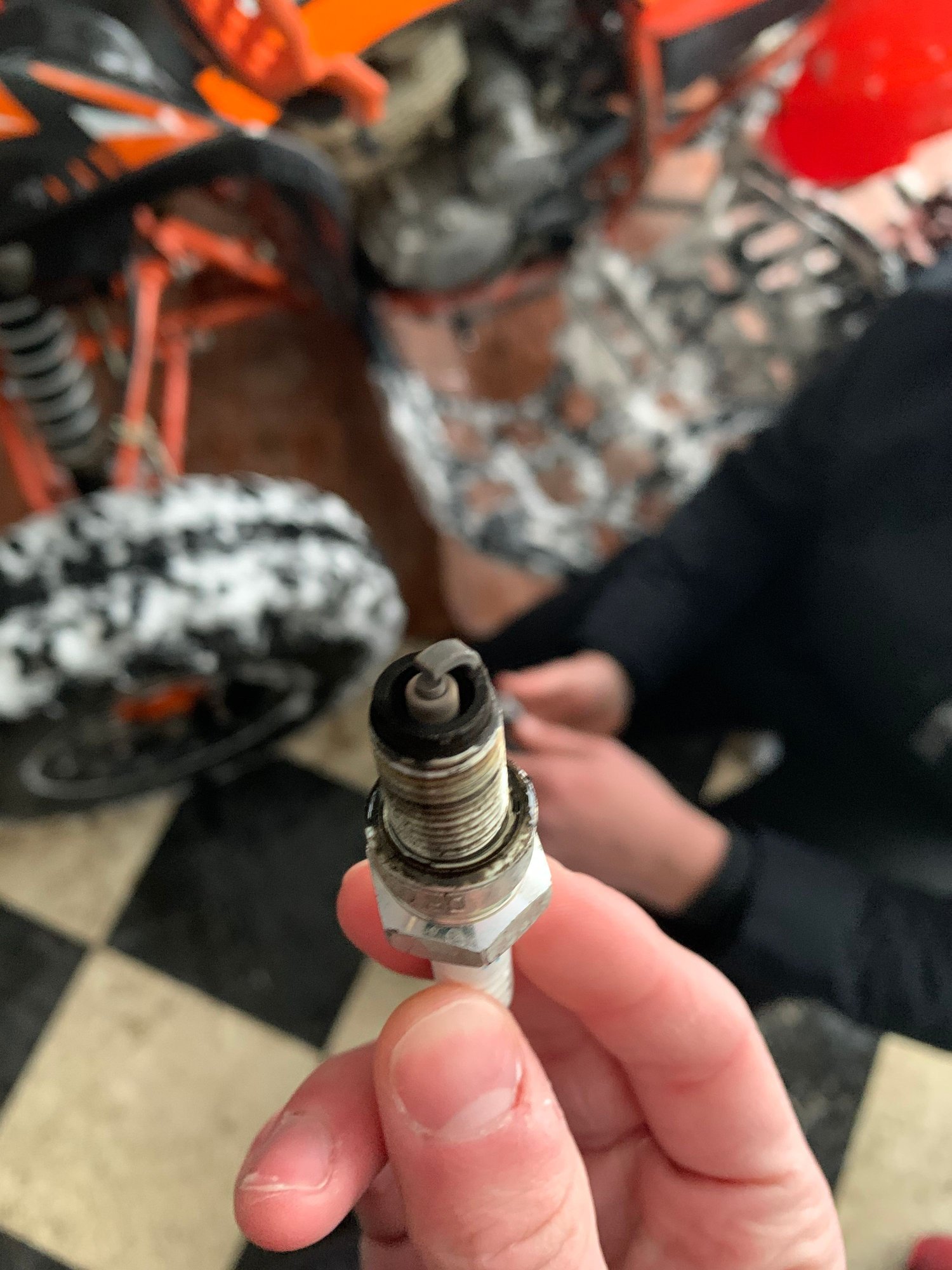

Heres what the spark plug looks like. Does it looks lean, rich, or normal?

Hard to see from your pic, tip looks light gray but around the thread looks black, is that black an oily residue? For most accurate plug reading.....go for a short ride, run it fairly hard and shut off the engine while cruising down the road, pull plug and read it without the engine comming down on idle. It is the running color you need, not the idle color.

This was pulled after I rode around for a while

Looks slightly lean to me, not seriously, or threaded part would be white, but it certainly isn't on the rich side or the porcelain would be black, very light brown is spot on, but that looks a bit too white.
