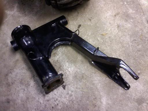

Nice pics, that would be great if the Yamaha parts fit right in there. Where do think the water came from? Riding it and it leaked in or was it in there from sitting on some boat or something for a couple years??
Hey also in that swing arm housing , did they use bearings with a seal on the end or did they cheap out and use bushings or something? The pivot point where hooks up to the frame.
#74
I am assuming that the boot had a slight crack in it right from the beginning and everytime I went through water or some mud it was making it's way to the seal which eventually get enough dirt and water in it to cause it to leak and take in more water. The rubber they use to make the boot is very cheap. I was able to make it crack in areas just messing with it in my hands. The swing arm housing has bushings that kind of look like a giant magnetic oil drain plug on each side. They thread into each side using an alan head wrench then a lock nut goes over them to secure them in. I'm going to head to the dealer in a bit and order up these parts. Pray they are the same..
