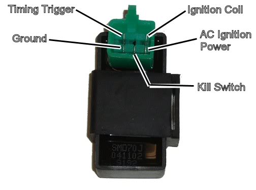

Is this your CDI?

Some of your colors are fairly standard so let's start with those:
Green: Ground
Blue/White: Timing Trigger
Red/Black: AC Ignition Power
The non-standard colors:
Blue/Yellow: I'm guessing this is the ignition coil output
Blue: I'm guessing this is the Kill switch.
Do you have a meter? We could do some ohms and voltage verifying with a meter to give a greater confidence factor....
Another to way to get a better confidence factor: Look at the ignition coil and note what color wires in the wiring harness connect up to it. Do you see a Blue/Yellow wire? If so then the Blue/Yellow wire wire at the CDI is certainly the ignition coil output wire.
Look at the wires coming out of the stator area on the engine. Is there a black/red wire and a blue/white wire in the wiring harness at this location? If so that nails the timing trigger and the ignition power wires.
Are your other ground wires connecting to engine/frame ground via lugs and bolts also green? If so that nails down the color for ground...

All the five pin CDI's as shown in the previous picture are the same.
