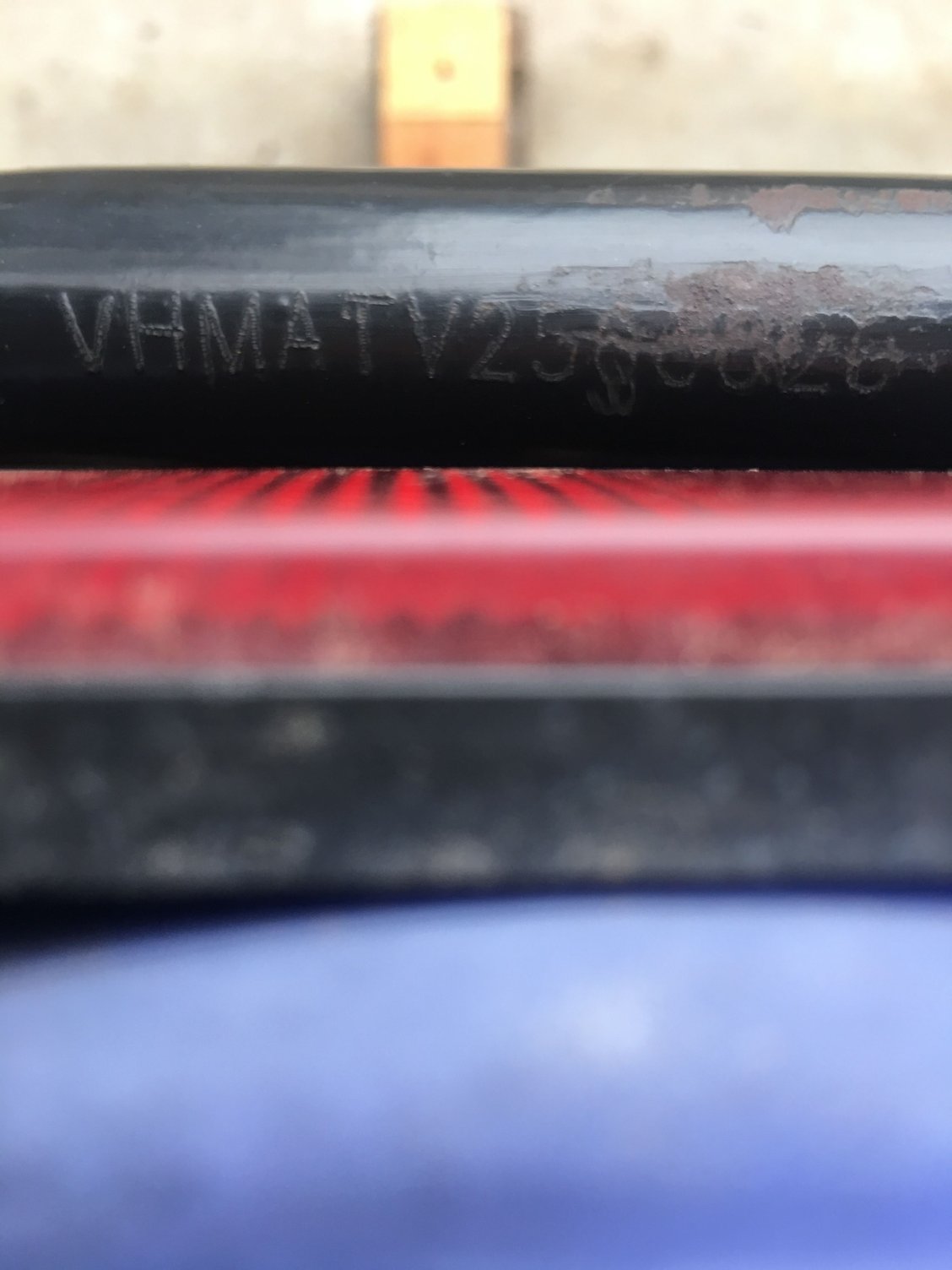

Old Apr 15, 2019 | 06:12 AM
Pollardd's Avatar
Joined: Mar 2019
Posts: 12
I found a number on the frame if this provides any more clues.
its on the back right near the tail light.
I can make out VHMATV25 - - - 2 6
Every thing else is starting to look like a 6
Anyone know anything about how to decode this number?
